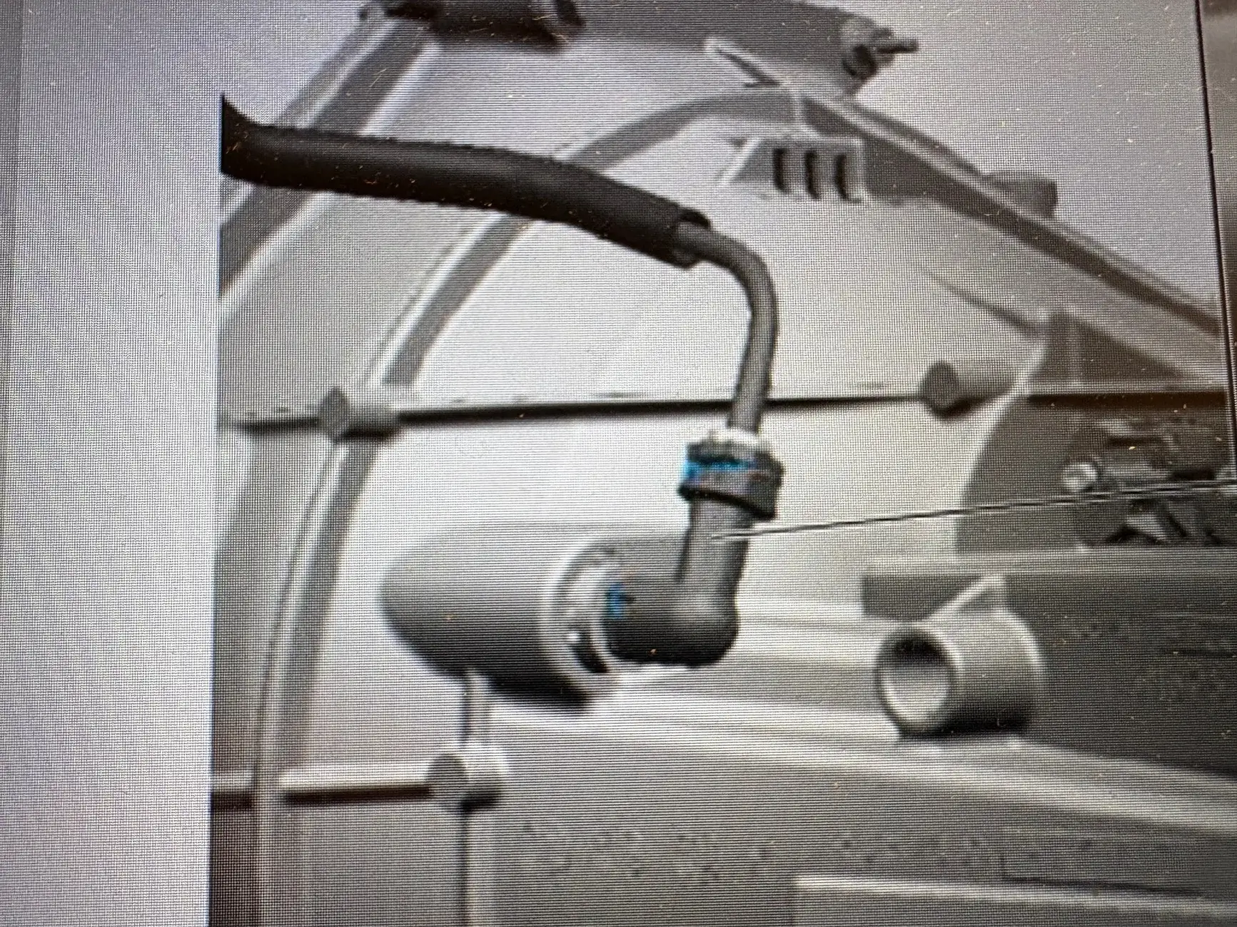

Any idea how the " peak torque limiting" orifice in the Ford elbow fitting influences clutch engagement and release during track sessions? I'm in the process of separating the clutch master cylinder reservoir and upgrading the clutch lines on my Mach 1 and I don't think Mcleod's elbow fitting has the restrictor?

I reckon this is similar to the clutch delay valve on BMWs that slows the release of fluid and therefore clutch re-engagement. I noticed the clutch engages a lot quicker now but couldn’t tell whether that was from the McLeod line upgrade (which removes the restrictor) so you have to be a lot more mindful when shifting lazily if that makes sense.
The McLeod line did not have the restrictor on it.
With that being removed + the RXT being unsprung you have to be more mindful in order to get a smooth shift, but the engagement/disengagement of the clutch is noticeably quicker, especially when doing a launch or clutch kick. Can definitely shift faster too, but we know the TR3160 rewards smoothness over banging gears
