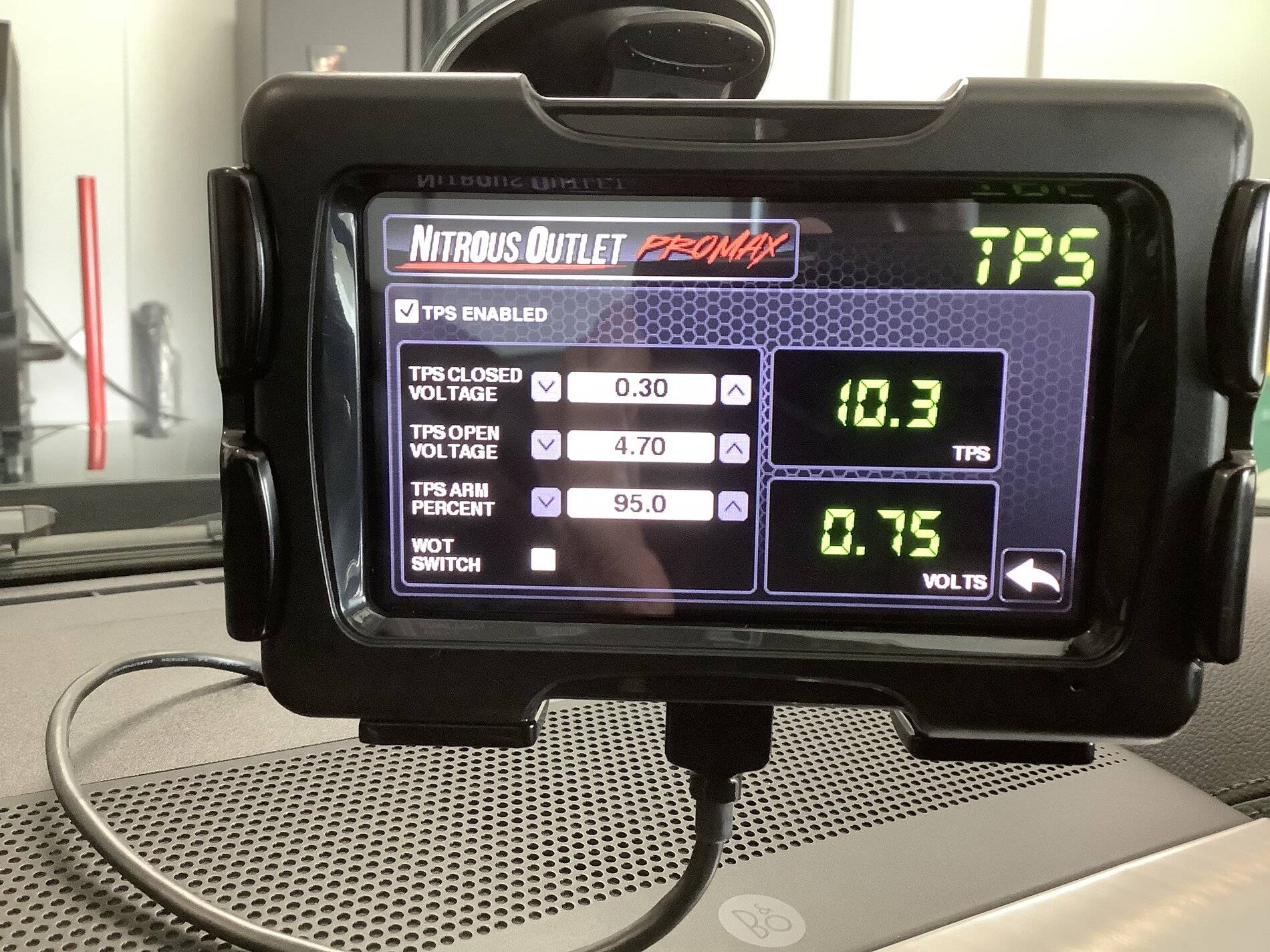

Can someone do a quick scan and let me know what your TPS1 and 2 voltage is at idle?? 2015 GT here

I don’t know whether this will be of help to you or not, but I have a 2019 Bullitt and here is a snapshot of my nitrous controller showing tps voltage at idle.

I think so! I'm only getting around .56 volts at idle. Trying to diagnosis a possible throttle body issue at tip in. Thank you!

I didn’t think about this at first, but I can shoot a video with the engine off and track tps voltage while pressing the accelerator pedal if you think that would be even more helpful?

Yes! Can you possibly get the voltage at key on engine off? I'm trying to diagnosis so issues with my throttle body. I think it's on it's way out. I get .85 at koeo and when I start it I get .55 at idle. My f150 shows 1.19 at koeo and drops down to .85 at idle. Again, thank you!

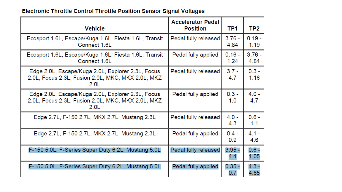

I found some info in the 2016 MY service manual for the typical TPS signal voltages. See below.
Hopefully this is helpful

Exactly what I was looking for! Thank you! I have a subscription to alldata but couldn't find anything. Is this a different manual?

No problem. This is from a factory service manual I got off of eBay.
