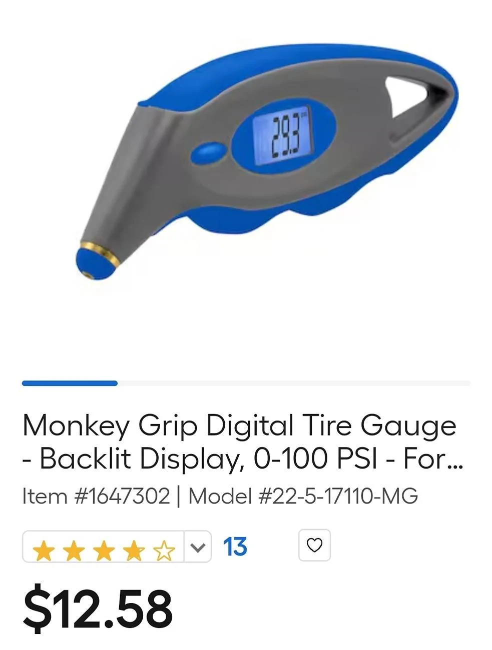

I've liked this digital gauge I picked up from Lowe's. It has a silicone dome tip that seals a lot more easily and from multiple angles.
It has been within a couple PSI of the TPMS up or down 1psi due to rounding as mentioned previously.
