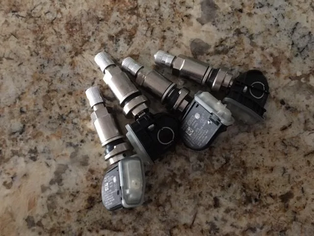

I got the OEM ones from Rock Auto listed for the GT350 and they work fine. Took about 10 min of driving for them to register, no tone tool needed.

.........dealer looked this up with my VIN and said I need 433 Mhz.
All this 433 vs 315 might be a marketing gimmick.....
No gimmick. If the receiver is set at 433 MHz, it will only work with 433 MHz sensors (unless the receiver is dual/multi freq)
How do you know what you have? I have a 2017 R.
Edit: answering my own question in part, LMR site says this:
***TPMS Sensor Note***
The sensors included with this kit are Ford Motorcraft TPMS39 sensors, which are a direct fit for GT350. Most GT350R models require the use of TPMS45 sensors, however there are some GT350R Mustangs that use TPMS39. You MUST check your VIN number, and confirm with your local dealer, before ordering to verify which sensor you need. If your Shelby requires TPMS45 sensors, please contact customer service prior to ordering to ensure the correct sensors are installed in your R350 wheels. No training tool is required as the sensors automatically sync to your car.

Tire rack has that part for $36 - 315mhz but I am going to check part number via VIN with Ford dealer since there seems to be no way to know for sure what works otherwise. Happy to be corrected about this.
