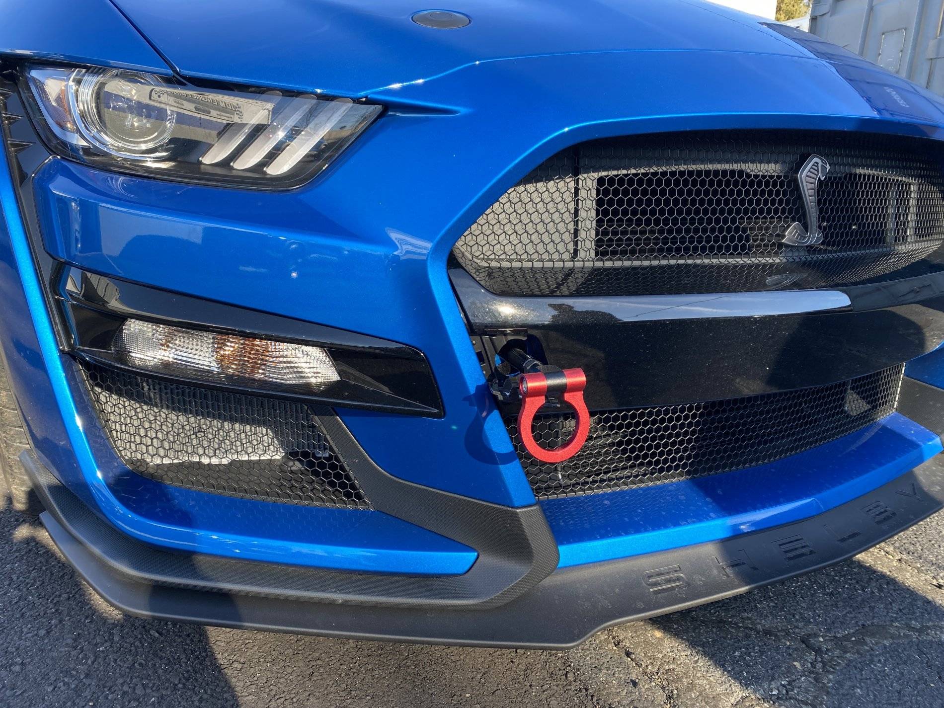

It is likely the same beam used on the 2020 GT350 as well. Both use an extruded bumper beam, unlike the rest of the Mustang lineup, which uses a steel beam. I doubt they'd have a separate part number for GT350's now and likely use the same part but it just isn't uncovered or used on that car.

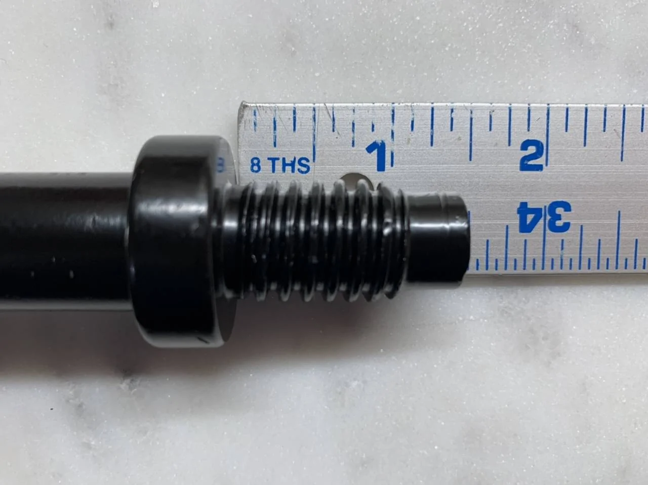

Does anyone have any idea what the threads are? Size, Pitch, Length. I would really like to know for an external license plate mount.
It’s left hand thread. The smaller part of the shaft (unthreaded) is 1/2” diameter
the threaded section is 1” long and has 7 threads. the threaded section is 3/4” diameter.
hope this helps.
hope this helps.

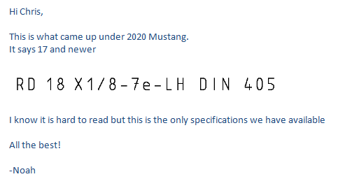

Here is the Info. that I got from Noah.
It is a Knuckle Thread.

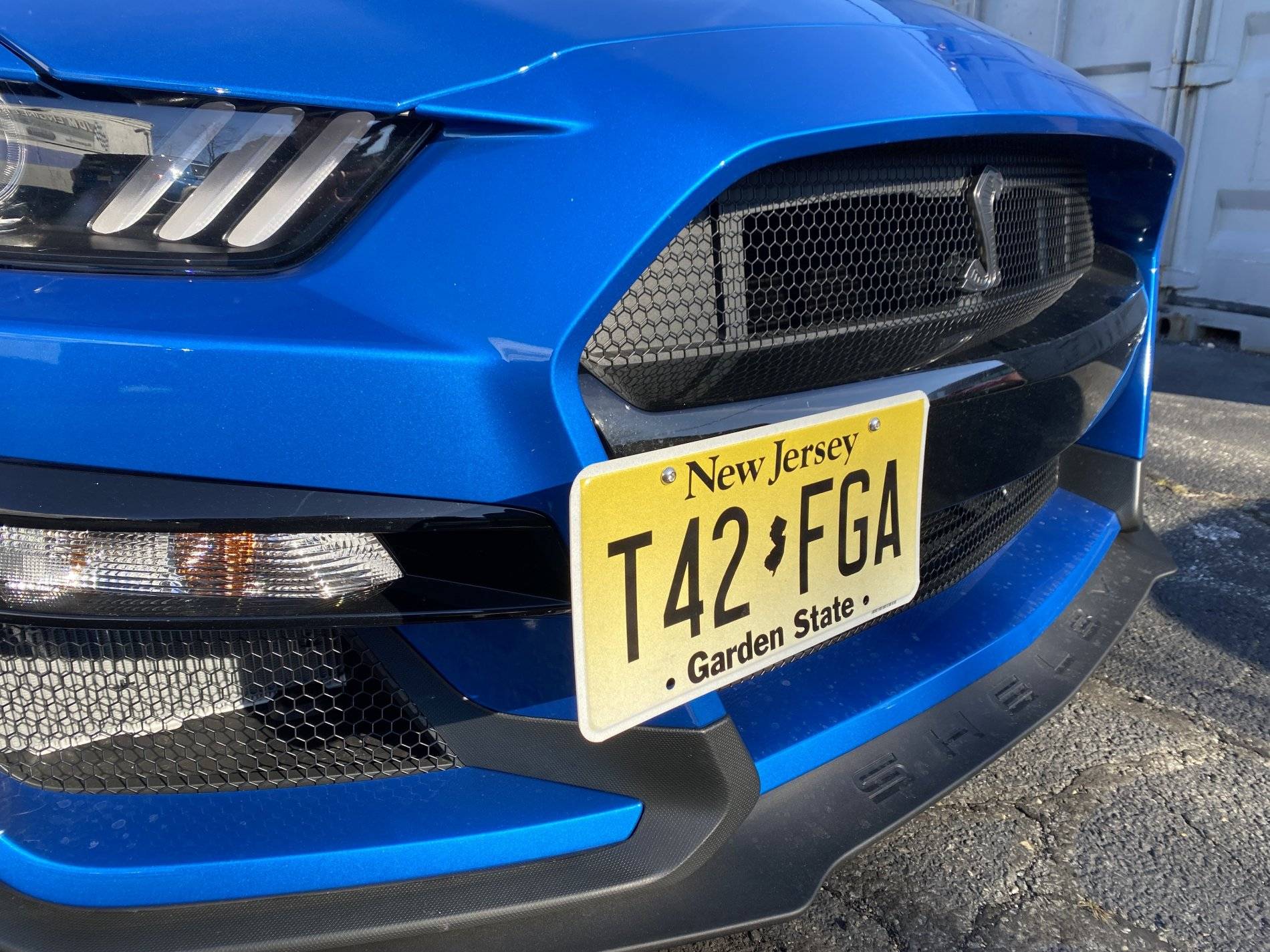

Soon :)
Sadly been Busy with a couple other things
Well we all have things to take care of, hope it is all ok. The picture of the plate placement looks great. Will wait for the next step. Chris

Soon :)
Is that the Gimmspeed Bracket? (Looks like it)
Wanted someone else to spend the $80+ to test fit it before I jumped in...
I spoke with Grimm Speed Cust. Rep. yesterday about the Relocation Plate Bracket and they said that they did NOT have a compatible part that would fit the Mustang Set-Up. So whats up?
