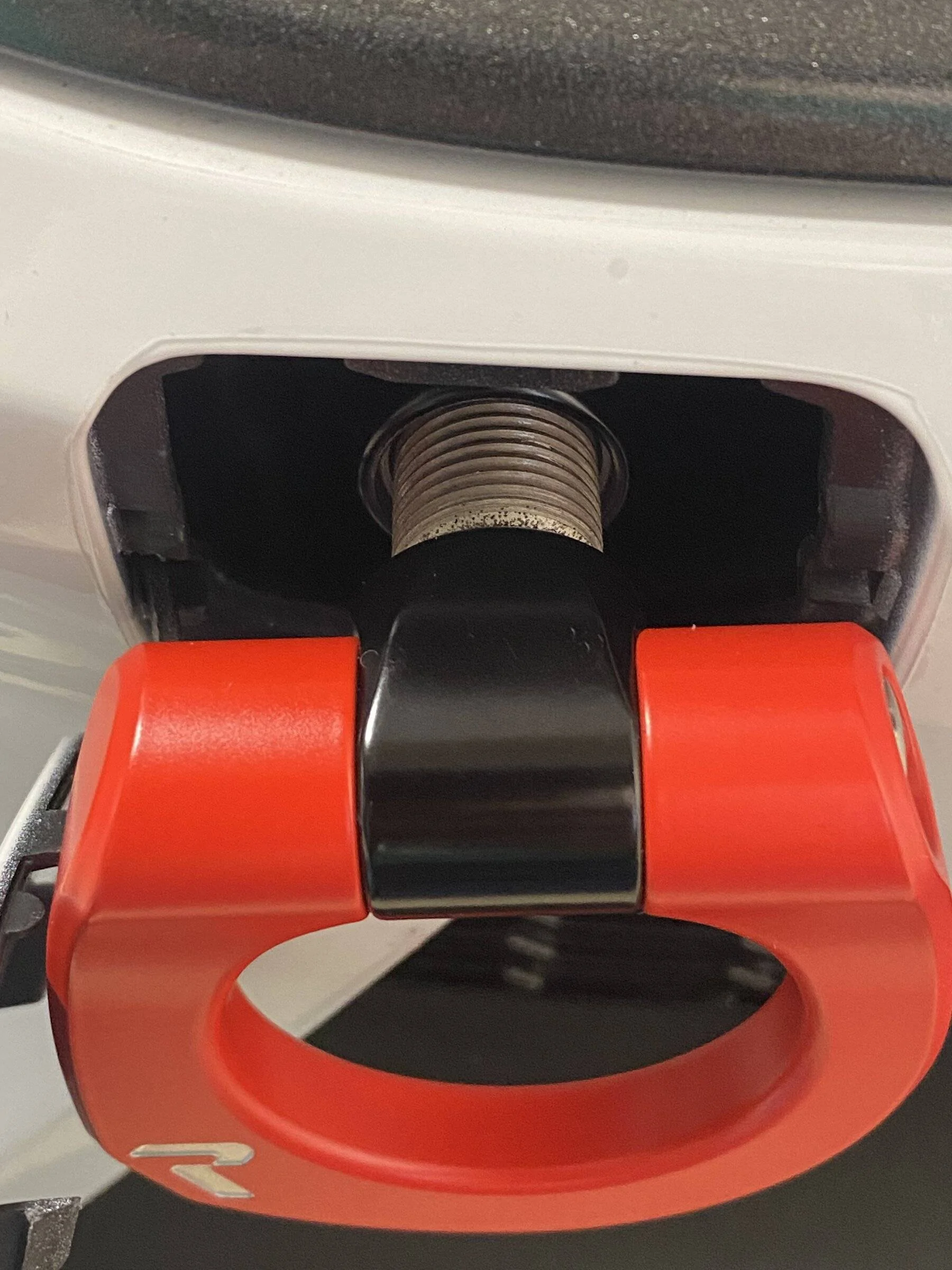

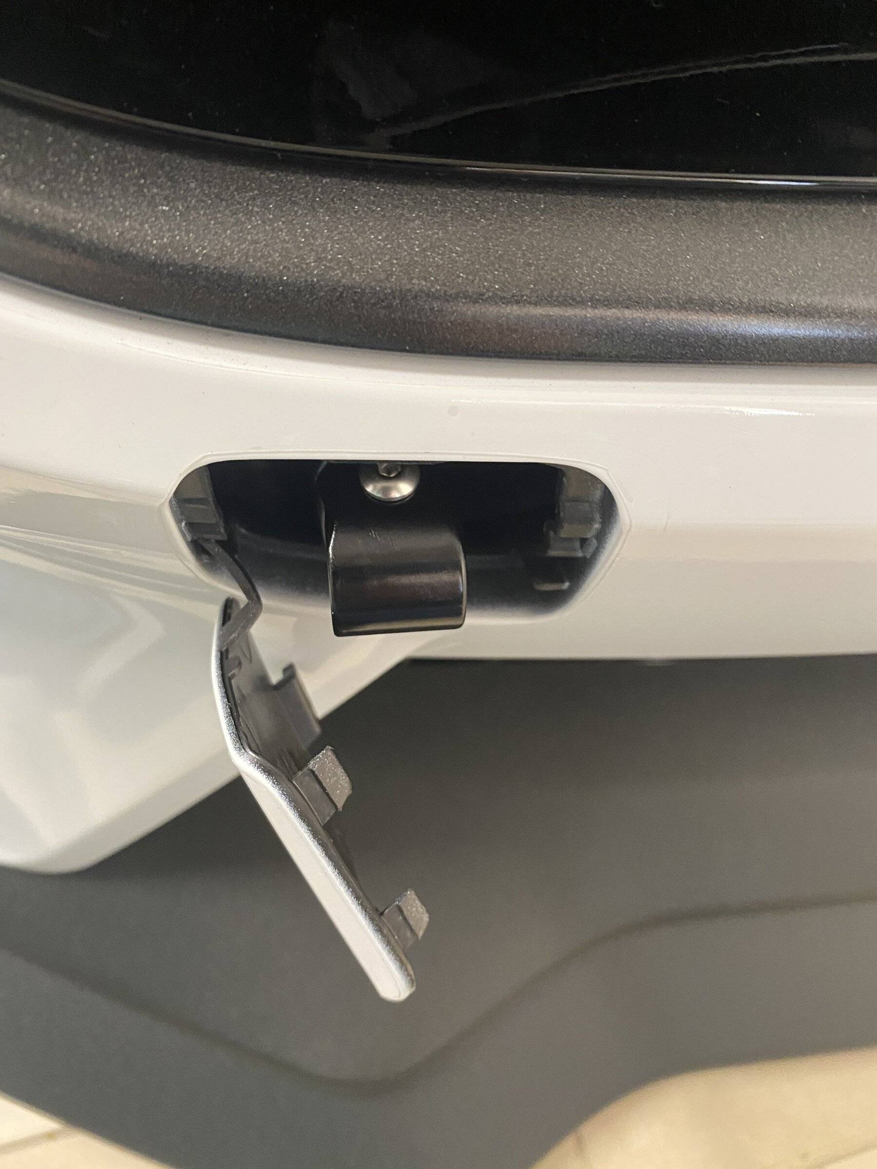

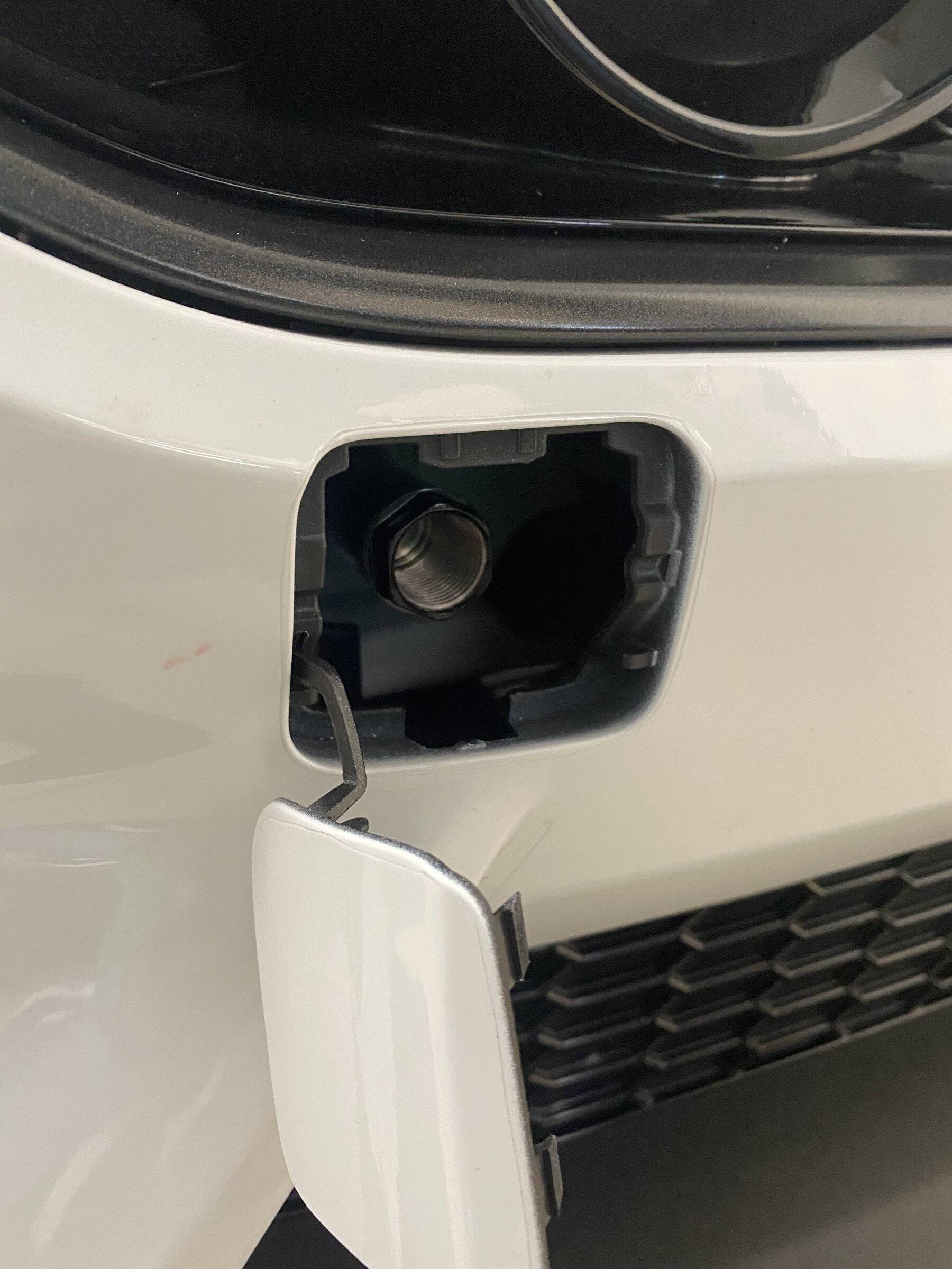

Raceseng Gt500 tow hook doesn’t fit. The threads are right, but the threaded shaft is too short and doesn’t clear the bumper.

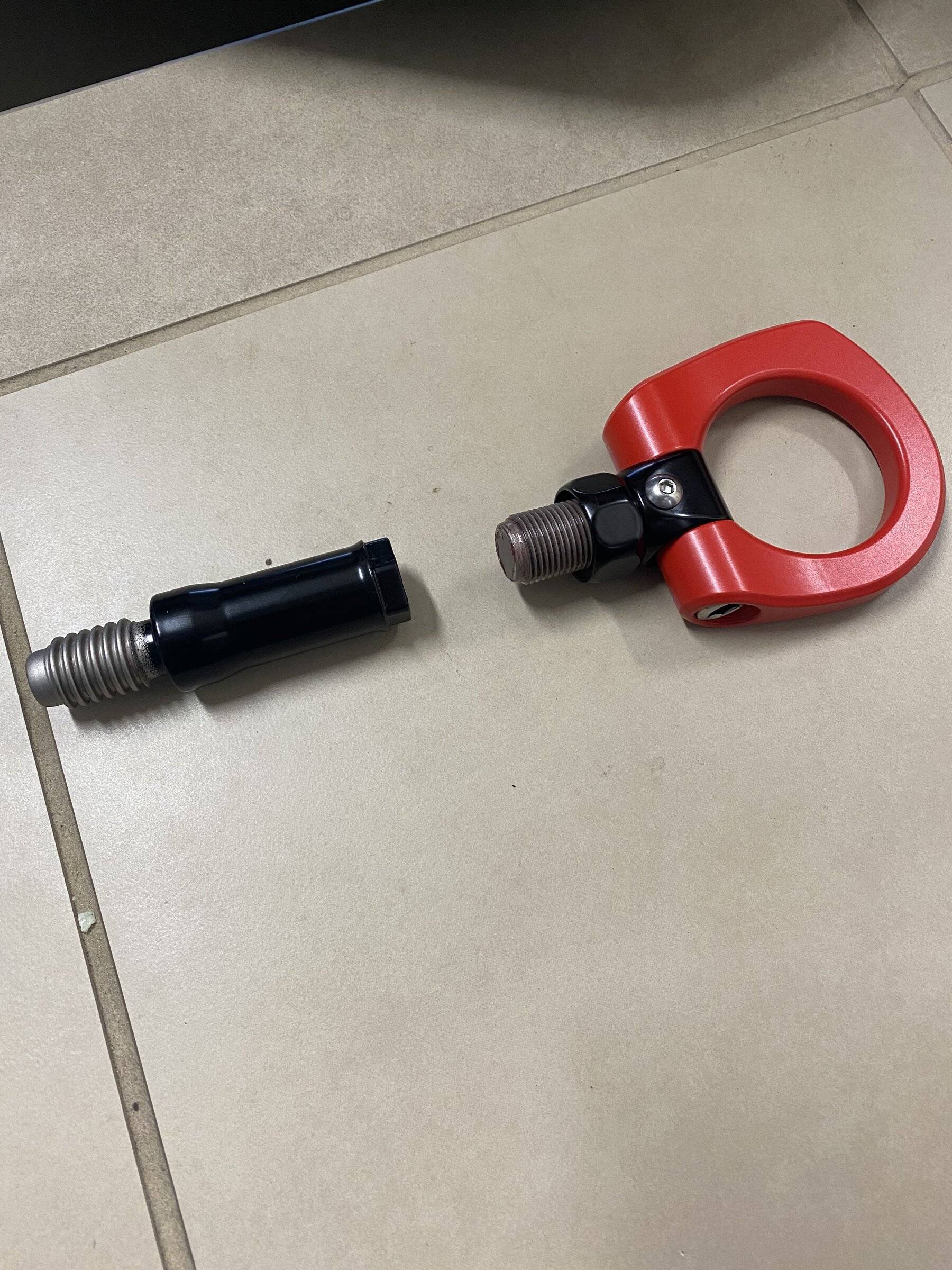

The shaft is just powder coated black I think. I can have someone at work make a replacement for me based on the one raceseng sends me and then get it coated myself.
odd that they wouldn’t make a slightly longer shaft for the Mach 1. Seems easy enough to do

Yeah that was also my thought. I also figured I could maybe get a decent fab shop to make one, or even just a small extension adaptor, that way you can still use the shaft they sent, and with it being tucked inside the bumper you won't need to powder coat it. let me know if you get something made, any chance you could make two? iF I can get something done in the meantime will let you know.

Shouldn’t be a problem. I’m in an aerospace shop so I’ve got plenty of material and I’ve got a guy that can do this job. As soon as it comes in and I get dimensions off of it I’ll let you know. I’ll prob have him make a few of them in case anyone else runs into this.
Is the only issue we’re looking at the length of the shaft? Do you know if the shaft is all one piece with just the visible section powder coated?

I can only get a couple of threads engaged on the actual ring adaptor threads before it comes in to contact with the bumper. That nut needs to clear the bumper for tightening and adjustment. So looking at extra 2" maybe for an extension.
RandomTask
Oct 21, 2021
194
244
DFW
Aaron
2021 Mach 1, 2020 F350 DRW Platinum
Here it is with a couple of threads engaged.
