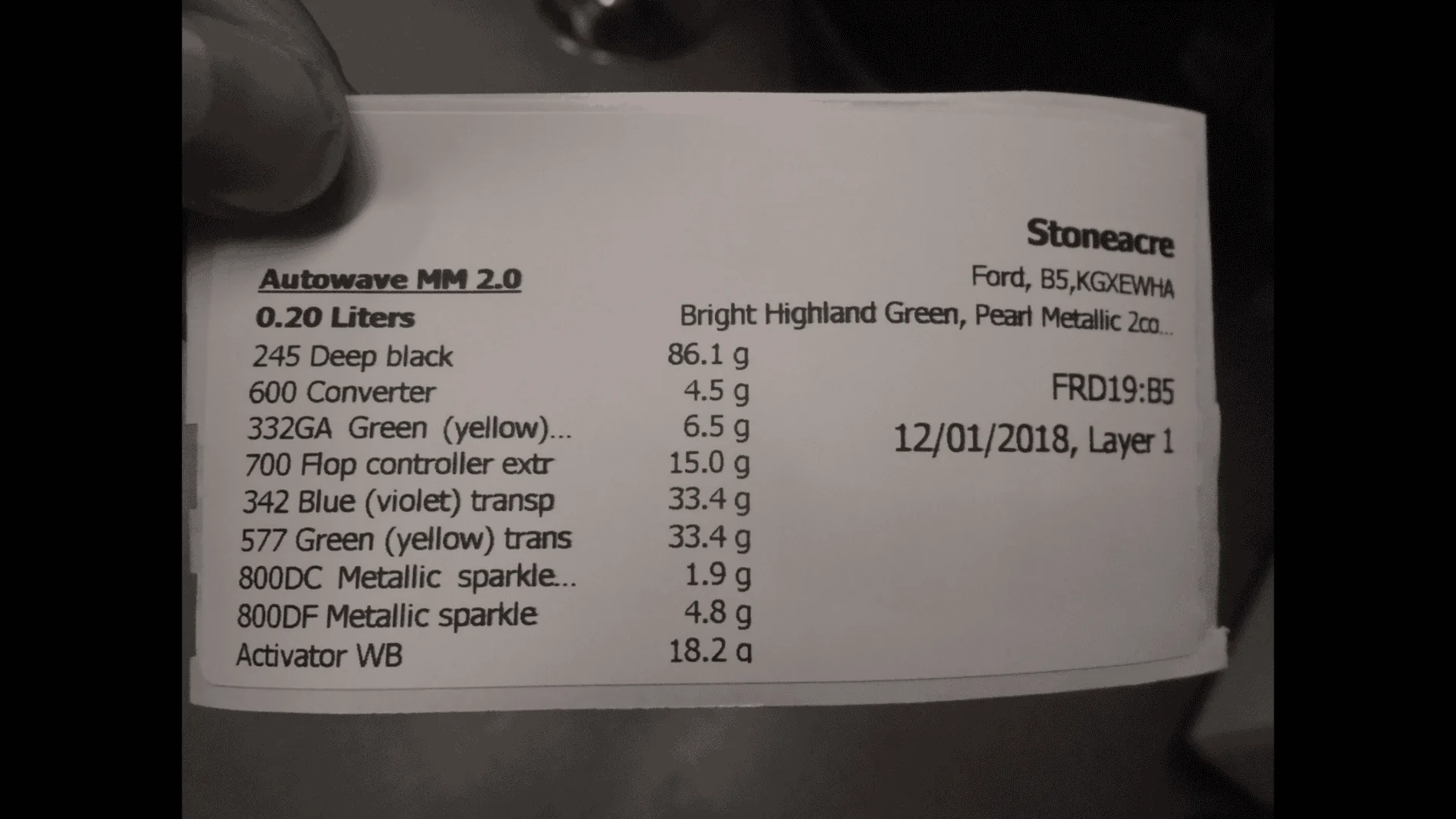

I believe all the touch ups you’ll see online are for a late ‘90s/early 2000s Ford Ranger/Explorer or similar, I got mine mixed up by a professional bodyshop, this is the correct formula for the Bullitt using the SIKKENS paint scheme
