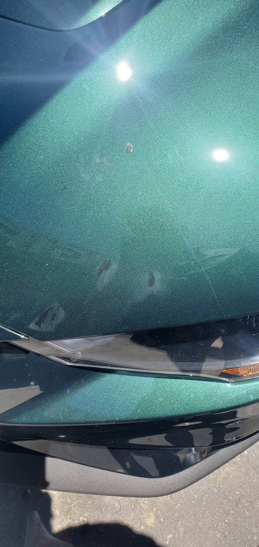

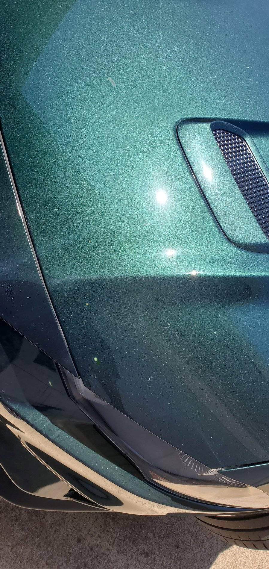

So a while back I noticed some rock chips on my car and decided to fill them in with a color pen I bought at Ford. It kept bothering me and I read up a few guides online and went for it. Except when I went to sand it down I messed up the clear coat around it. I went to a local maaco who gave me a quote of 300$ to fix it. Upon checking reviews, there were mixed reviews on maaco. I asked the local ford dealership and they saw it and recommended caliber collision. Took it to them today and they took the car back for 15 mins and brought it back like nothing ever happened and didn't even charge me for it. The rock chips are visible again though. Looks much better now and I bought Dr. Colorfix for them. Anyone used Dr colorfix or similar product and have an input on it? It looks too simple on youtube.
