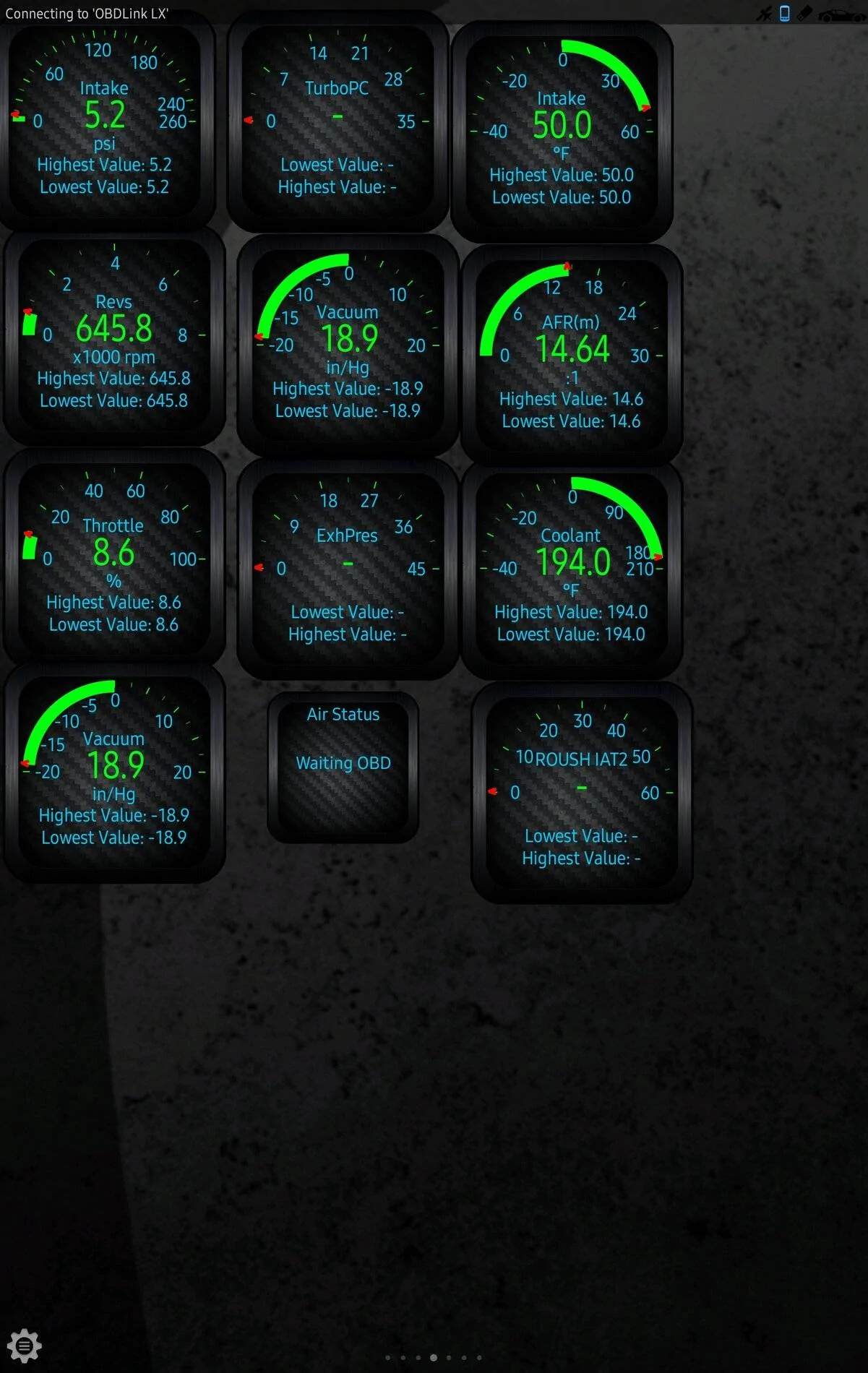

This is what my set up looks like now.

Thanks! But should I change the values?
What can I add for my SC boost?

I have the roush supercharger the iat2 method 2 is the one you want to use. There is a PID for boost also just look down the list you will find it.

If you don't get a reading for either the method1 or method2 PID's then Roush might not be using the same sensor that they used to. The PID that I was using was for the old Ford supercharger tune strategy that both Roush and Whipple were using at the time, but I think the newer Roush's have made some radical changes since I think they are speed density tunes now. For boost, see if you can find a MAP sensor PID. My car doesn't have a MAP sensor, so there is no way to access a real boost reading outside of the inferred one that is calculated from the MAF and other sensors.

I have a 2020 with roush method 2 is what works. There is also a boost PID that works.
