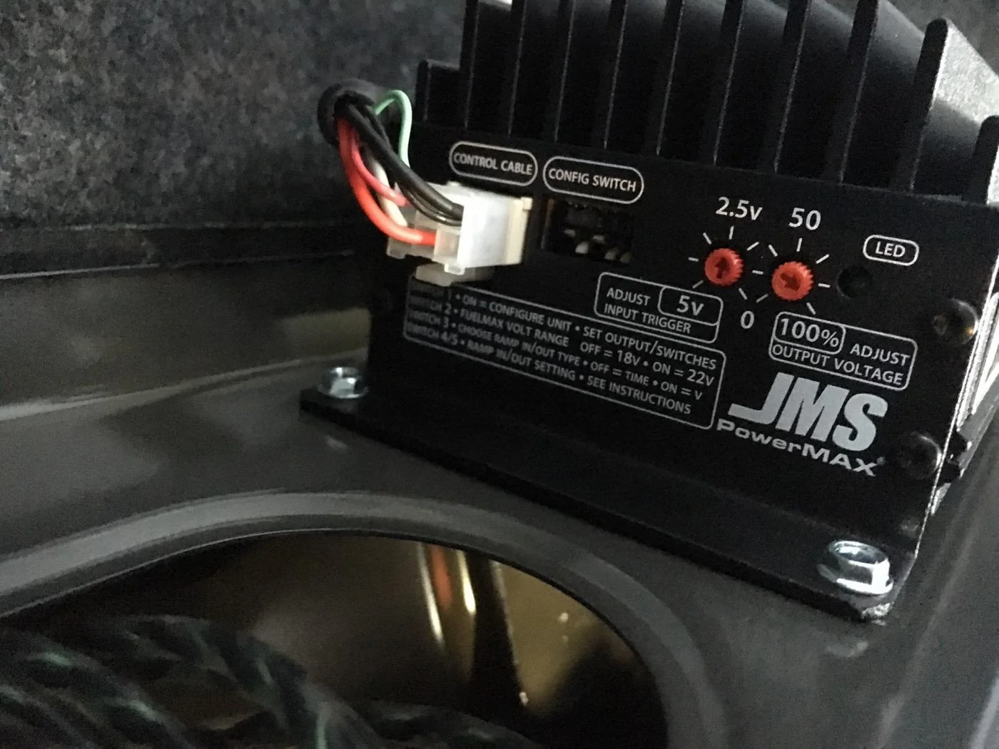

Here ya go

My settings are set for voltage to ramp,not time ramp in.I have mine set to start ramping up at 2.4 volts which is about 50%throttle and max out 18 volts at the pump.It will start to ramp in at 2.4 volts at the pps and max out at about 5 volts at the pps,which will send 18 volts to the pump.I would not reccomend running it at 21 volts if that is what that tech meant.
