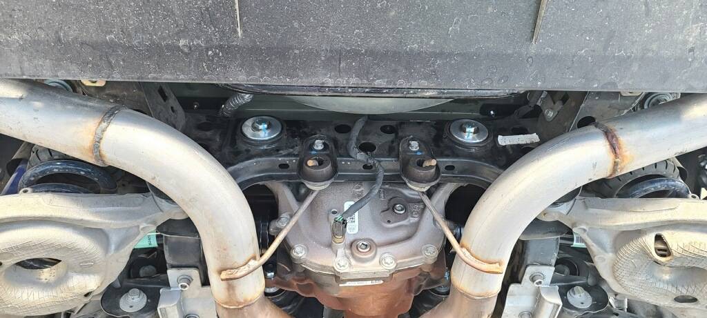

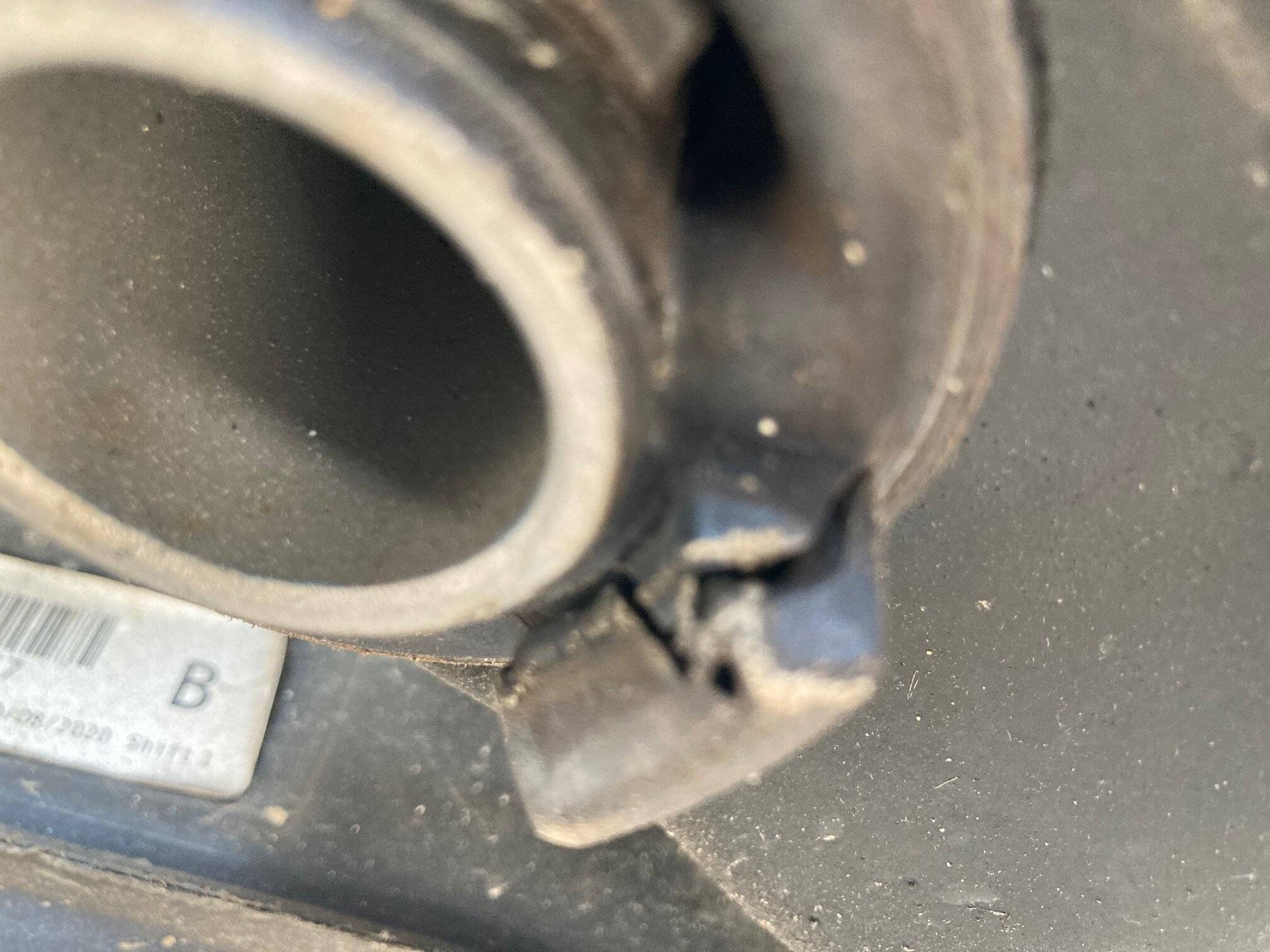

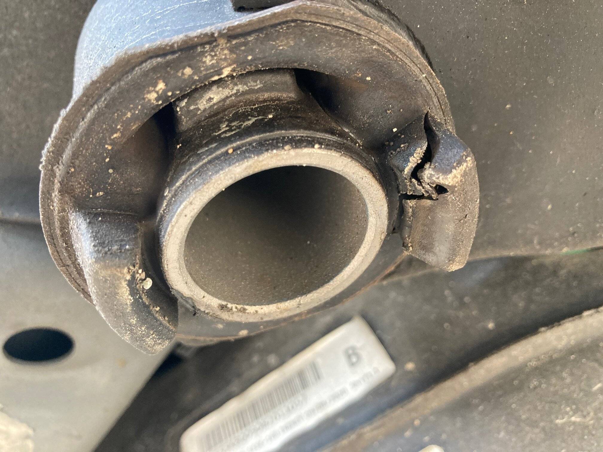

I purchased the Steeda Stop the Hop kit, and when I went to install it I noticed the driver side front IRS subframe busing was already torn. Car is 2020 GT with only 2500 miles on it, and still has the factory 235 all season tires.
I ended up just installing the kit over these anyway. Will I have any issues moving forward? I assume I could have taken it in for warranty work, but I probably can't now unless I remove the Steeda parts before taking it in.

With that low mileage I would take it in. Also makes you wonder how it got torn.
However on mine I tore a diff support bushing on the rear subframe and I just added some aluminum race bushing supports and called it a day. The ride/NVH isn't even that bad either.

@Bonedizzle, did you have lots of hard drag launches and wheel hop during the 2500 miles before you went to install your differential bushing kit? Sticky tires? That is very strange to see something like that, so soon.
Bonedizzle
Mar 2, 2021
116
30
Omaha, NE
2020 Mustang GT Base
just your usual i have a new mustang stuff, couple burn outs (how else do you test the line lock?), maybe a handful of launches, all on the street and all on the factory 235 all season Pirellis. I thought it did have bad wheel hop, which is why I went with the stop the hop kit.
