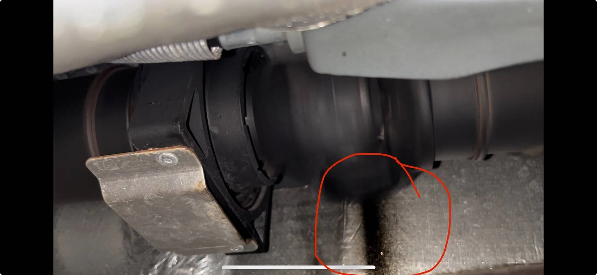

I just noticed some grease splatter from the video I posted. It makes me wonder if my U Joint is going bad. I’ll have to inspect it a little more thoroughly next time my car is up in the air.

I’ve never seen a steering wheel shimmy be anything besides something attached directly to the front wheels. As for the amount of movement of that DS bearing, I’d have to compare to some others. It makes some sense that there could be some amount of movement there, otherwise they would not use a rubber damper bushing around it to absorb the vibration. Is it excessive? Not sure.
I couldn’t agree with you more regarding the front end. I’ve read through most of the 300 page forum about the 50mph-70mph shimmy plaguing the earlier S550 mustangs. A few guys had reported a steering wheel shimmy while experiencing driveline issues.
I also agree that the rubber surrounding the carrier looks purposeful to mitigate NVH.
I’m guessing I have a U Joint issue seeing that I have a grease trail on the underside of my car, and it appears that the half of the driveline from the carrier to the diff looks to be shaking.
