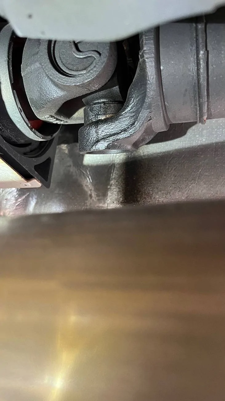

Looks like there is a small amount of grease starting to seep from my U Joint near the Carrier. The U Joint felt tight, but I’m guessing that if a non-serviceable U Joint starts to seep grease, that it’s ready to be replaced.

I just ordered a new driveline through my local ford dealer. I’ll see how it drives after I swap out my old one.

I just installed my new OEM driveline. I am happy to say that my 35mph vibrations is gone. I will likely upgrade to a one piece driveline at some point. I am a little disappointed that I started having issues with my factory driveline after only 29,000 miles, especially since my driving style is so mild.
