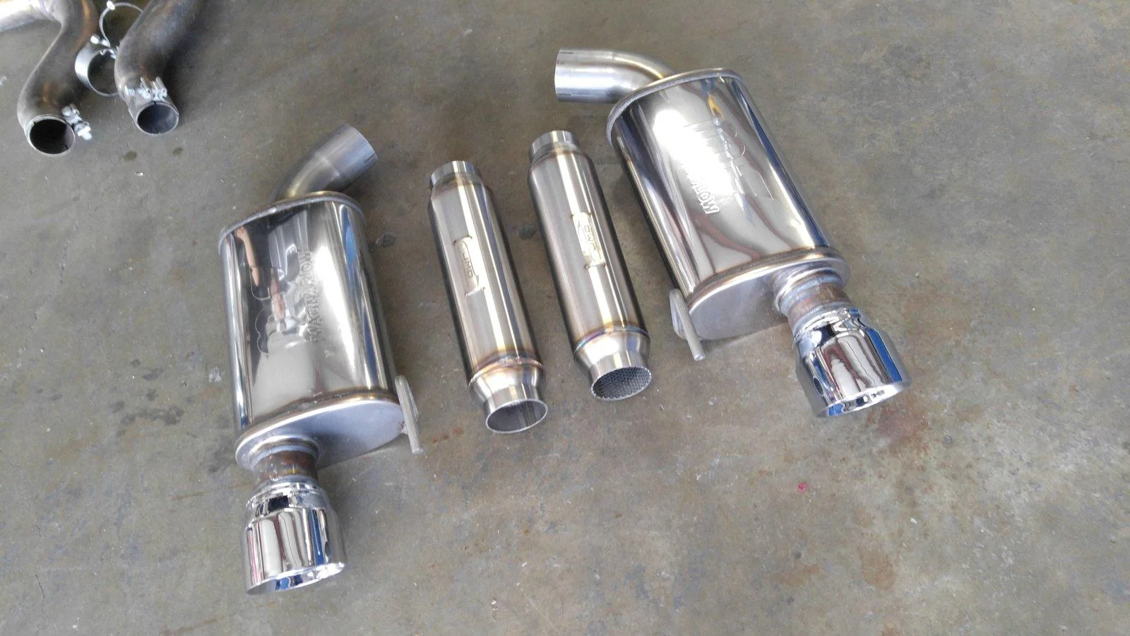

I ended up using what is essentially a Magnaflow street axle back with two JMD tubes 16" resonators behind a X pipe. I am really pleased with the results. It has a deeper and smoother sound with less volume when compared to the Corsa setup. I wouldn't say it is quiet, but it's not a really aggressive sounding setup. If you have any other questions about is feel free to ask or send me a PM.

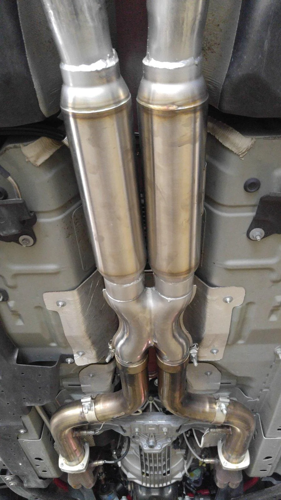

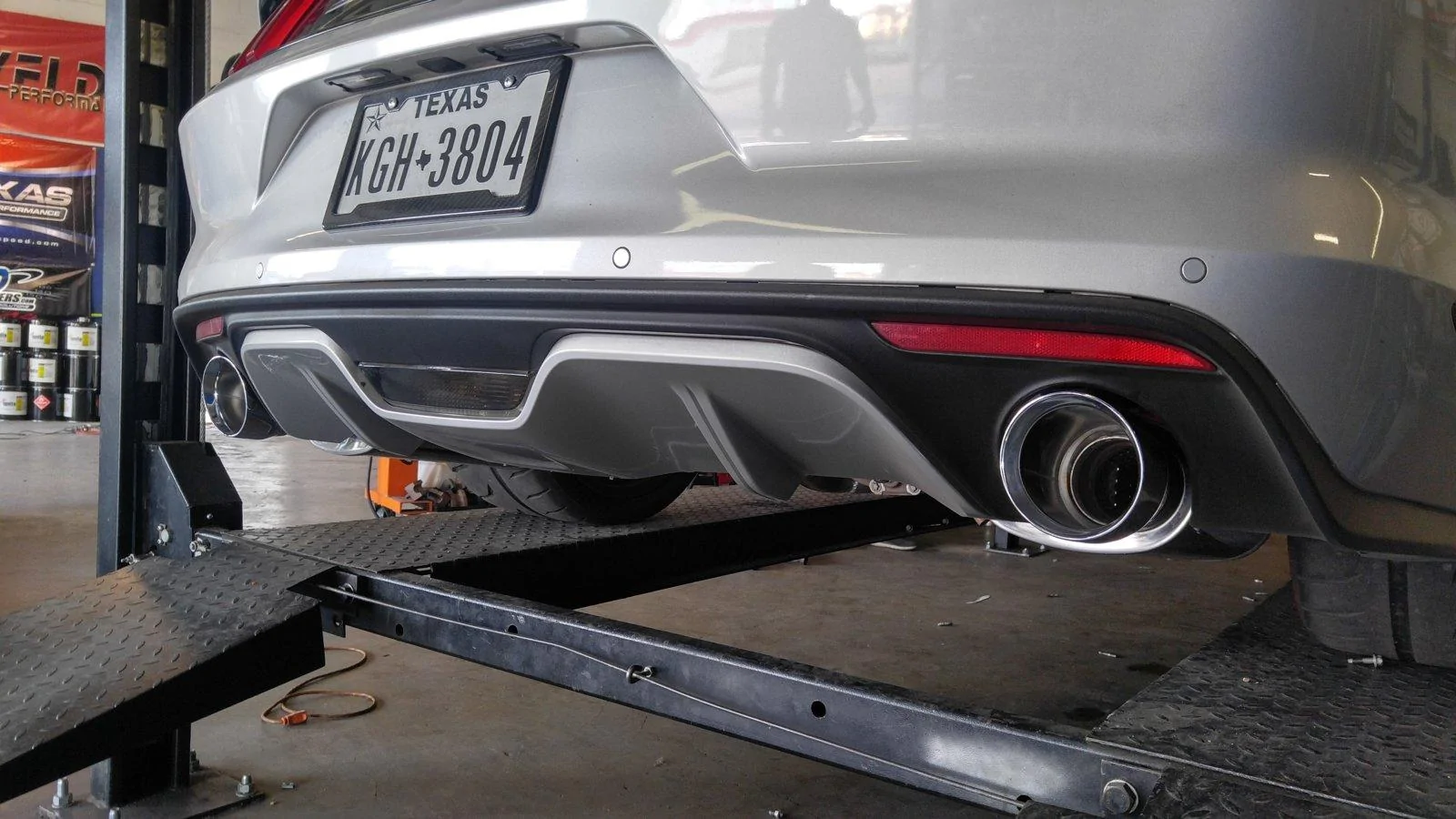

Here's the setup I ended up using. Its a stainless x pipe with 16" JMD Tubes resonators and a Magnaflow street axle back. I'm very pleased with it overall.
Looks good, Bryan. We'd love to hear a sound clip of it if you have the chance!
I only have one clip currently and the file is to large to upload on here. I'll have to get another clip
