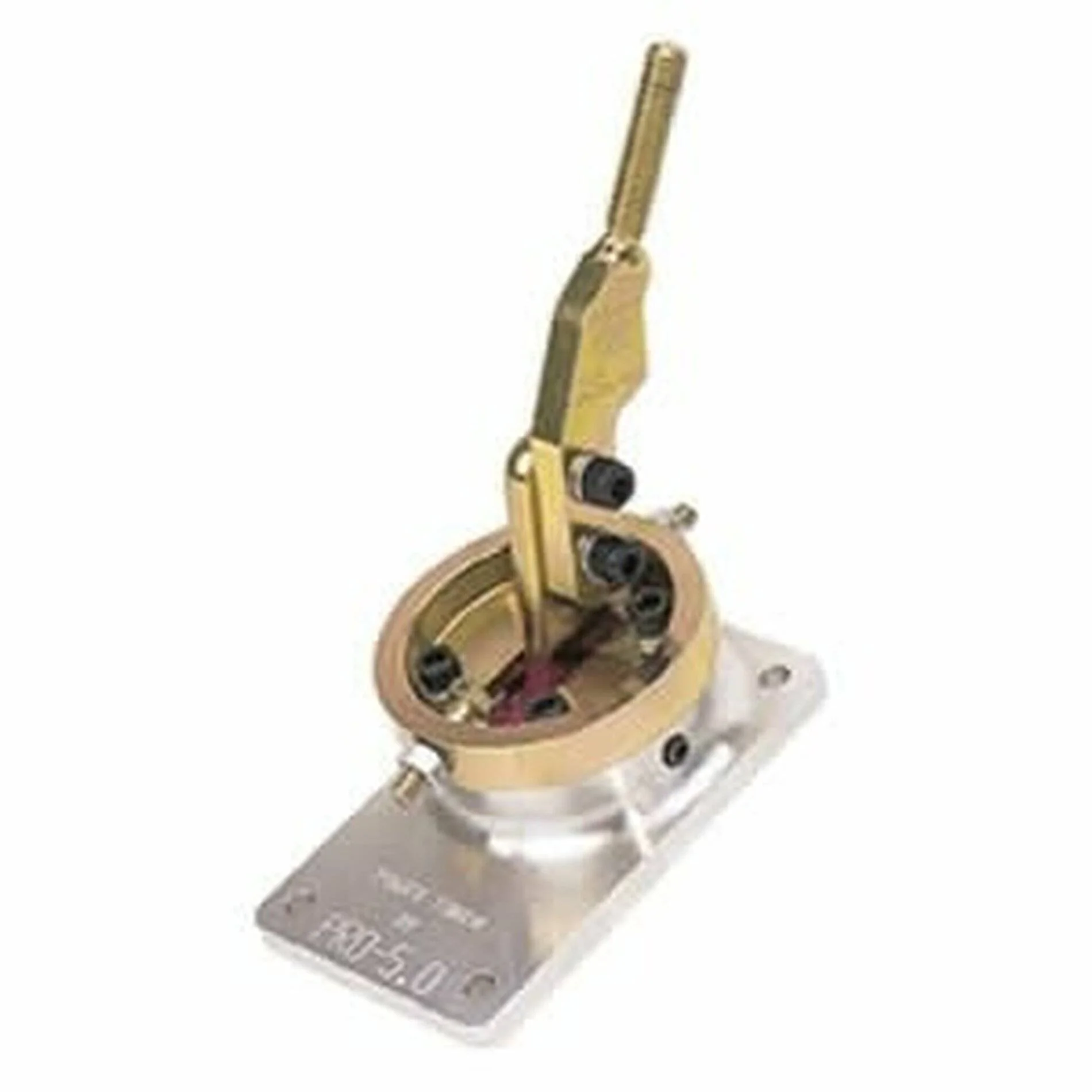

I don’t think running a flat stick would change anything on the throw. I say go for it if it appeals to you. The older Mustang shifters from Pro 5.0 came standard with flat sticks.

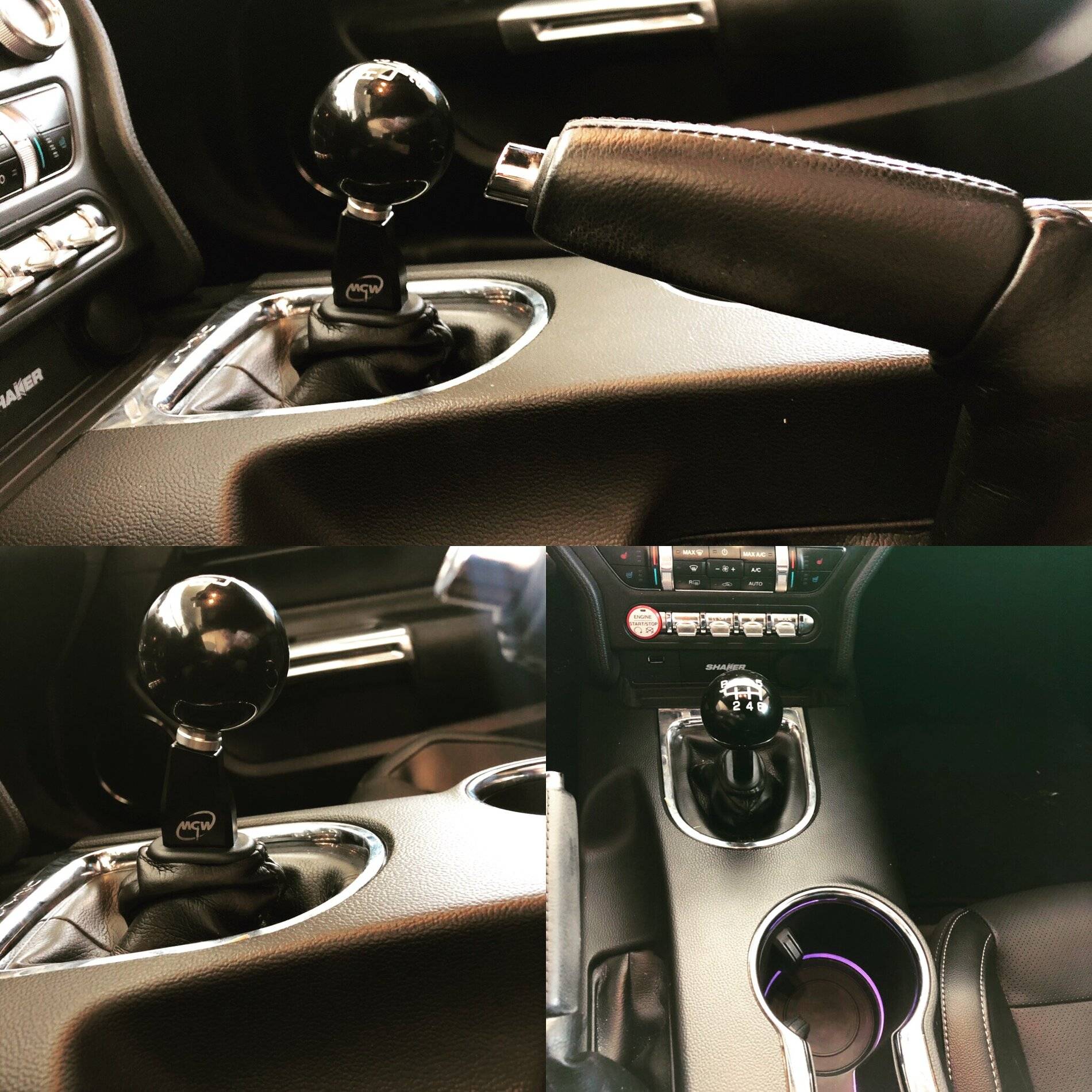

The Flatstick is around 19-20% throw reduction and IMO is the optimal height. I ran one in my 17 and it was low enough to feel the difference but not so low that it inhibits the shifting. Definitely my suggestion for MGW ☠🤘🏻

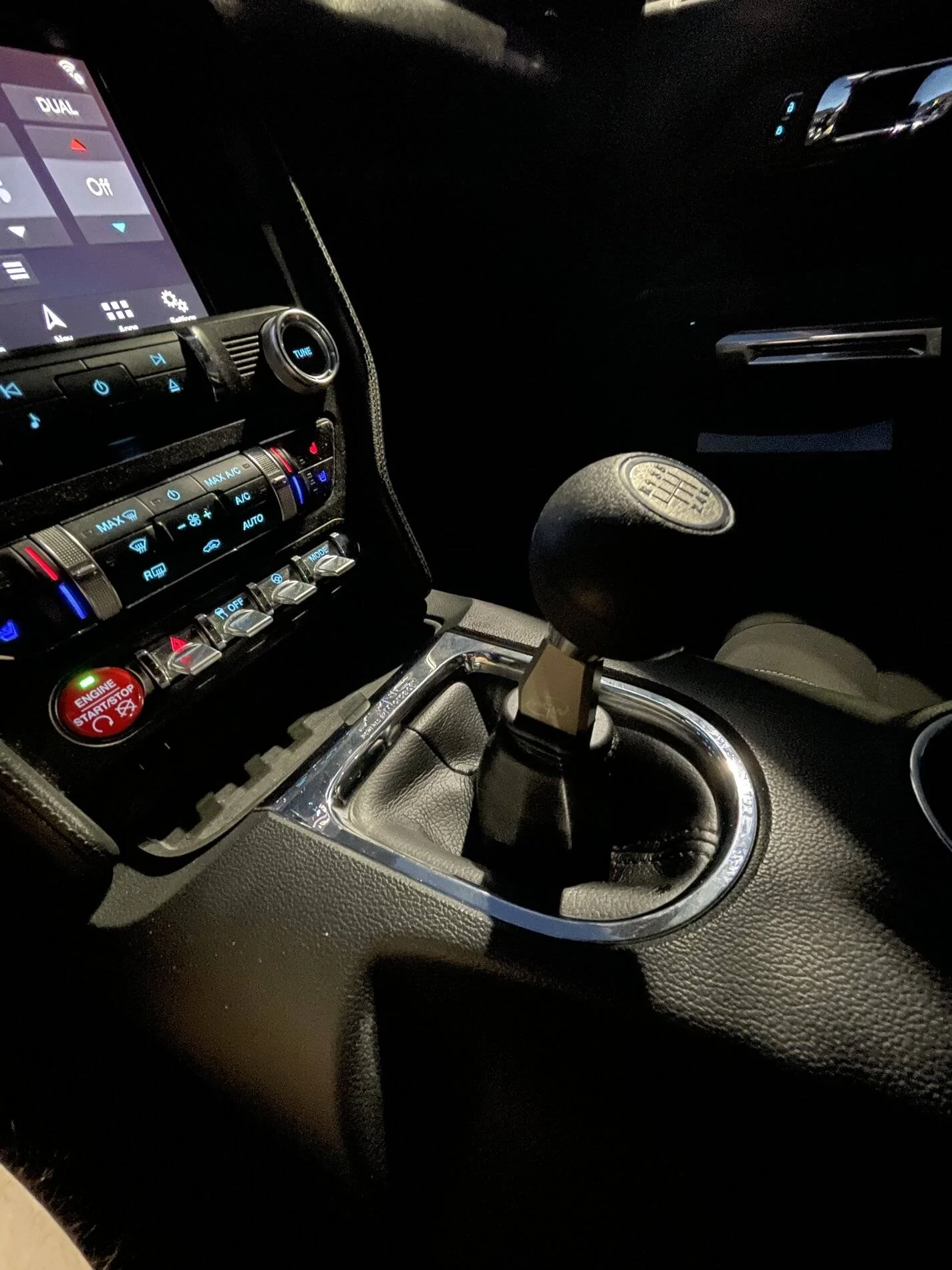

i actually just ordered my shifter last night. went with the flat stick. went siver handle, stainless stem and ghost coyote topper. my car is royal crimson so i was tempted to go red but with all the trim otherwise being silver i kept the trend alive. im stoked but i want to do the driveshaft at the same time. few more weeks and i can buy one.

I have the flatstick with X-Spec and simply love it ! The throw reduction is perfect (not too short) and it looks great with the gripper ball and ghost Coyote logo !

Good choice with the silver flat stick! It is a huge improvement over the stock shifter.

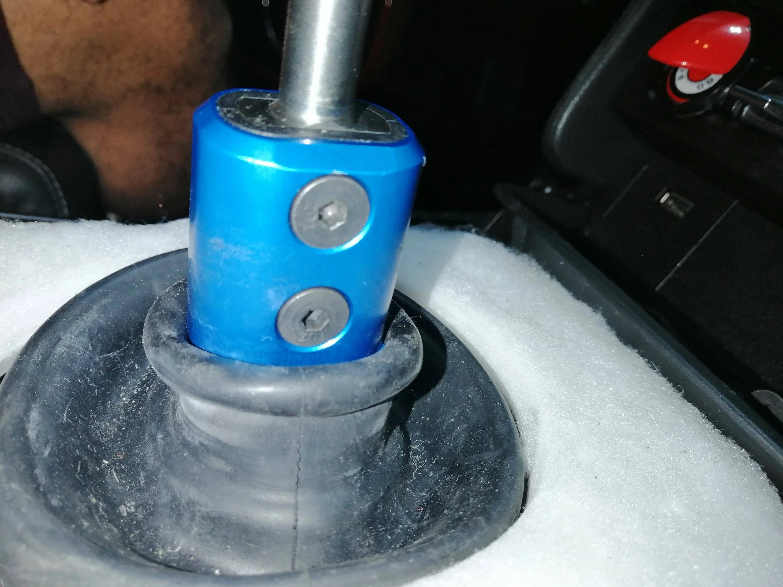

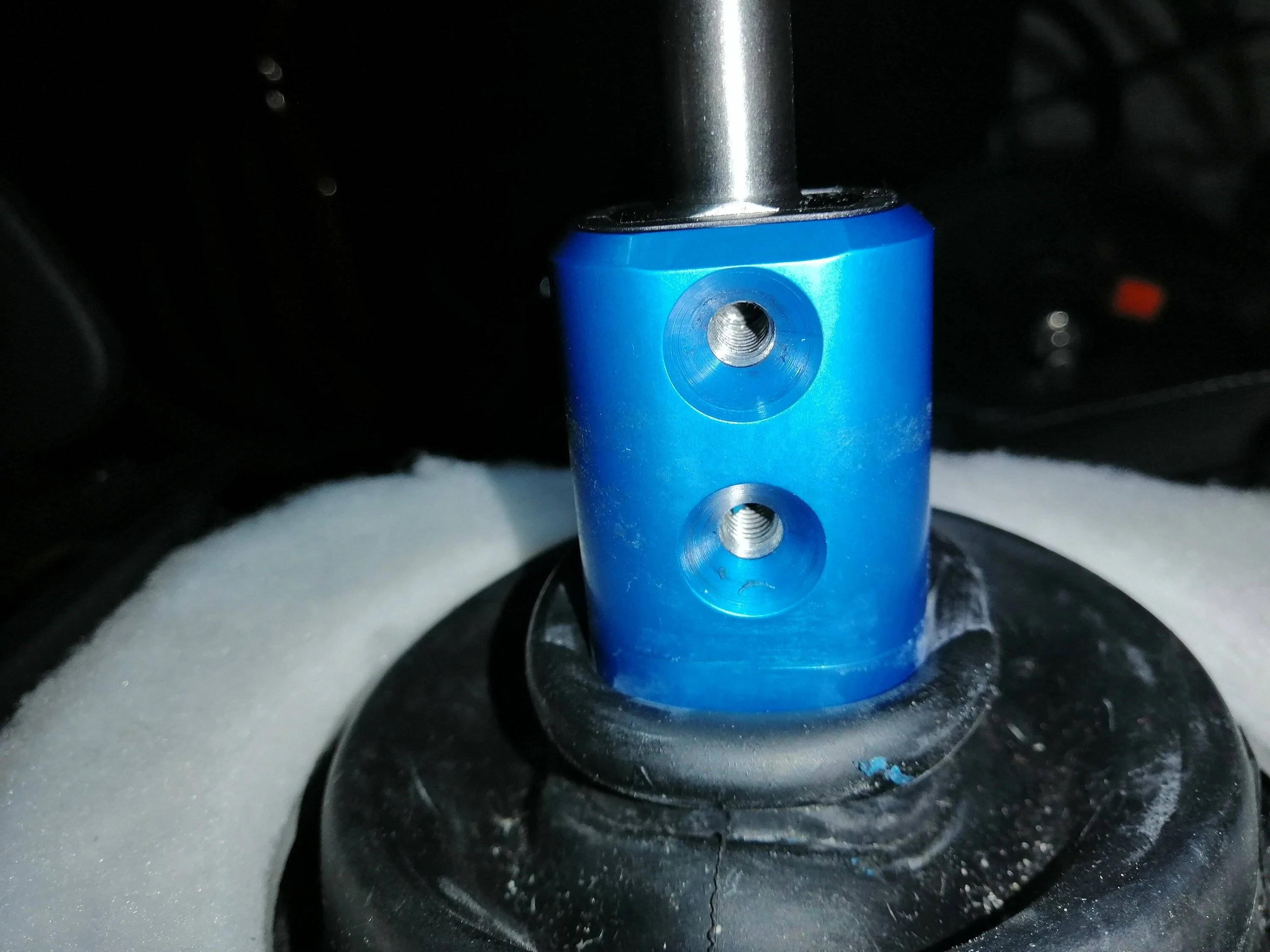

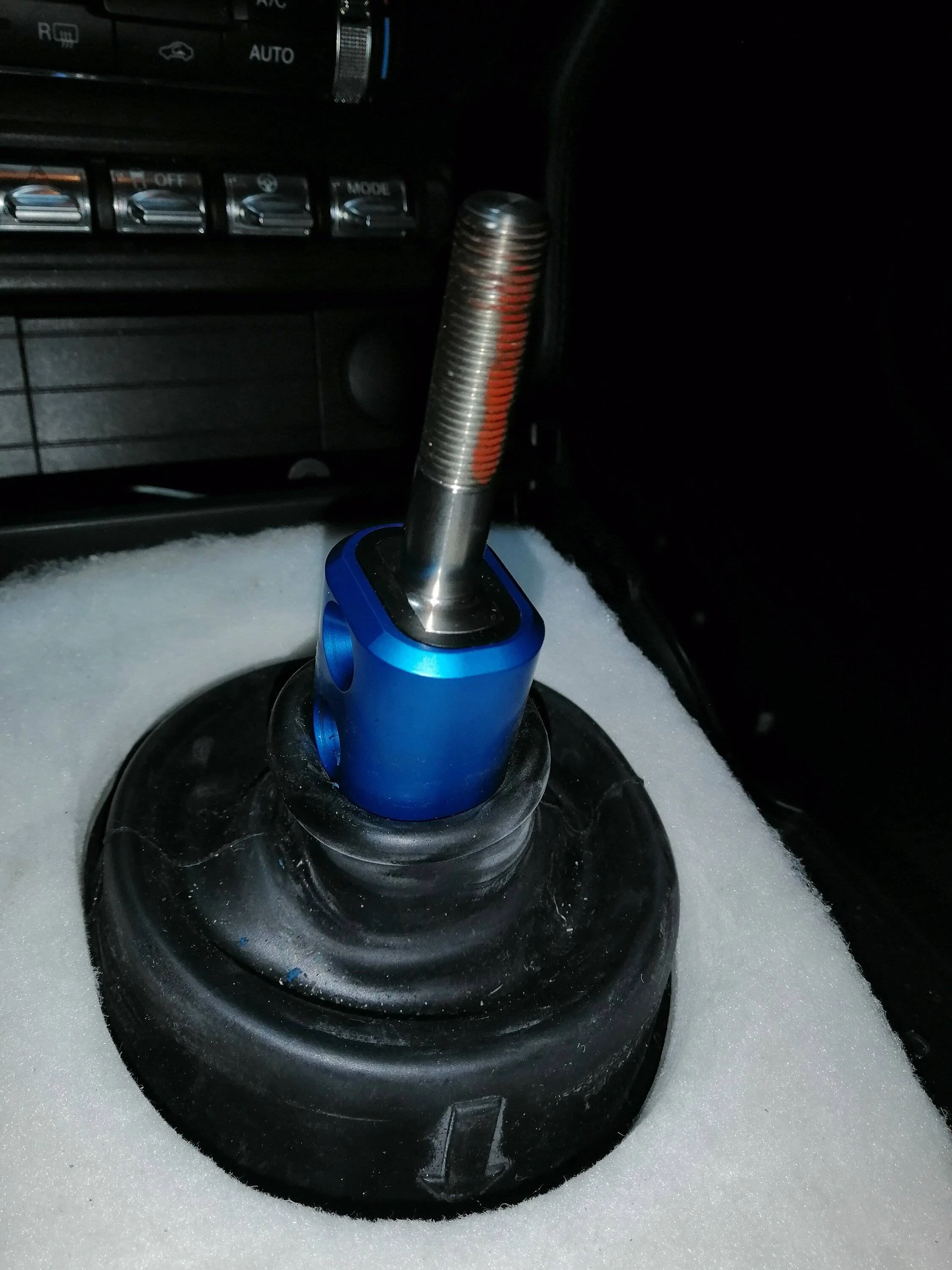

Hi everyone,
So I ordered my MGW low profile from lethal performance & I didn't see an option for flat stick. I had to order it from MGW to replace it with whatever stick I got. It has 4 screws 2 on driver side & 2 on the passenger side. I removed the drive side easily but the stick has these screws on a bushing that rotates with the screws. It looks like the passenger side screws are sooo tight & hold hard on this bushing thing. When I tried to break them first before the driver said the inner bushings rotate & force the driver side screws to be removed (push it back, out) & the passenger side screws keep rotating.
Any idea how to remove them? Used some wd40 did nothing.
Sorry if my explanation doesn't make sense I'm just so frustrated & tired.
If it's making the other side rotate when you're trying to remove one side - put the other screws back in and hold them in place with an allen key - and break the opposite side loose.
