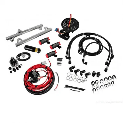

Have a stage 2 whipple and want to let it roar some. Is Fore the only guys in the pool

No, they are not, the following make fuel systems for your set up. Fore is a major player but you can go with other kinds that mix match parts to get a good performing kit for less.
Fore - uses all Fore parts
Lethal - mix of Fragola, in house and Aeromotive
Jn2ning - mix of DW, Fore, and in-house parts
Sai - mix of red horse, aeromotive, on3, and lethal wiring harness

Thanks Kona. Do all the others there have staged as well? I'd like to just do the fuel one time and be covered pretty much for anything I decide to do later with the whipple.

I went with a JN2NING triple pump kit for my 2019. I emailed them with my needs and they were able to square me with what I needed as well as a good price for the kit. I would also recommend to spend the extra cash and get the most to cover you for future upgrades, that way you only buy once.

Fore is literally the best, I wont buy any other fuel system. Justin has the best customer service you could ask for.

I also went with JN2NING. No complaints whatsoever and great service.

For a Whipple, CJ Motorsports kit. It's built for the Whipple.
I have been looking at that kit. It’s an interesting concept using the original supply line for return and I believe some stainless steel hard line for supply line. Interested in any opinions from people
using this kit or anyone with knowledge about it.

As others have said.... They are not the ONLY player but the most used by big power members on this forum. Myself included. You need to decide your goals. Almost every setup out there can max out a Whipple on stock motor. If you plan on dropping 20k for new motor, trans and supporting mods in the future?? Fore triple all the way.
