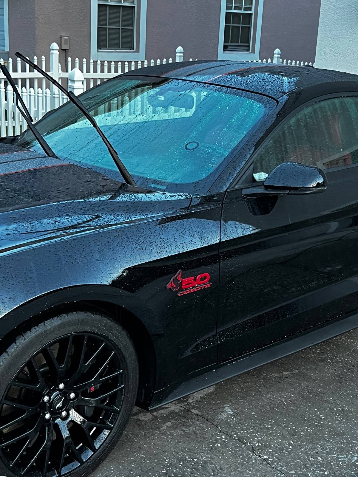

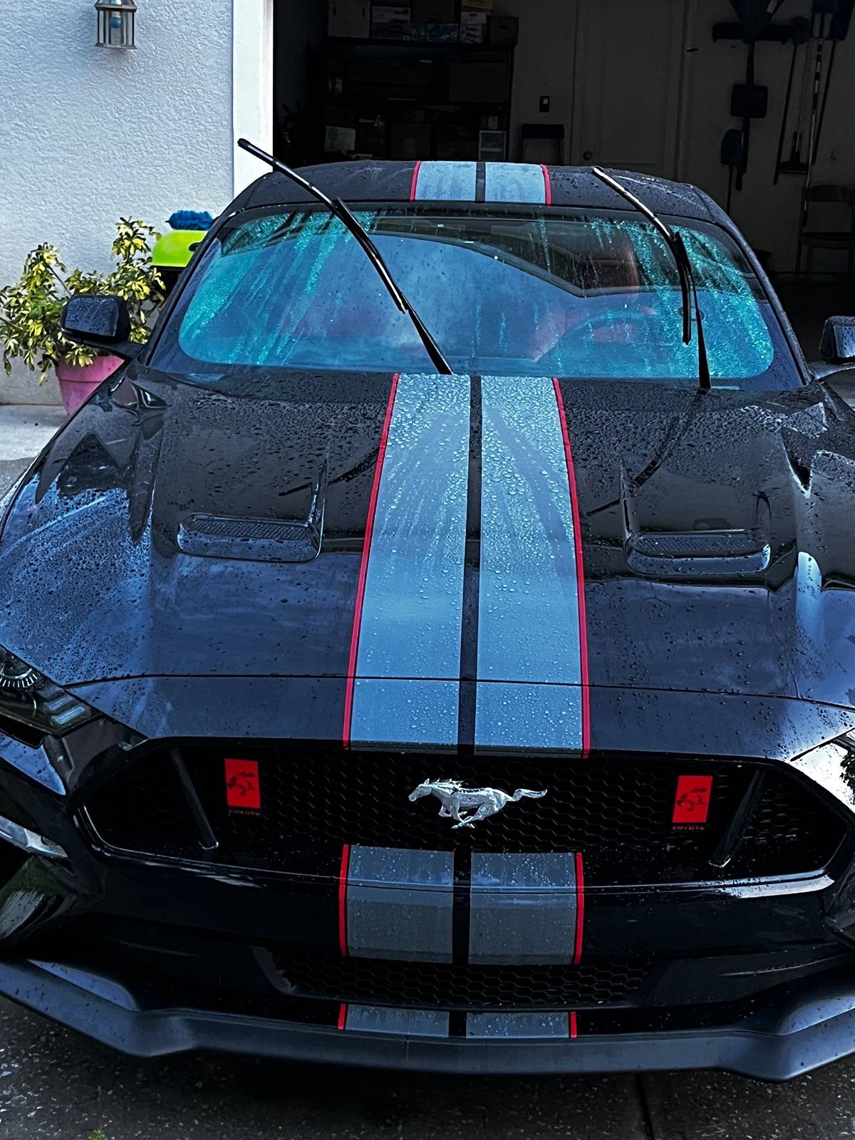

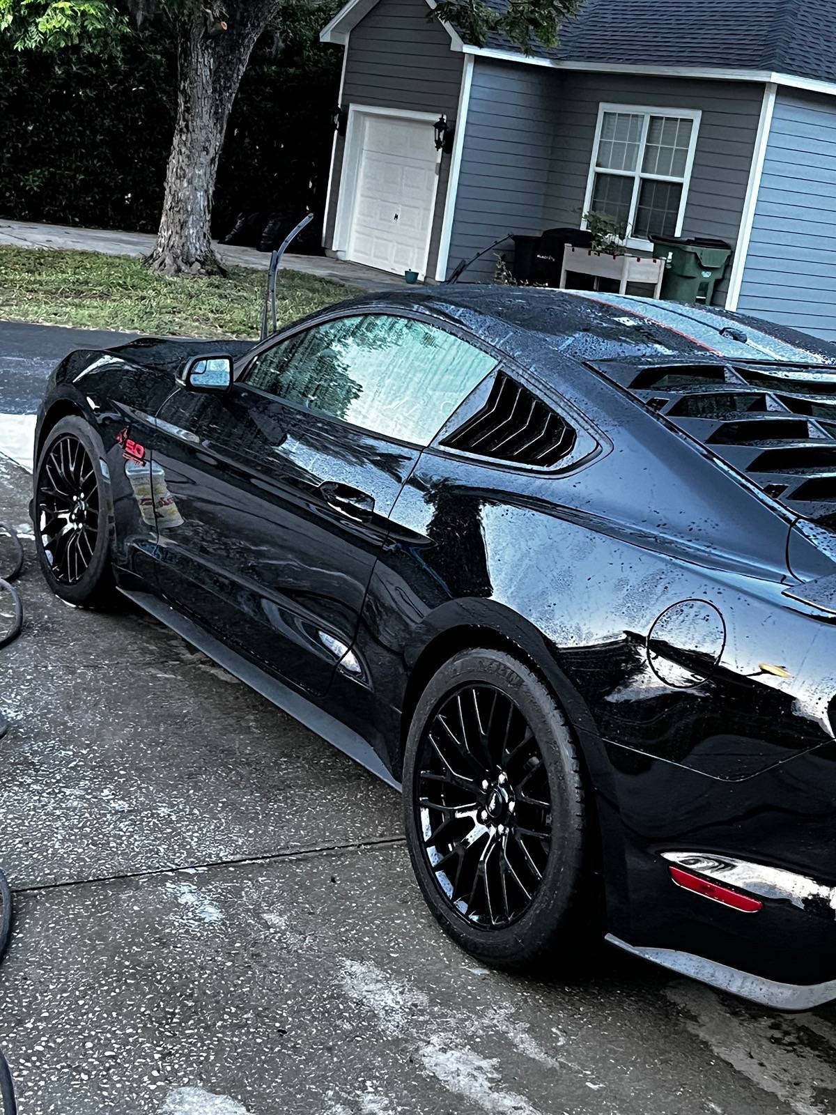

A few months back I gave my daughter my 2018 GT with PP1 the rear she had 275 40 19 she wants to go wider with out changing the rim can she go 295 40 or 305 40 i’m not familiar with tire sizes. I believe the ram is 9 .5x19

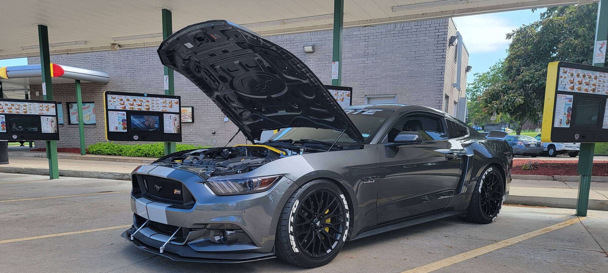

Not recommended. American Muscle has rims for front and rear that look very much like PP wheels and they're not expensive. I'm running 305 on the rear with an eleven inch rim and a 275 on the front with a 9&1/2 inch rim. Both from American Muscle.
