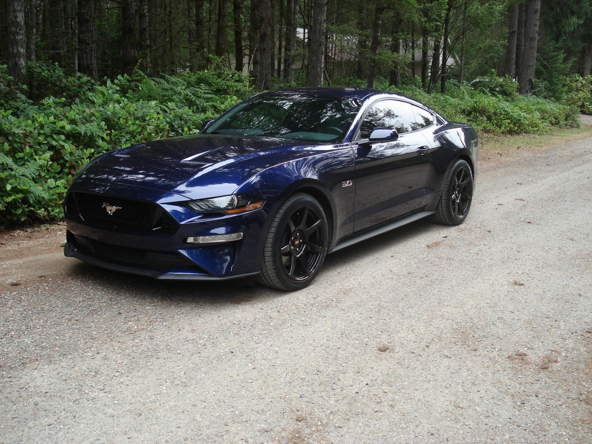

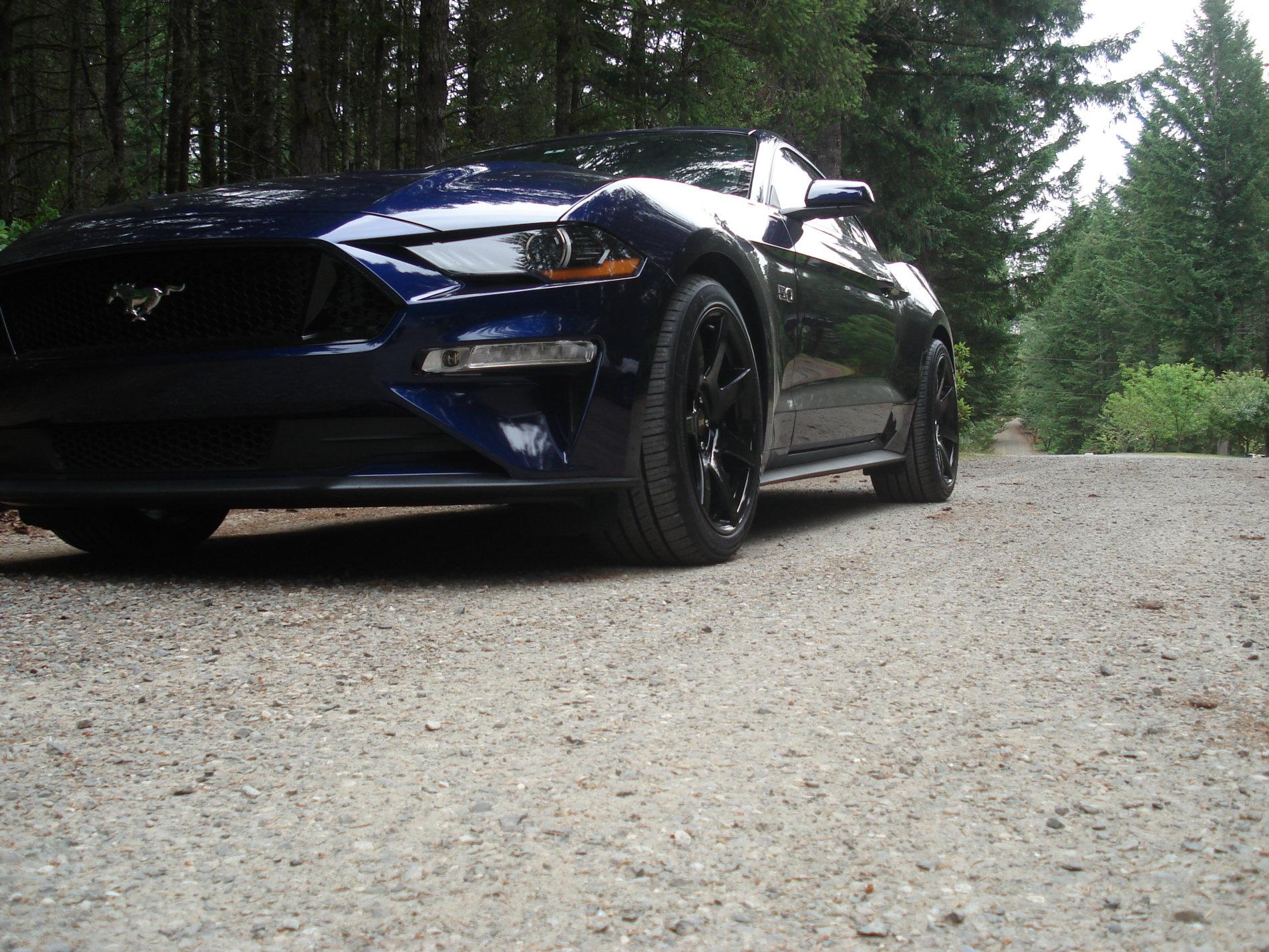

I personally run 265/40 on 19x10, and the stretch is 1/2" over the recommended 9.5". So, the 255 will fit just fine, and have better steering response due to the slight stretch and angle of the sidewall. German cars like BMW and Porsche readily have factory tire sizing that is stretched 1/2" over for that reason alone. A stretch of only 1/2" WILL NOT present a danger of bead separation. If that was the case, I doubt Porsche would have put 265/40 tires on a 19x10" for track use out of the factory. They did it, because the slight stretch actually does provide a slight increase in steering performance over a 275/40 with the same 19x10 rim.
Here's a pic of mine, which is probably very close to what the profile and slight stretch it would look like with a 255 on a 19x9.5 rim.
