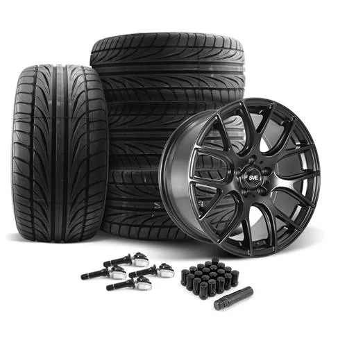

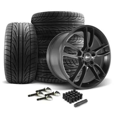

I'm looking at these two now. First set has a satin finish and second is flat.
First set is a 19x10 wheel and fitted with 285/35/19 tires and the second set is a 19x9.5 wheel but also fitted with 285/35/19 tires. I don't track the car, I don't drag it or do autox events, it's just my daily driver and the occasional spirited take off when a local S4 driver (there are a million in my area) wants to give me a go from a stop light.
A coworker who drives an STi told me 285 would be too wide for the front , any truth to that?
I've spent the last hour reading threads on here and I'm even more confused about wheels and tires. Between, offsets, poke, spacers and tucking I can't seem to wrap my head around it.

Lots of people run 285 on the front. Between those two I’d go with the GT7 option you have listed first.

First set GT7 19x10 ET35 is a nice flush offset and a good match for 285 tires. I'd pass on the Ohtsu mystery budget tires for a better tire which maybe doesn't offer quite so high of a profit margin to LMR, perhaps.
The 19x9.5" SVE drift wheel is a more perfect match for 275/40 tires in most cases, but 285/35 is fine, really. Slight bulge usually, but not very noticeable. The SVE drift is like 1/4" more inset at the wheel than the 35 offset 10" wide GT7s, which is at less risk of poke in the rear with stock camber settings. A 35 offset 19x10 will be slightly poked out in the rear with stock camber. With a bit of extra camber they can be very flush. The front with either will be be tucked in some (less so than a stock Ford wheel, but not as flush as you can get it with a dedicated non-square setup for with spacers).
So you're good to go with either, but I'd honestly recommend shopping around for better all-season tires.
Awesome, thank you for taking a look and the explanation for each set.
If I decided to go with the SVE Drift wheel, being 19.9x5", I'd be better off buying the wheels alone and shopping for a 275/40R19 tire for a better fit and not need to mess around with spacers or camber, right?
It almost brings me back to my original wheel choice based on looks alone.
