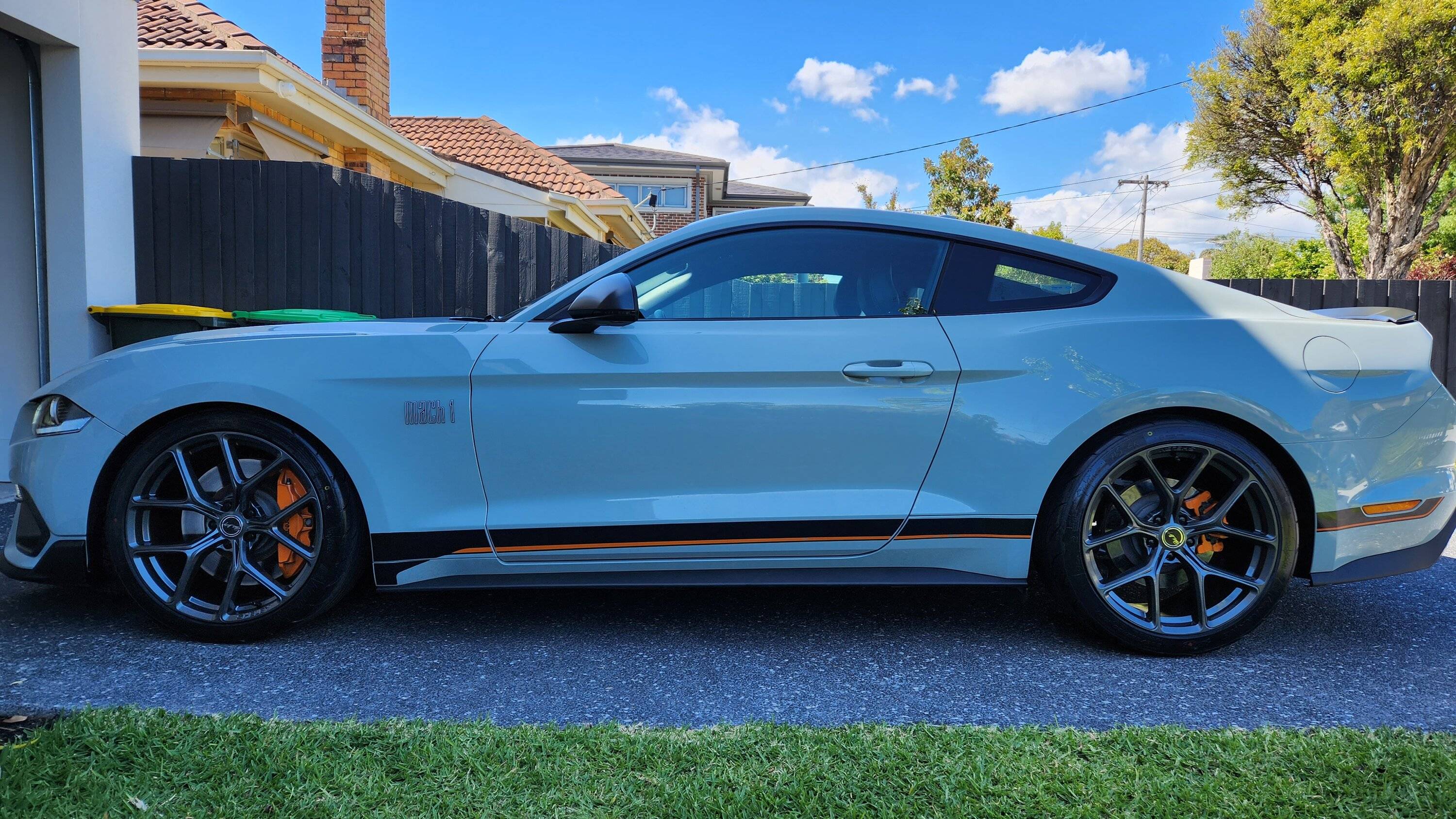

I'm running 265/35 and 285/35 on Steeda dual rate springs. Fits very well but you could go definitely go wider at the rear, I'm running semi-slicks and finding an affordable 295 or 305 was tricky. 285/35R20 is very similar to the 275/40R19 stock fitment. Running Nankang NS-2R tyres.
