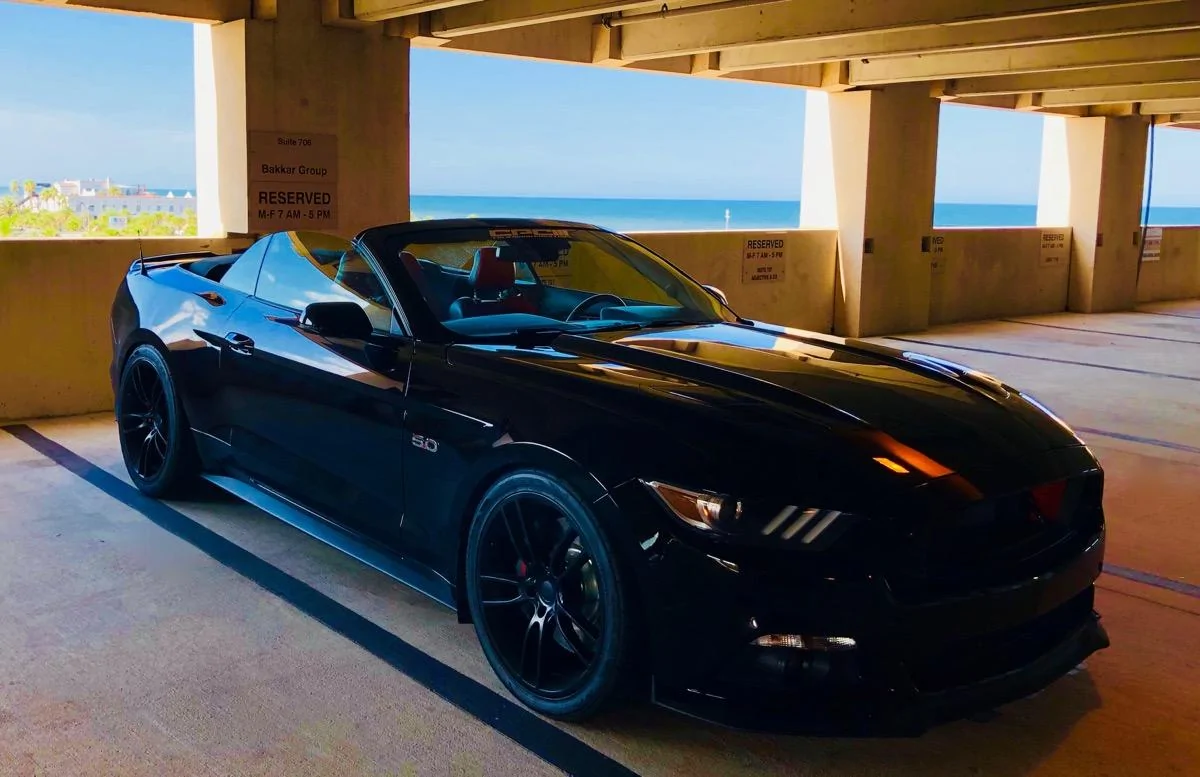

Just keep the overall height the same if you want to keep the same ratio, or if you want a little more/less, adjust the setup and use one of many online calculators to figure out your effective ratio - for example:
That's my stock and aftermarket setup :)
If you get a proper offset/backspace, you can tuck a pretty stout tire setup, not OEM inset, but nicely flush (very OEM-ish looking).
I just shot this photo over the weekend and you can see what a terrific fitment I have running a 305/35-20 rear and 285/35-20 front, lowered on BMR SP 080s, note that's also the exact same front-to-rear ratio as the stock setup, so no concern over stability control, etc., having any issues :) Wheels are 20x10 and 20x11 MRR M600s in a satin black finish.

Your setup looks incredible! I'll look into the calculator.
