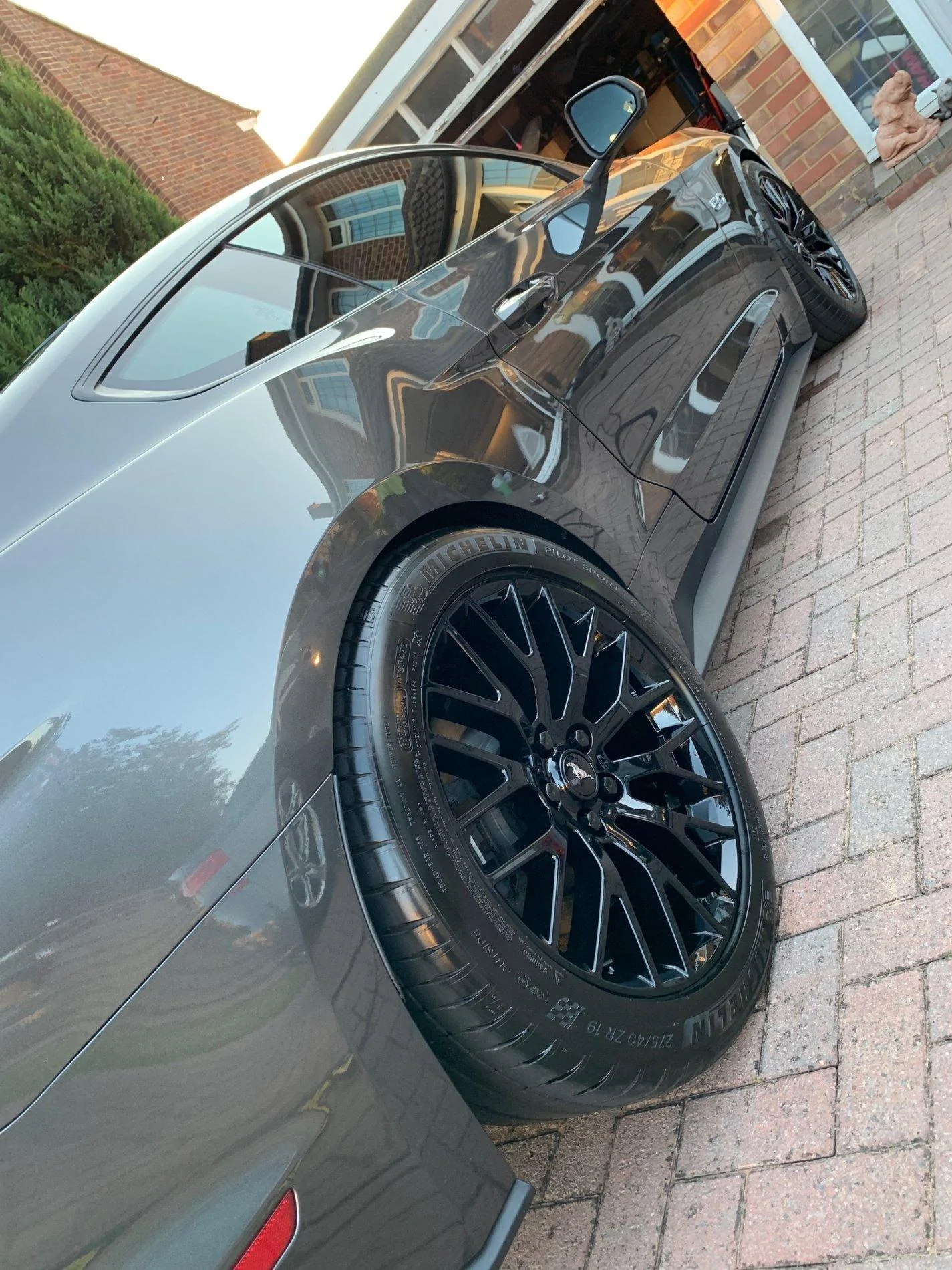

I use Adams Polishes "Tire & rubber cleaner", excellent for getting the rubber squeaky clean before applying dressing - I give the rubber a quick clean each time I do the wheels. For dirty rubber, the key is to keep doing it until the foam from the product turns white - as you scrub with a tire brush, this may take 2, 3, 4 rounds to achieve. You'll see this in a lot of the product videos. Willing to bet that on the first use, you'll find the suds go a yellow/brown colour! You would be surprised how much gunk the rubber holds on to.
Re endurance tire gel, I used to use this & whilst I loved it initially, after a while I found it to be very greasy, and "heavy" almost, to the point where I wanted to try something else (this was before I discovered rubber cleaning products!). I now use, and can highly recommend Adams Tire Shine - more of a liquid than the gel but a real pleasure to apply - with a foam applicator. Smells of banana too :) not quite as glossy as the endurance gel I would say, but I'm sure if you added a second coat it would be pretty close. Here's mine from my latest wash...
