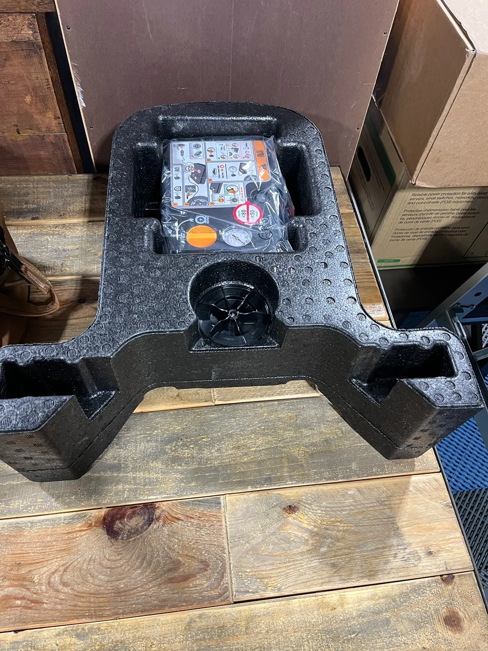

Personally, I have a spare AND a compressor.
If my spare is down on air after being in the trunk for years, I can air it up.
If I find a puncture that leaks slow I can air up that tire so I can get to the tire shop or a more convenient place, instead of futzing with it on the spot.
Those flat repair compressors are perfect for my use. Small enough to lose little space, big enough for the what I will need it to do. I dont use the slime, just the compressor.
EDIT: I do toss the foam carrier and just tuck the compressor itself in a corner of the spare tire well.

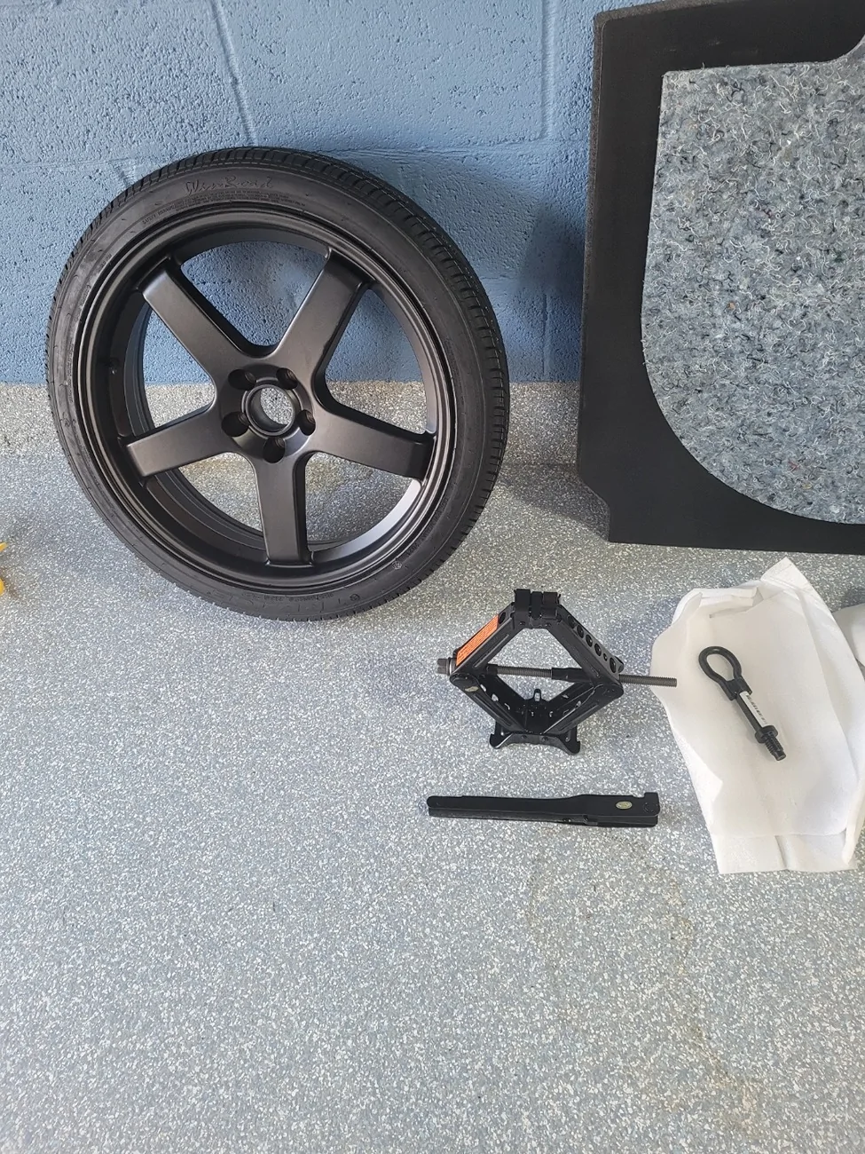

I carry...

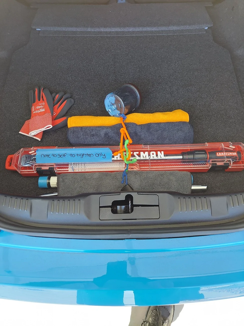

- AA spare tire, torque wrench, breaker bar, lugs for OEM wheels, small scissor jack
- Jumper cables
- The small white Ford funnel (check your trunk), for refills from a can, if needed
At the time I placed an order for an AA spare, they sold more than one size. After the order was placed and before the kit shipped, AA reached out and confirmed the tire size in use. AA realizes many of us have switched to aftermarket wheels and tires.
If you have any questions, e-mail AA to discuss before ordering.

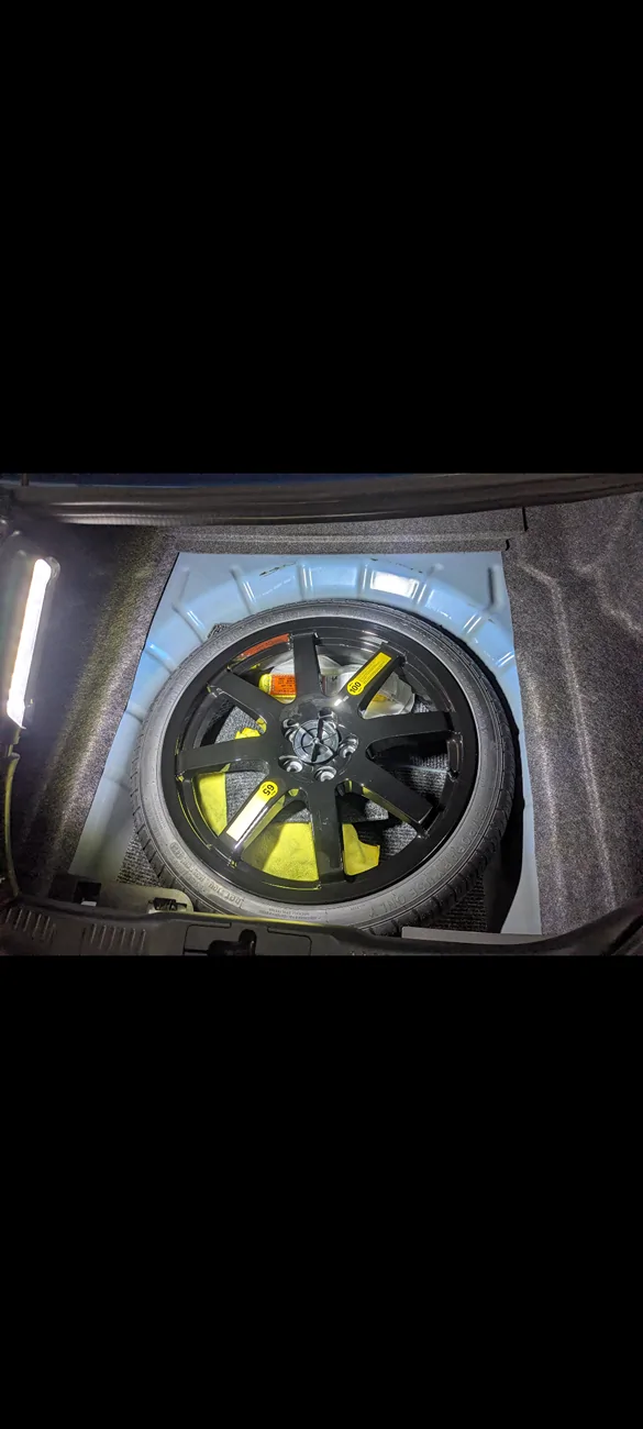

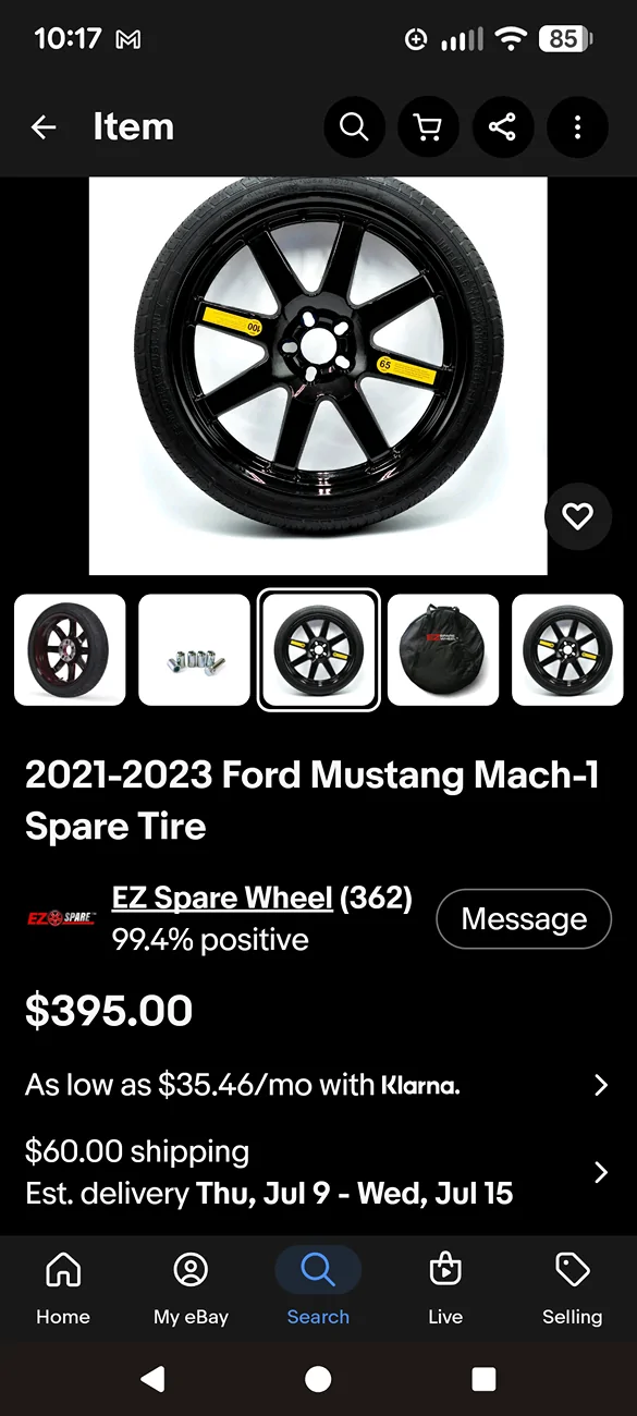

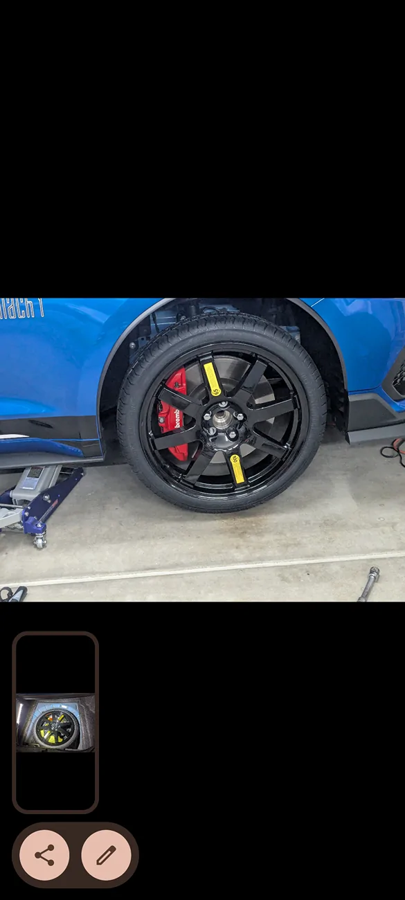

I purchased this and removed the inflation kit , the spare fit no problem. I also purchased a Ford S550 sizzor jack off eBay, and Harbor freight breaker bar and sockets.

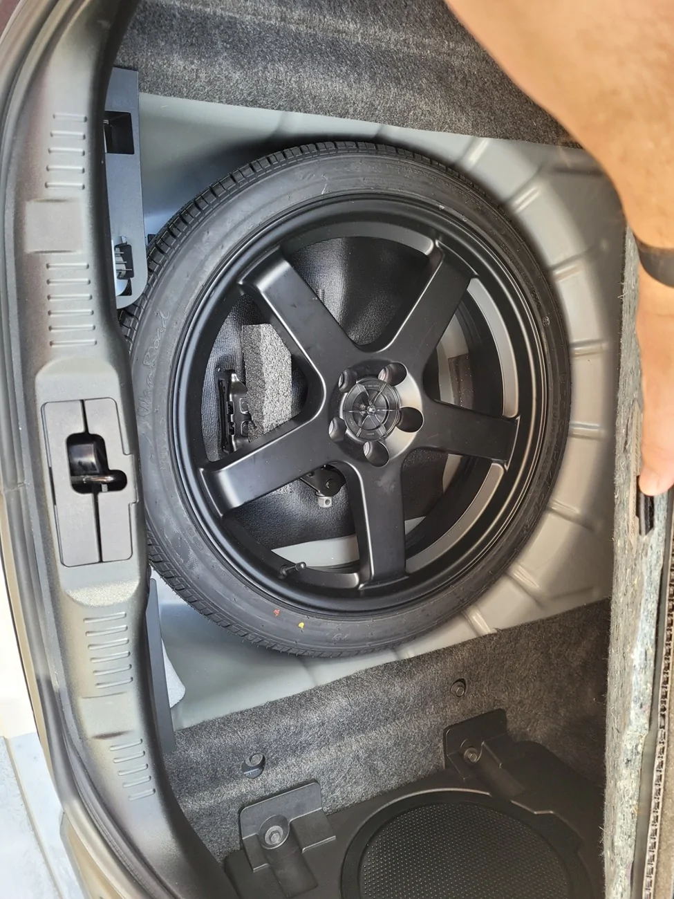

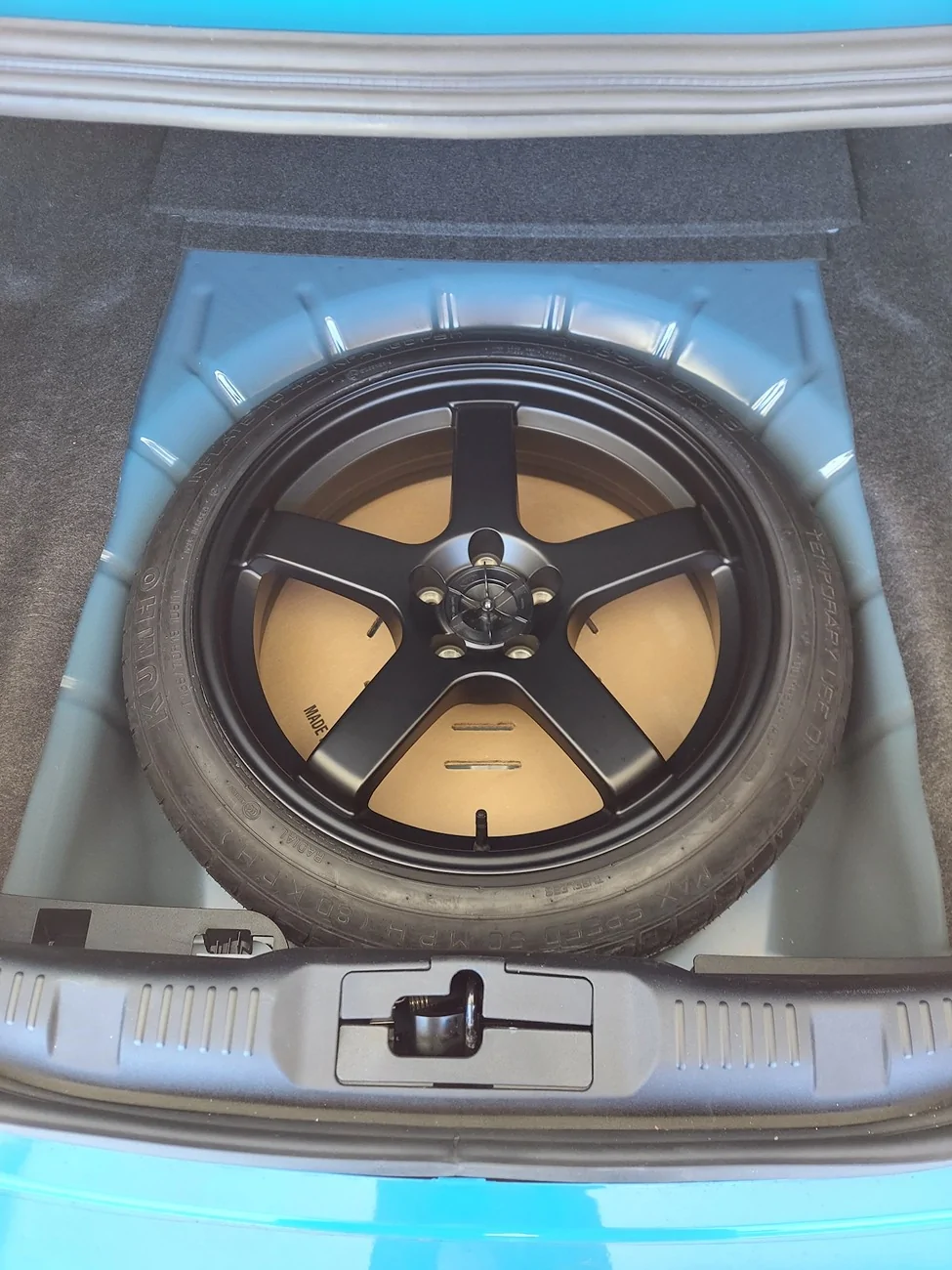

I have the AA spare kit. Luckily have not had to use it yet but likely easier than dealing with making sure i get towed by a flatbed and they have ramps so the front of the car doesnt get destroyed. I later added a piece of matching carpet fabric on the bottom first. No noise or rattles. The spare tire cover sits totally flush.
