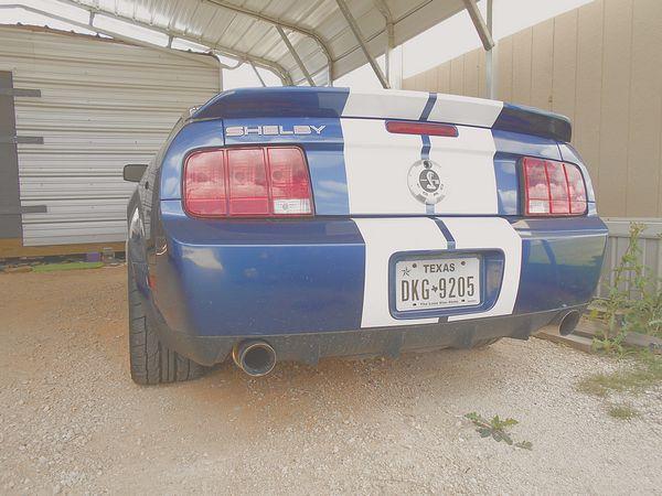

PP wheels are 19x9" I believe. So, 275/40/19's will help your gear and as to brand= budget? If $200 a tire is ok Continential has a new tire just out that is as good as Michelin Pilot SS if not, do the BF Goodrich sport comp 2's. Here's the new Nitto's on my buds GT 500.
