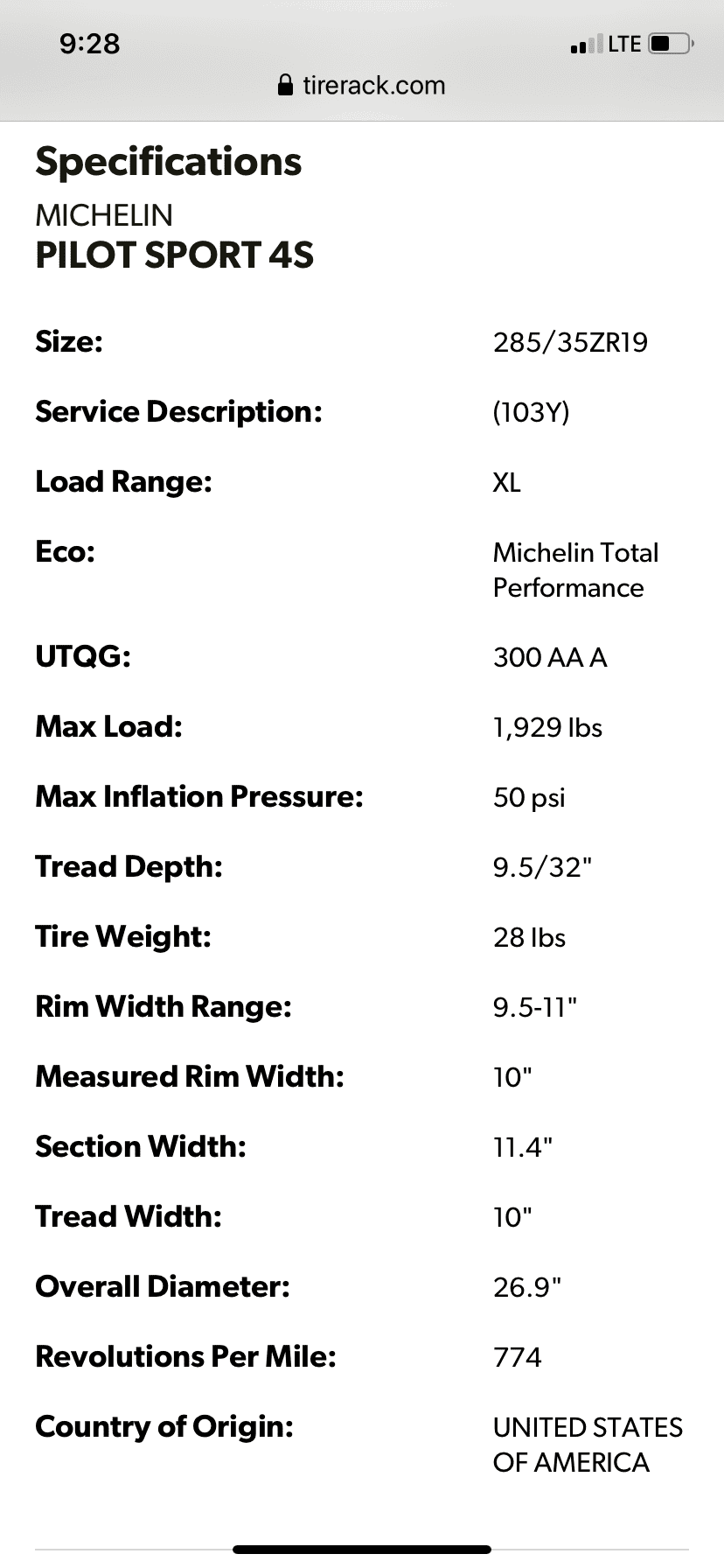

Thanks for the pictures, those look nice. Would I have any issues with the stock wheels being different in size? (19x9,19x9,5)

Yeah the 285/35R19 is too wide for a 9" wheel according to Bridgestone. (9.5" minimum wheel width)
You could run a 275/40R19 on all four corners tho

Would running 285s or 275s on all four wheels be dumb since the wheels themselves are not the same size? I was looking at the sve 350r wheels and i could just go 19x10 and get the 285 set up. I just really like the way the stock wheels look. I am also kinda against spacers so I would have to make sure I dont need those. Thanks again for all the help

According to TireRack the 285’s would be to big for the front. A 275 looks like it would work on both ends. Not sure how it would look on a 9” wheel.

Yea, I looked at a bunch of other posts and it was saying that 275 is the max for the fronts. I actually ended up ordering 275s for all 4 bc the 285s wouldn’t ship till 7/6. Tirerack did actually stop the order and make me confirm that the 275s would fit up front.
