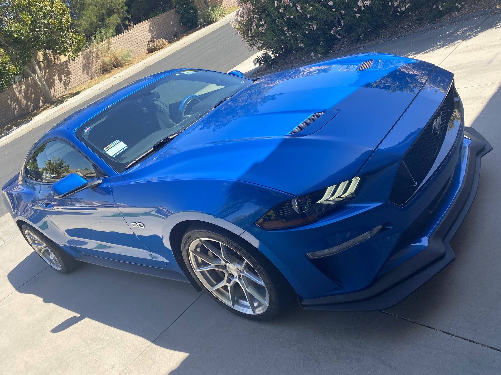

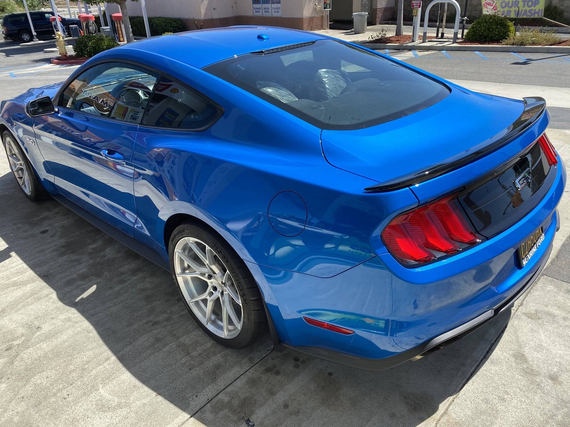

Biggus Dickus
Mar 25, 2019
66
1,694
1,679
San Bernardino County
G
BMW M2 Mustang GT, MME GTPE
305/30 19s F (10s) and 315/30 19 R (11s)
