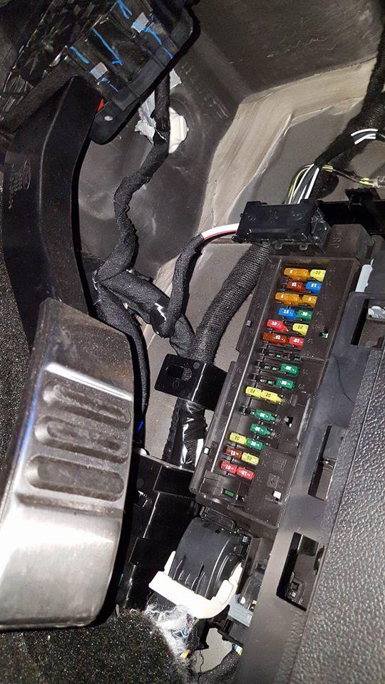

Euro/Aussie cars apparently don't have an "always-on" fuse, which by memory is Fuse 2 on the interior.
So the only way to get the Parking/Surveillance mode active on the camera (after the ignition is off) is to hardwire directly.
Any tips on getting my Thinkware dashcam wire from the interior to the engine bay fusebox? It's more or less similar on the interior, apart from RHD/LHD of course.

My 2017 UK RHD GT does have an always on fuse. I use one with my power magic pro. Have you tested 2 and found that it doesn't work? Mine is tapped into 2 and 23 for live and switched respectively.

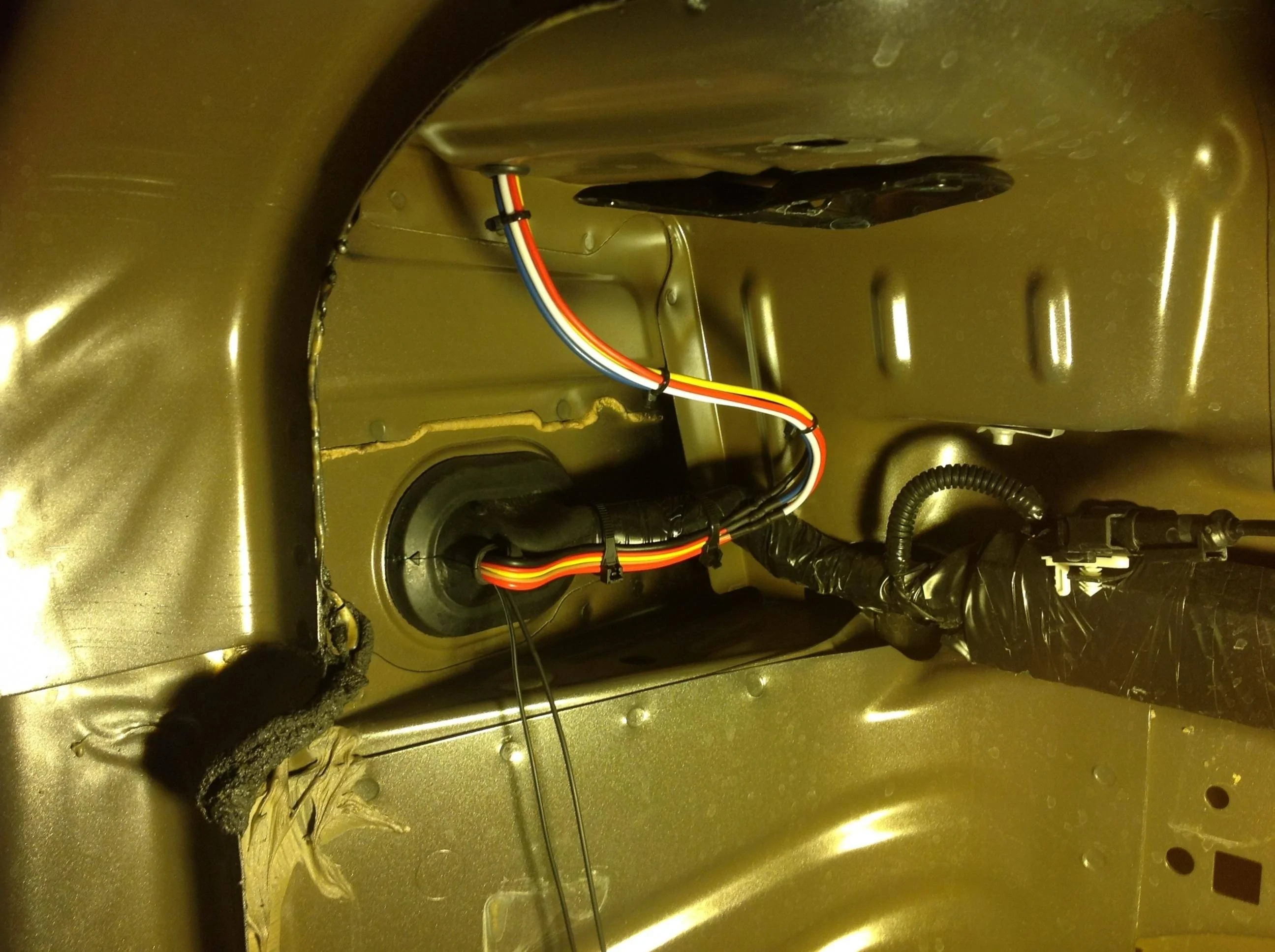

You have two choices (one in either fender well). Remove the pins holding the fender well lining and you’ll see a large oval rubber plug in the firewall with wiring harnesses passing through them. On each of those rubber plugs, is a single nipple. Take a razor blade and male a slit on the nipple or cut it completely off if you have several wires to feed through. Fish the wire through using a straight section of a coat hanger With the wire taped to it.

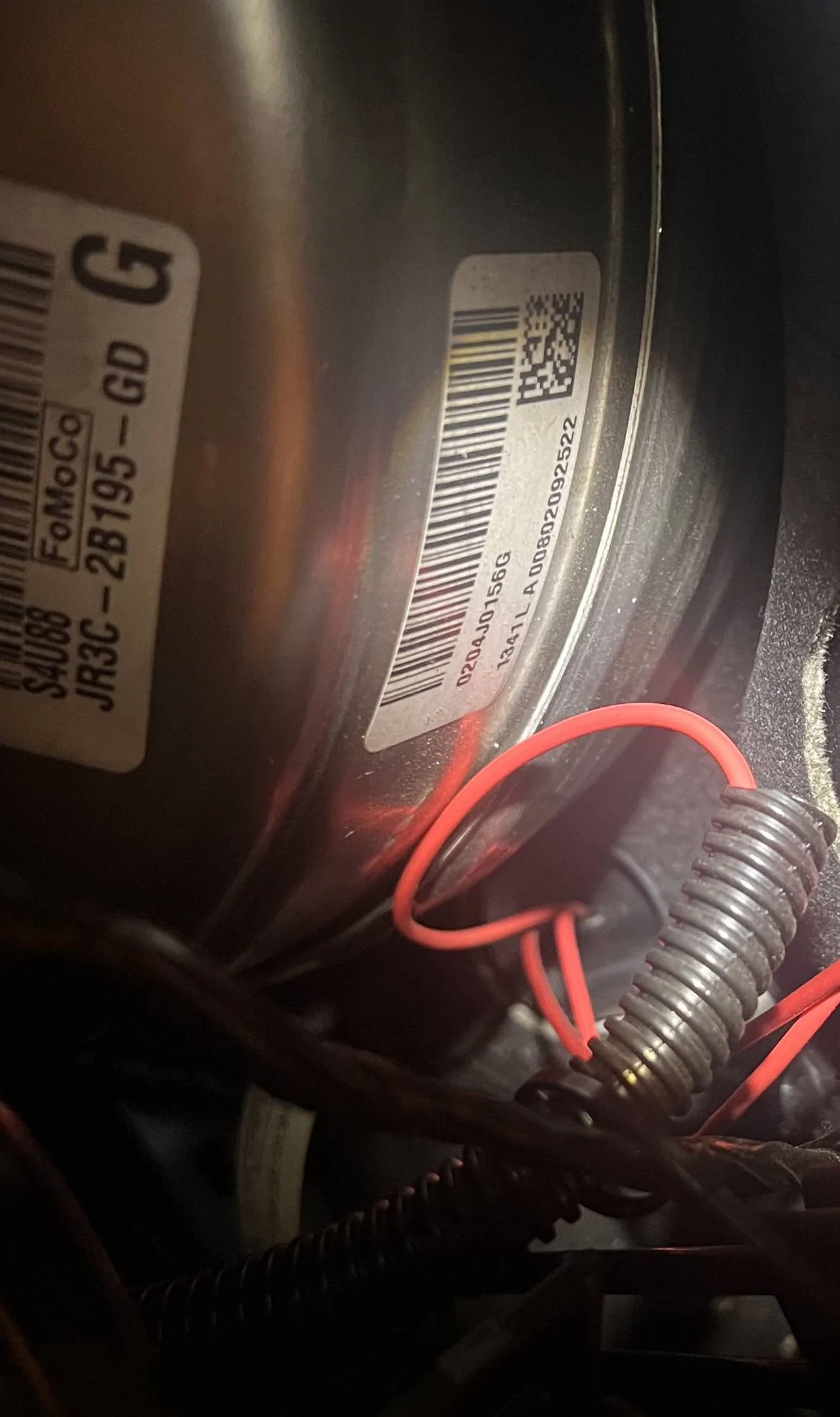

I use the grommet next to brake booster on firewall for my aftermarket line-lock wires.

@mellda here is a better example of how I passes wires from the passenger side fender well into the cabin. You can probably get away with removing the liner and turning the wheel, but removing the wheel and liner would allow you to work more comfortably.
