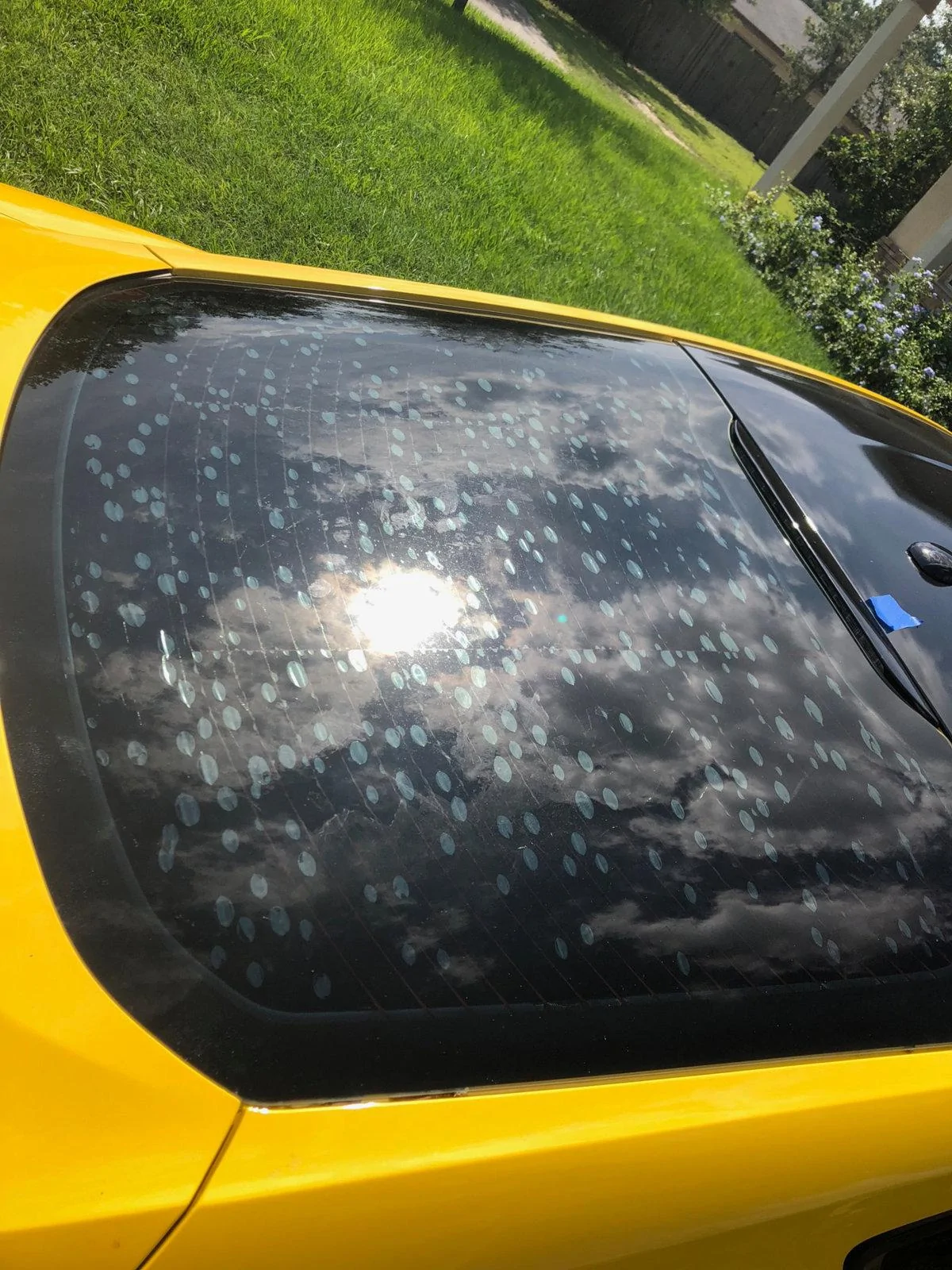

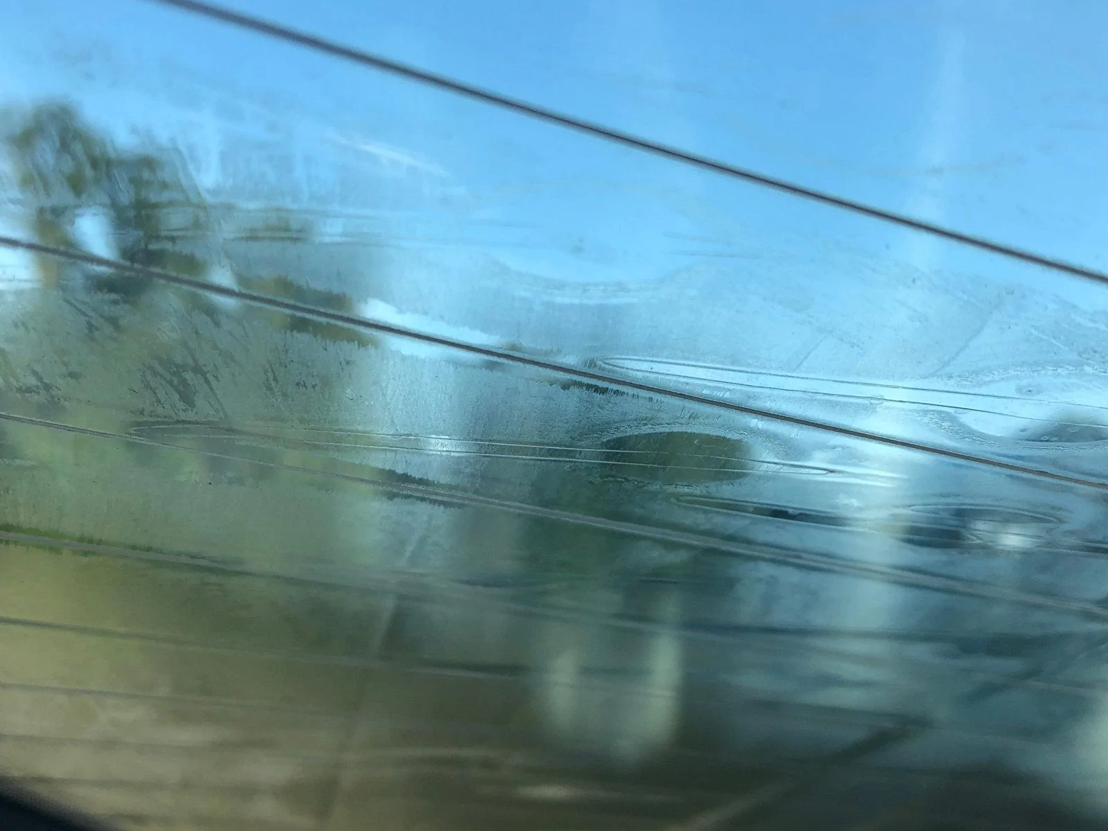

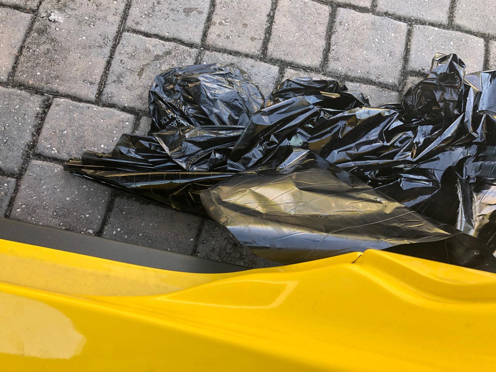

I used Simple Green and black trash bag + sun method. Worked well to remove tint without damaging defroster lines. A lot of glue was left over, so I went at it with a Scotch Brite Non-Scatching Dish Pads and dish soap and/or more simple green. Took a good hour and a half of scrubbing in the 100 degree heat. Just be careful to not scrub the lines themselves too hard. Most of the glue dissolves under light scrubbing with the cleaners.
Black bag method:
1. Get black garbage bags (non-scented).
2. Wait until hot day (preferred) or you will have to use your heater to raise interior temp pretty high.
3. Cut bag open at seams
4. Spray down back window on OUTSIDE with water
5. Lay bag onto back window from outside. Trim bag to size (don't cut your paint or rubber gaskets)
6. Lay towel on back decklid/seatback (Simple green damages leather)
7. Spray inside of back window with Simple Green
8. Lay bag onto inside of the rear window so it sticks to simple green. Spray more as needed.
9. Close all doors/windows and let it bake in the sun for an hour, checking on it half way thru to add more simple green if needed.
10. Start peeling the tint from one corner and go slow. Tint should come off with the bag to prevent it from breaking into strips.
Search youtube for some videos if you need visual instructions.

Dogiebitt hit it right on the head - and it’s the best way of removing rear window tint from ANY vehicle, not just an S550. I belong to many auto forums and have seen this method WORK for years; as he has stated, when removing the glue, you want a type of pad that won’t scratch the glass and won’t wear through the copper grid lines.
Just words of recommendation that I haven’t seen mentioned:
Cover the rear carpeted deck and seats with something that will not allow any type of liquid cleaner to seep through to those surfaces. The last thing you want to do is start removing tint and then come to find out that the liquid you’re using has now discolored or stained those areas.
