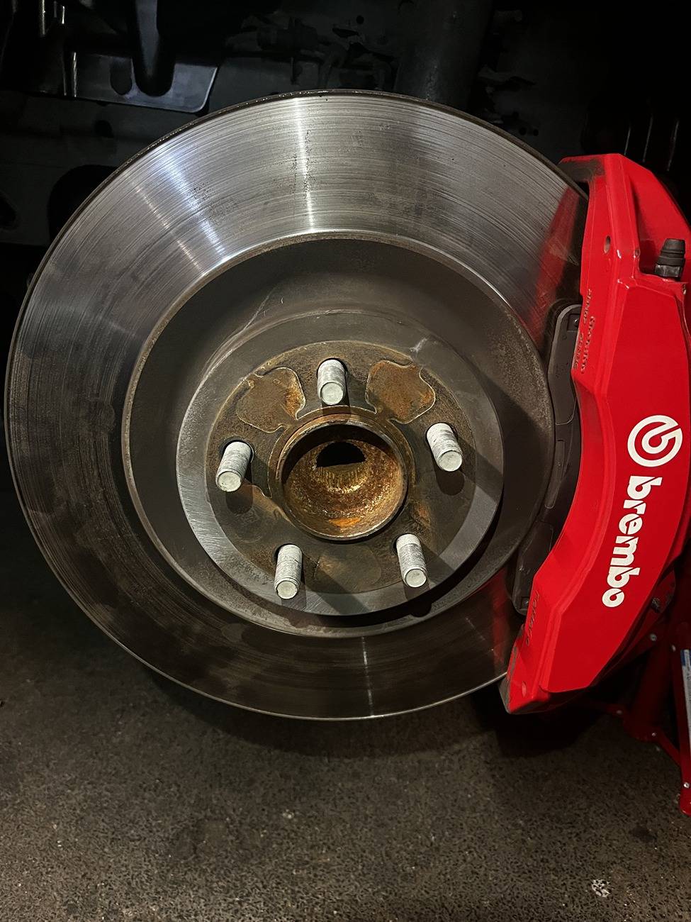

My 21 GT is a DD with 63k. While doing my winter tire change over today I did a quick brake inspection and the pads are getting thin. All four rotors look fine with no visible wear so I’m thinking just replace the pads only. In the past I’ve always resurfaced/replace the rotors due to a metal on metal condition. I’m not concerned about the cost to replace all four rotors if needed but want to hear what experts think if it’s necessary to replace them.

I'd just replace the pads. The rotor surface looks good. Turning them may help bed the new pads but rotors aren't necessarily made with enough metal anymore to do that. I'm not sure about stock Mustang rotors. Its something to learn about.

People say to turn them. I’ve just replaced pads multiple times with no issues if the rotors look alright

Mine were resurfaced around 61k (prior to my ownership).
It would be annoying to have your new pads still be good but then have to replace your rotors at some point midway through your new pad’s life.
Go blanks or slotted only - not drilled, IMHO.

Unless you're financially constrained I would just replace the rotors while you're in there.
At 60k I may even swap the calipers and soft lines and inspect the parking brake.
Maybe overkill but I like knowing I won't need brake work for a while.
You would be just fine to swap pads only, they should bed no sweat.

get yourself a rotor depth gauge and measure them first. The minimum thickness should be stamped on the aluminum hub and it should be 34mm front and 24mm rear (source).
For comparison, here are mine at 73.000km:

Hello; Beat me to it. Measure and only replace/turn if having a problem.

Those show more wear than the OP's do, and I'd replace them when the pads are ready. Nice example!

Ford rotors are amazing they don't seem to wear. I would keep them and just bed the new pads in with several 50-0 hard braking (abs activated) per standard break in procedure or that specified by the pad MFG.
I want to get 2 piece rotors when the brakes need changing. Now at 40K miles and they look like will last forever with frequent hard barking I do .8-1.05G.
Just get new Ford pads. Ford rotors are Quality Job #1.

Hello; There are reasons to replace rotors. One is if they are warped and causing a shutter/vibration when braking. If the rotors are thick enough they can be turned some to remove some of the surface and true them up.
Another is if they are indeed too thin from excess wear. Does not seem likely with under 70,000 miles. However, the thickness is easy enough to check. Replacing rotors which run true and have good thickness is a waste of money.
