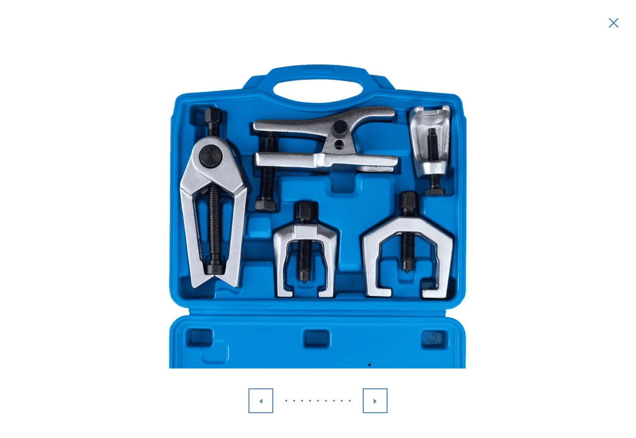

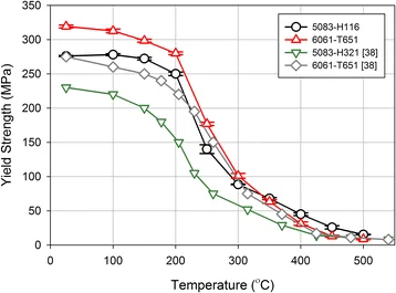

Personally, I never use heat on suspension parts because I worry about changing metal properties with heat on critical components. I never use heat on aluminum because strength drops off dramatically at fairly low temps sub 500F.
I always use the right tools on suspension. I must have 30 hammers for all sorts of jobs but rarely is beating suspension parts with a hammer the smart ploy regardless of how many YouTube videos show pros doing it. I also never use a pickle fork if I have alternatives.
What you need to do the removal job right with no damage and no use of force are tie rod and ball joint removers designed for this purpose. Even this cheap set from Harbor Freight or available all over the web will last forever. Many local autoparts stores will rent them for FREE!
