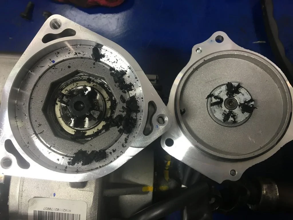

Anyone else’s steering wheel make this noise when you turn it? I’ve looked it up but keep seeing threads about turning the wheel and a noise coming from under the car, this ticking is 100% coming from the interior. Is this normal? If not, what’s causing it?
I bought the car new and it now has 2300 miles on it, it’s been making the noise since day one. Didn’t think much of it when I picked it up but I’ve been starting to feel that somethings not right with it.

A few things I forgot to mention:
The wheel isn’t loose at all
My turn signal stock functions perfectly fine
The steering feels completely fine
Drive modes don’t affect the noise
Temperature doesn’t affect the noise
I haven’t taken it to the dealership because if it’s normal or a simple fix I’d rather not go through the hassle of dealing with them. If it turns out to be a complicated issue I’ll take it in

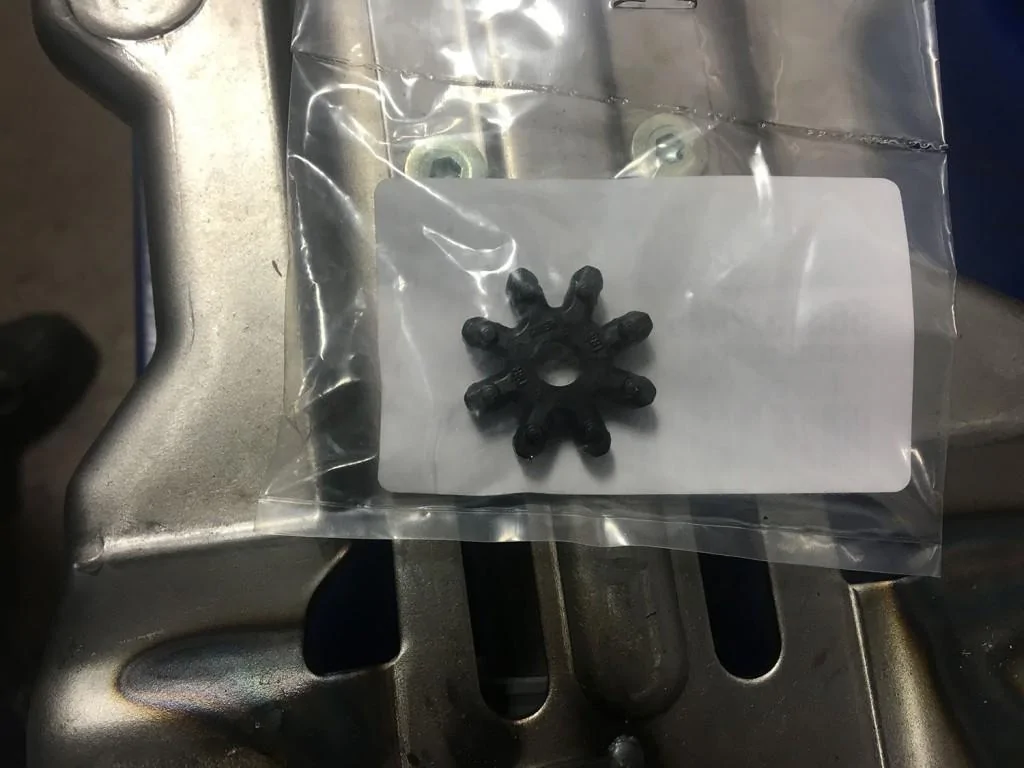

I have seen this many times on Hyundai Sonata’s.. the issue was a $2.00 plastic fleixbile coupler... about a 2 hour repair.
I am guessing something very similar is your culprit.
