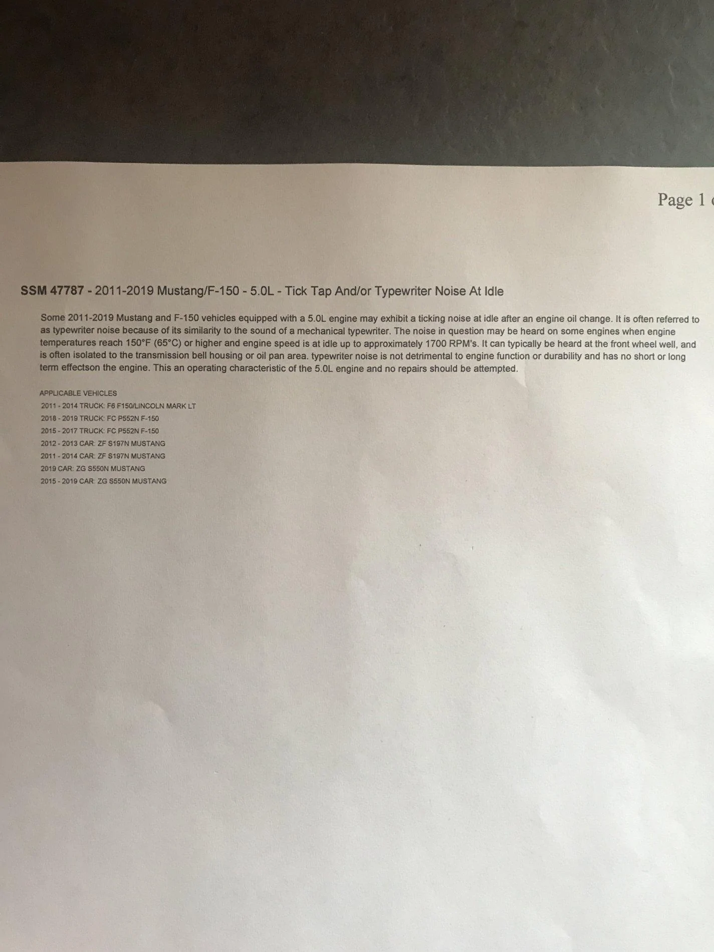

I have the same typewriter tick. Took it to the dealer and they said it’s normal. They gave me a copy of the SSM from ford saying it’s normal too. A lot of people on here have it as well. No source has been found yet.
