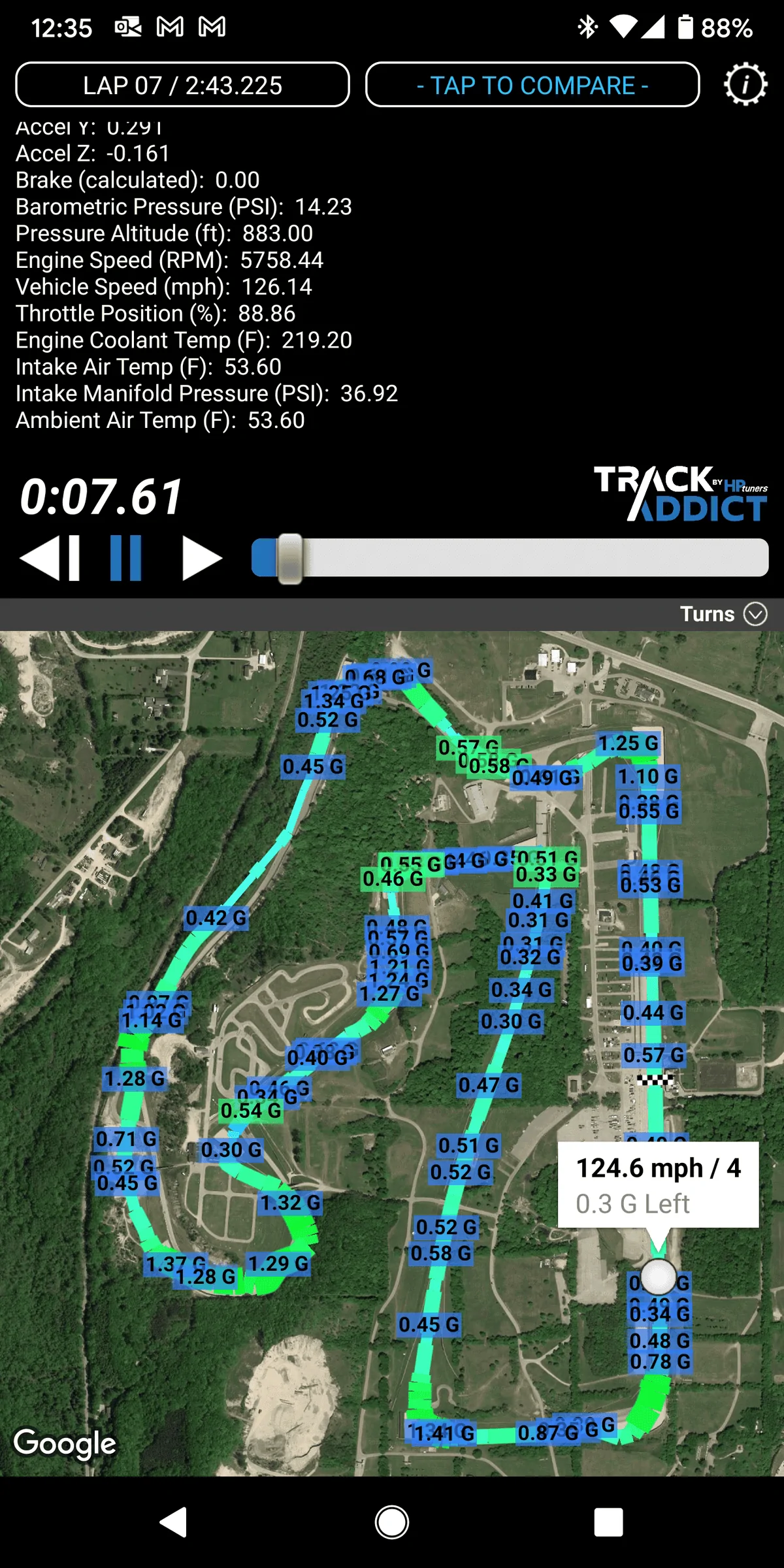

Here's screenshot of the Track Addict app at Road America. As you can see, the stock motor, with only a larger intercooler, is capable of producing 22 psi boost at almost 5800 RPM (Note: The manifold pressure is shown as absolute, so you must subtract 14.7 from the 36.92 to get boost pressure). It starts falling off above 6K RPMs, in my car.
Yes both our statements are true. The stock turbo is capable of 22psi at 5800rpm, and also not able to hold it to redline.
Yeah, so Coyote Chase's issue of boost falling off above 3-4K is probably not related to the stock turbo. Might be the Turbosmart wastegate?

hows the video export going 🥰
It's not, sorry :(
Actually, the video I have from the most recent Road America track day on 4/29 is not all that interesting. There were only about 55 cars there in total that day. There were laps where I didn't see another car for the entire lap. Obviously, that was good for the most part, but you just see empty track in front of you.
