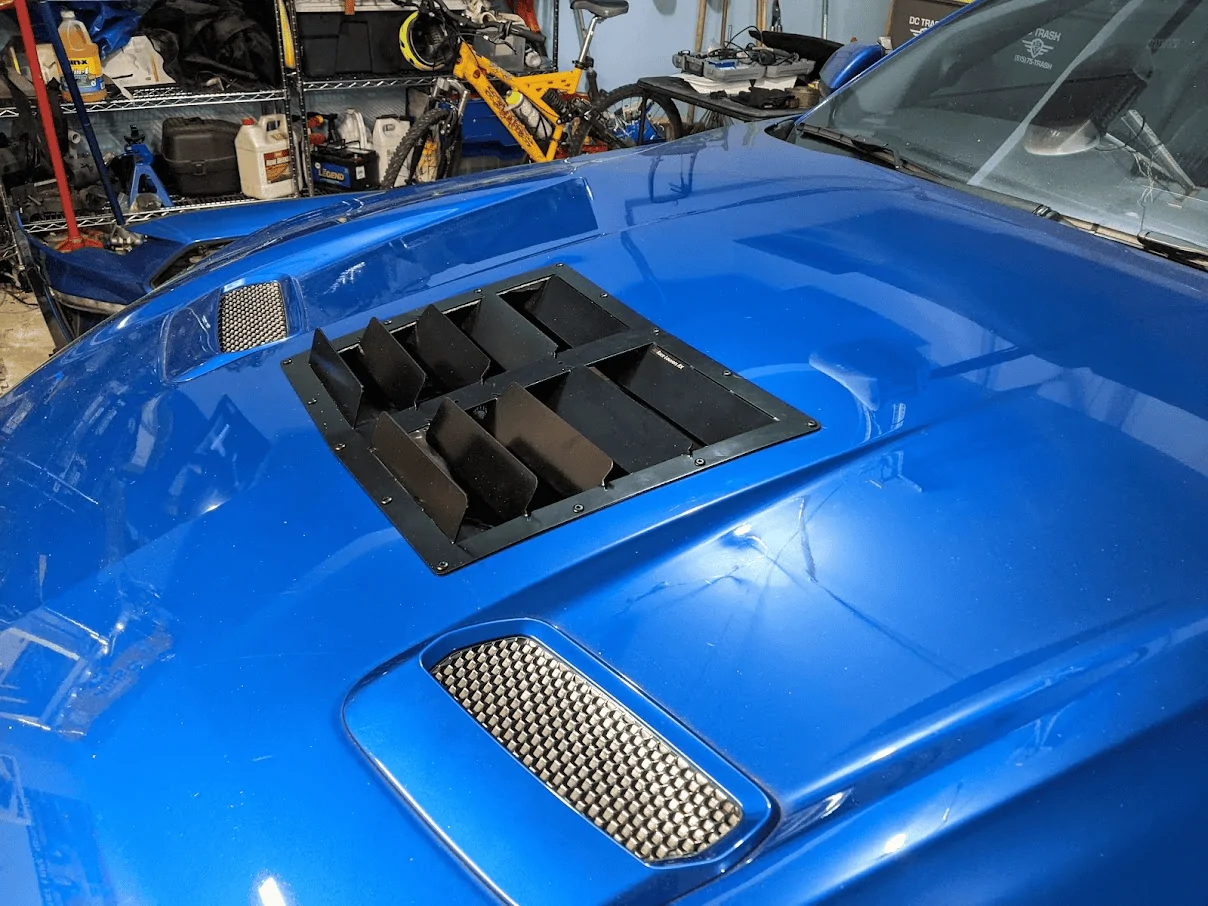

Yes, I think the hood vents helped. Unfortunately, I only got one decent day to run, and the ambient temps barely broke 60 deg. Before the hood vent, I had to short shift (5300-5400) to keep temps down (e.g., to keep coolant under 240 deg). With the vent, I could comfortably shift at 6K, and the coolant temp never broke 220, with actual oil temps in the 240-250 range (the factory inferred temp still climbed to over 280, but that will require a software edit). Top speed is very consistent around 128 mph. Max lateral Gs were 1.54. Here I am coming out of turn 7.

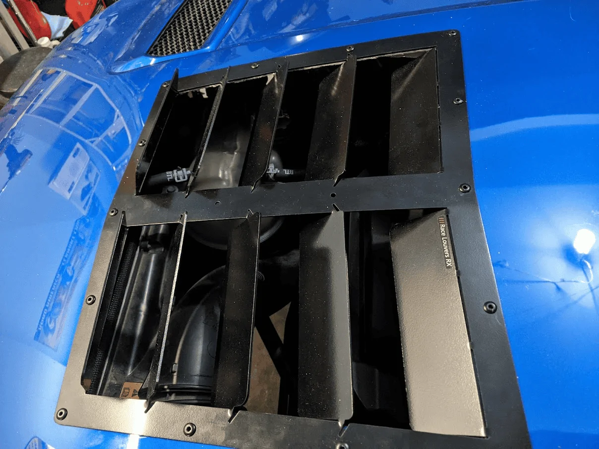

You have a really nice looking Mustang! Can you post an up close picture of your hood vent?
