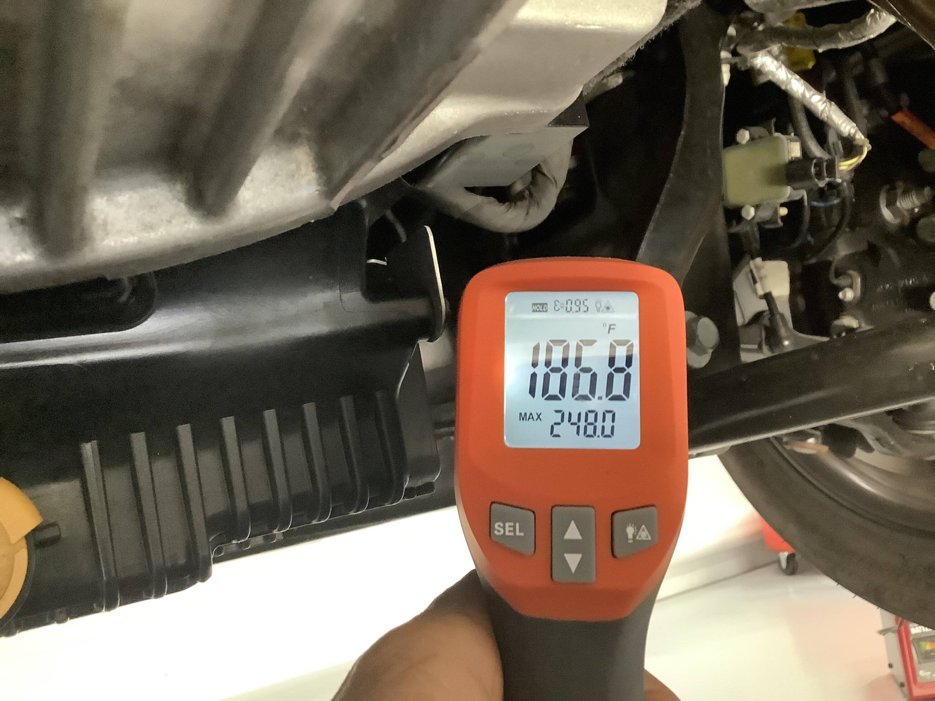

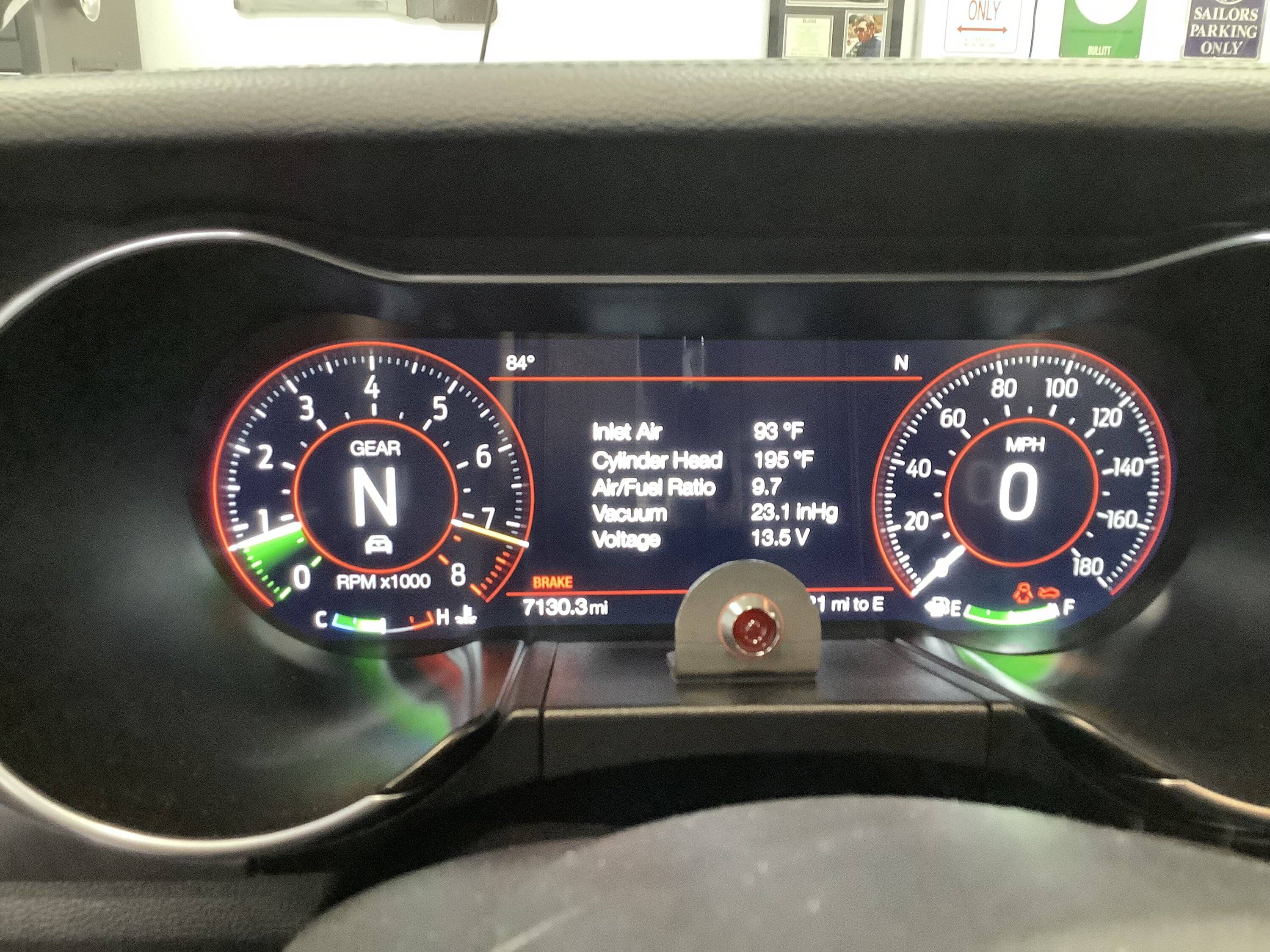

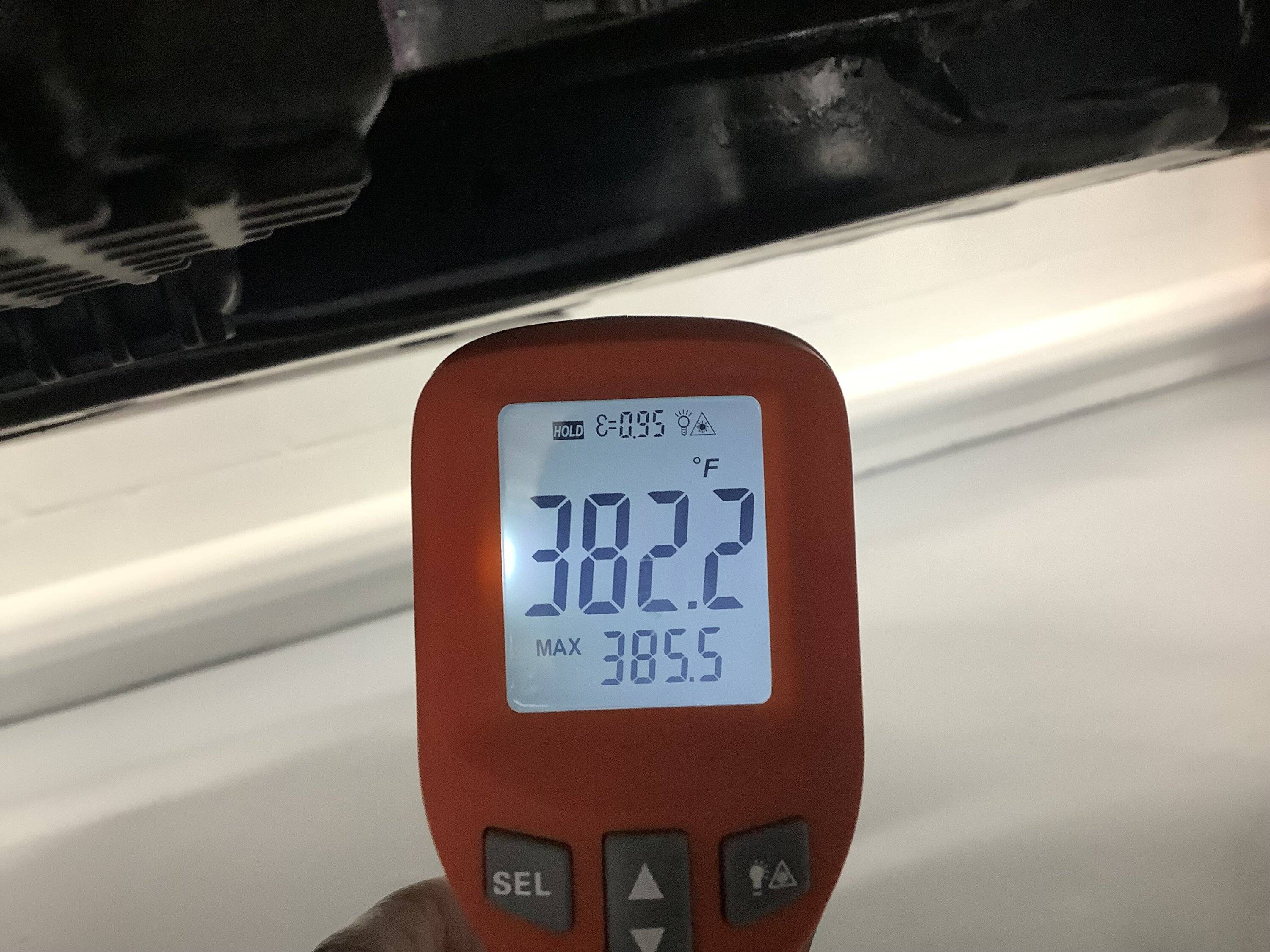

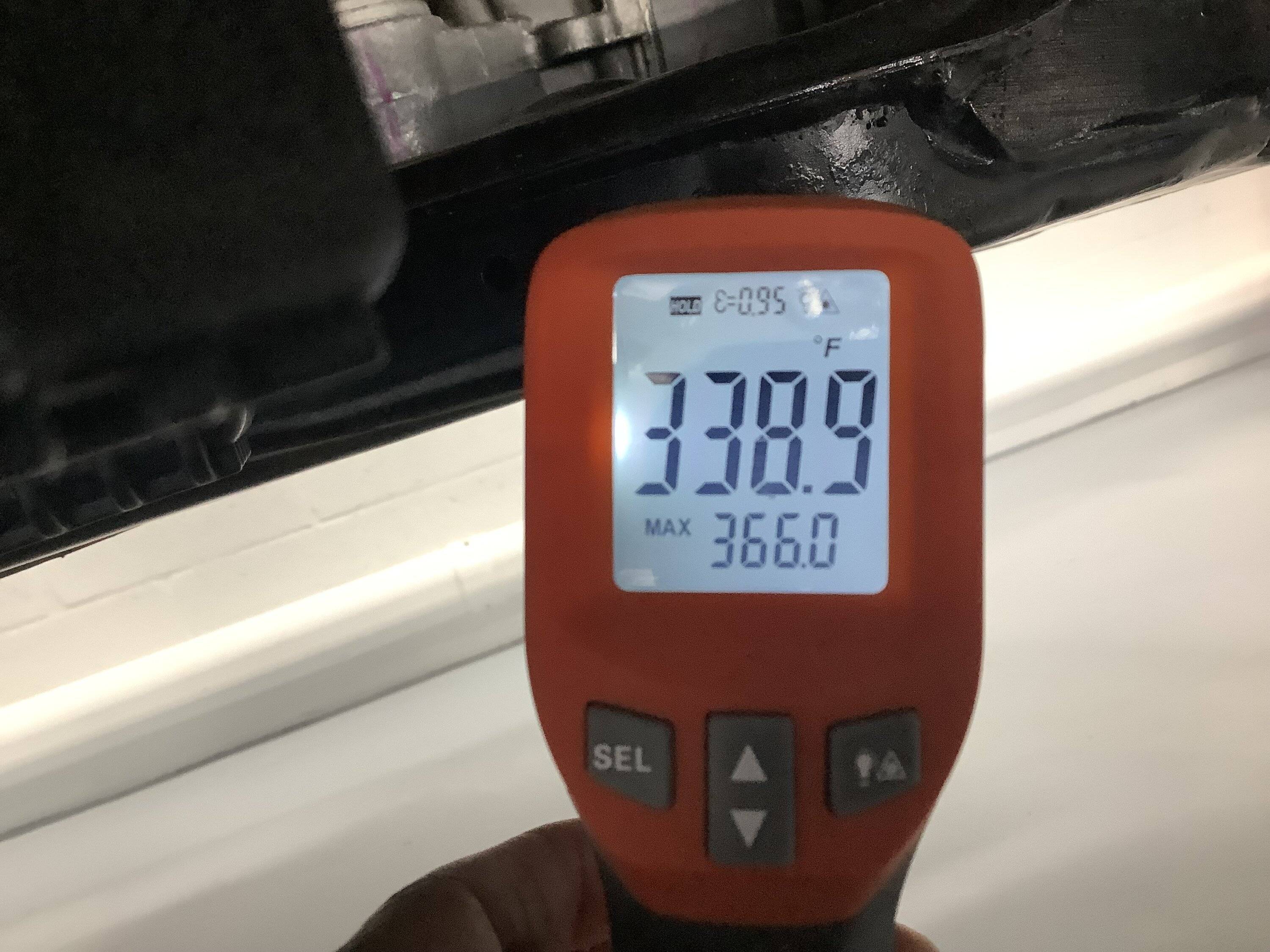

Okay, here are temp readings taken from the #4 primary.
Pic #1 - 1” back from the header flange
Pic #2 - 6” back from header flange
Pic #3 - At the o2 sensor base on the collector
Pic #4 - Cylinder head temp reading on dashboard
