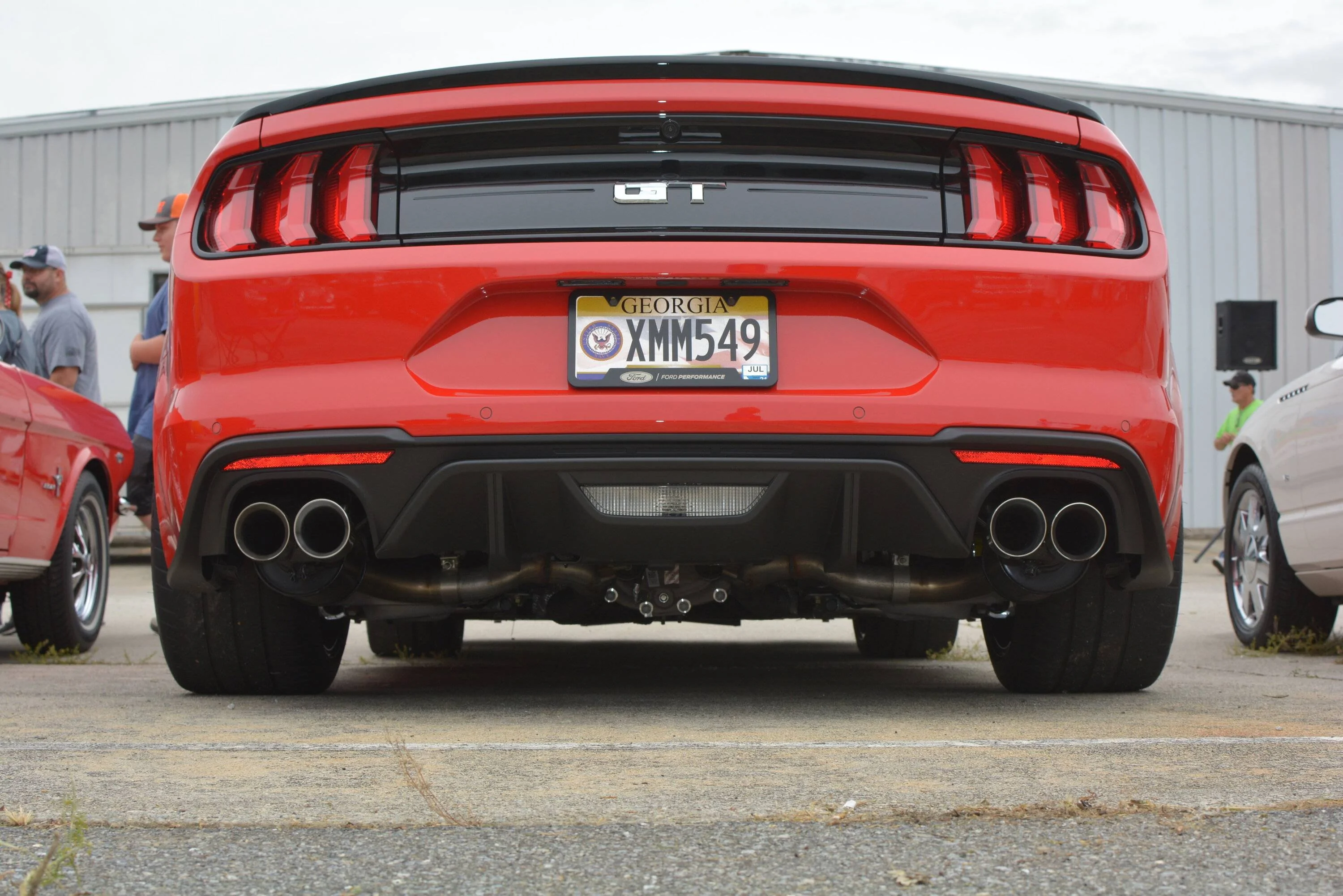

Not to pound on the OP but WHAT did he expect, modes?
Boosted
LTH
Suitcase delet,
X pipe
Roush Axle backs.
What can I say, got what he paid for, sometimes dreams and reality clash, and reality always wins?
As to Roush Axle backs are loud, and not fitting" the way it sits in the rear valence."
I will address both, Roush has IMNSHOP the best angry, crisp, aggressive pitch out here.
I have low rumble in the 34, roll cam, stroker V8, that's what I think the Mustangers are shooting for .... never happening.
5.0 coyote is a different animal, sound and pitch reflect that. Something to be celebrated :champagne:
Next, the way it sits in the rear valence, please point out what you dislike
I am inclined to believe your dislike is with the installer and not ROUSH.
Enjoy your hotrod build sounds tuff, more than enough power for the street and car show (car shows whoopie) scene.

I was fully expecting this but had (some) hope it wouldn’t be too crazy. Honestly the install is probably what is was more than the exhaust because it sits lower from the rear valance than yours. Loved the sound prior to LTH but damn it’s too much now.

Hear ya,
