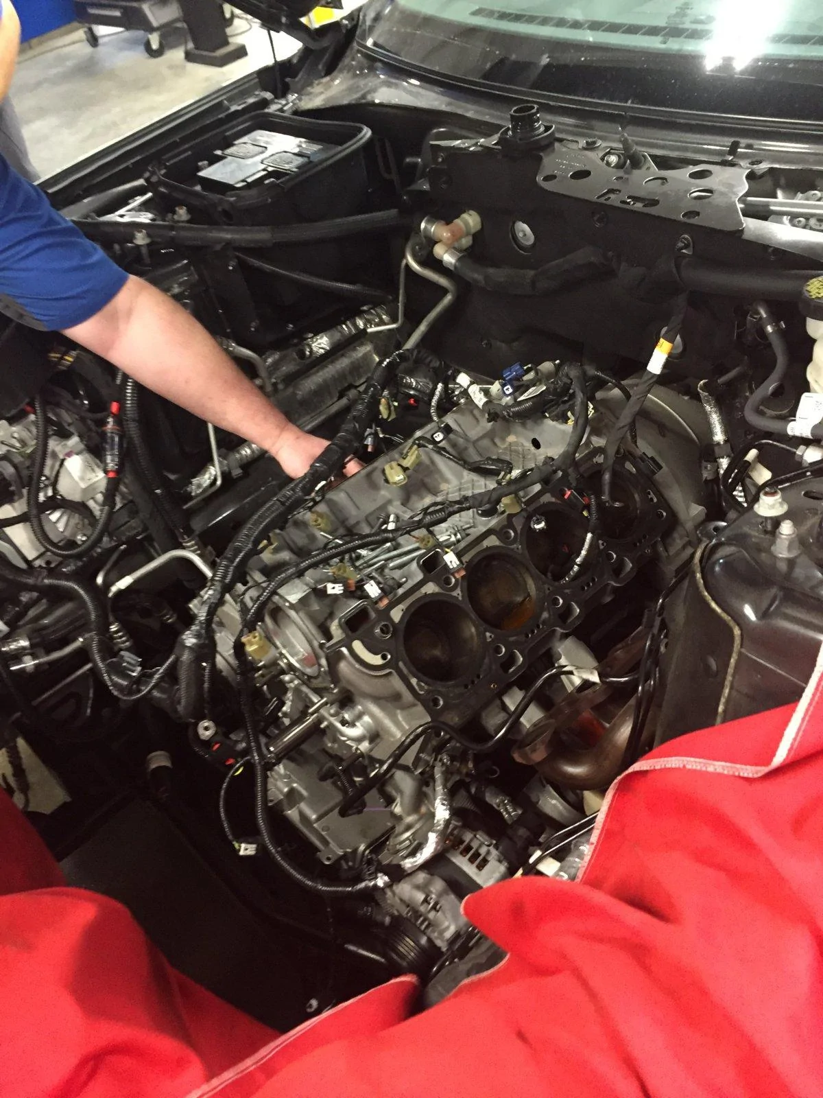

Just had my 2017 GT returned to Ford from me hearing the alleged "BBQ tick". Dealer subsequently determined to be a snapped rod. No loss of power or anything, just heard a weird tick. Options from Ford were to wait on a short block (on back order), Ford buy it back, or replacement Ford vehicle.

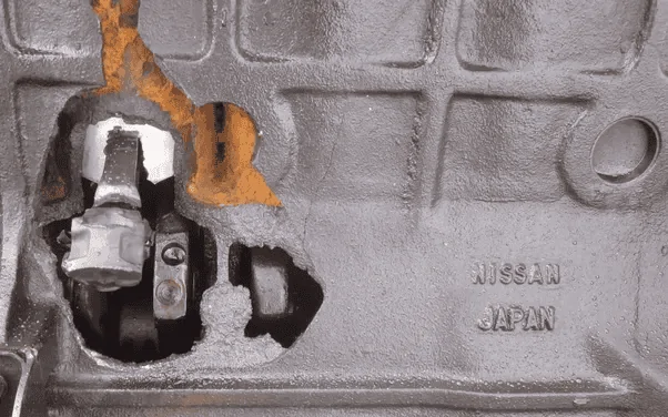

Snapped rod? The engine would have gernaded if a rod snapped.
If I zoom in on the photos it looks like the crank journal surface is a bit "smeared", and the bearing shows some streaks.
@Semnole - if they still have the motor apart, ask the mechanic to measure the rod side clearance on all sets of rods and also the crankhaft end play, and report the measurements.

Where is the snapped rod? I don't see anything but normalcy in those photos.
Those pictures were texted to me right after I dropped it off. They had to get further approval from Ford to diver more into the engine. I am just relaying what they told me towards the end of the RAV process. It could have been something else but just telling you what they told me. A new short block was on option for me if I wanted to wait but did not.

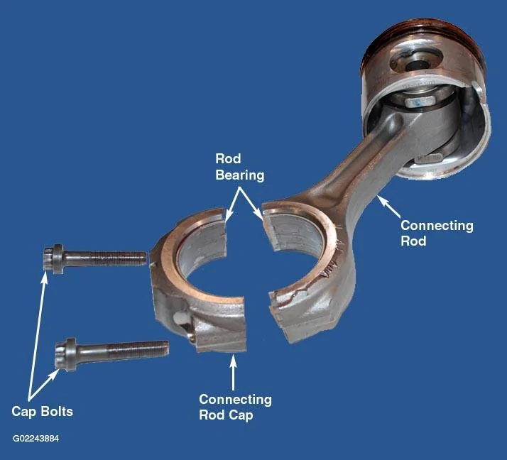

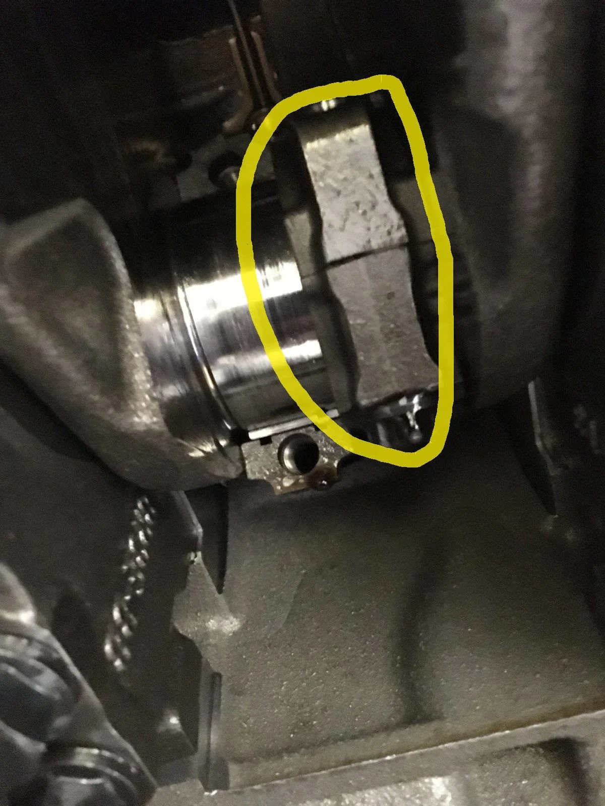

If you look at the picture OP provided, you can see the crack towards the right side of the center of the screen. See below for clearer description:
Now, look at his picture again. See that flat spot that is cracked? It is the connecting rod cap/rod bearing. When mechanics say "snapped rod", it usually refers to any part of the assembly that is cracked.
Hopefully this helps.
Now, look at his picture again. See that flat spot that is cracked? It is the connecting rod cap. When mechanics say "snapped rod", it usually refers to any part of the assembly that is cracked.
LOL! Are you talking about the alignment tang on the bearing?
No mechanic says "snapped rod". They are "thrown", "broken", or "bent". All of which result in extensive damage to the block and crankshaft.
Now, a spun bearing can cause damage to only the connecting rod and the crankshaft, but that bearing is clearly not spun.
