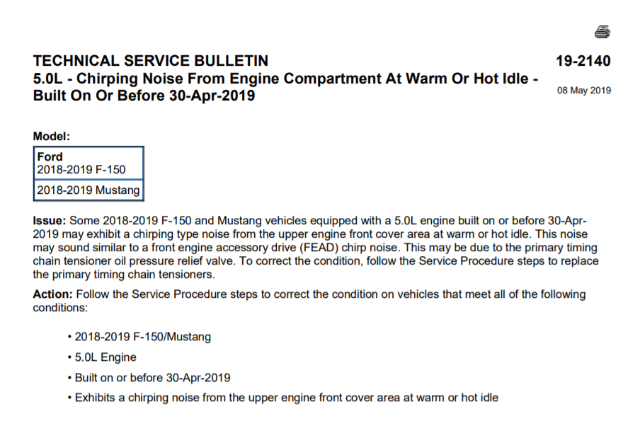

Ford just released a TSB. Its for your car. Up until April of 2019. Search it in Google. Its the tensioner on the timing chain. Its what it sounds like to me. Then again possibly poor audio for me or anyone to diagnose.

Do you have a TSB number? I can only seem to find them on the 3.5L Ecoboost (which my dad should probably read because it concerns him and his F150).

I found it on the NHTSA website and it is exactly what I have. The sound got louder on the center-rear portion of my engine cover and I can only really hear it when warmed. There's also a slight clicking sound which I haven't heard before associated with it (not the tick), but I'll have to see what that is.

Here is the bulletin if anyone else has a high-pitched sound coming from their mid engine compartment:
