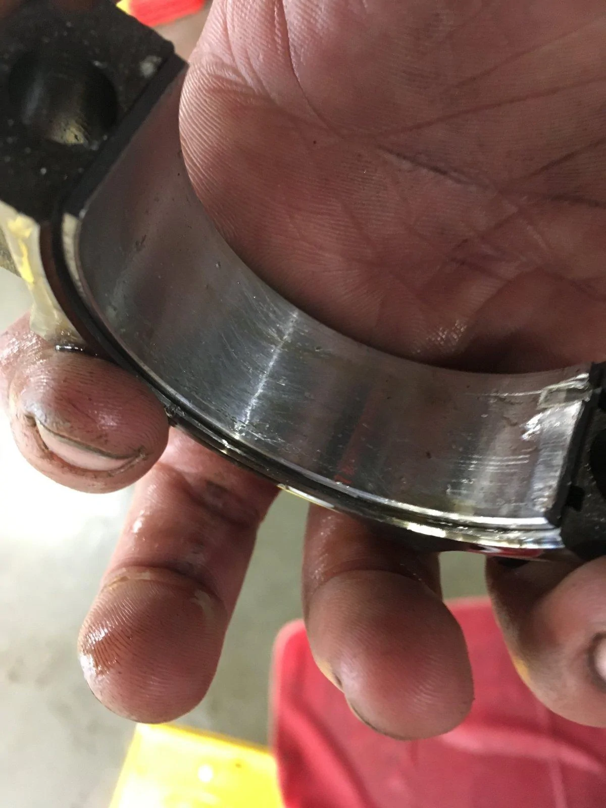

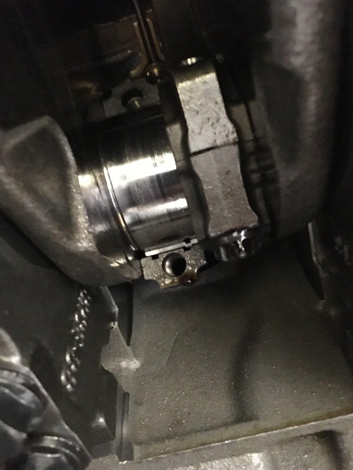

Just had my 2017 GT returned to Ford from me hearing the alleged "BBQ tick". Dealer subsequently determined to be a snapped rod. No loss of power or anything, just heard a weird tick. Options from Ford were to wait on a short block (on back order), Ford buy it back, or replacement Ford vehicle.
I love how people keep saying "There's nothing wrong", yet people still keep on experiencing different failures related to engine ticks.
BTW....bad seals DO NOT cause rods to snap. So I guess the "factual proof" just got disproved. :facepalm:

Snapped rod- wow, that sounds horrible. If they will buy it back that would be my option rather than wait for a block on back order. I read about the failures in the forums for both Camaros and Mustangs. They are not on every car but a few have had catastrophic failure of the engine, transmission, rear end, etc. I experienced major problems with my Camaro so I sure hope my Mustang is a good one. It really is the luck of the draw on your particular car......
I just finished up the RAV process with Ford. I now have an 18 GT. The day I turned my 17 over to Ford and I had to retrieve something from the car, a crate with my name on it and all the parts required to fix it were sitting beside the car.
Did it just get disproved by one guy posting a picture of a broken rod on the interwebs??? Over dramatic much? What exactly is the percentage of failures in the coyote compared to other mass produced cars? That would be factual proof that there is a problem relative to the rest of the industry. :headbang: A single post on a forum. Doesn't exactly provide factual proof that theses engines are failing at a greater rate than any other manufacture on the planet. That also experience failures.

Did it just get disproved by one guy posting a picture of a broken rod on the interwebs??? Over dramatic much? What exactly is the percentage of failures in the coyote compared to other mass produced cars? That would be factual proof that there is a problem relative to the rest of the industry. :headbang:Not a post on a forum.
Allow me to clarify:
There have been multiple failures, with multiple causes, when it comes to the '18 GT's. Then you get a guy who says, "Factually these have been solved by bad valve seals". Who "factually" said that? Because I haven't seen it, and I HAVE seen a lot of issues that would not be caused by bad valve seals. A snapped rod being one of them.
Nobody but Ford knows the actual percentage of failures on the Coyote...and you KNOW they are NEVER going to release that figure. So you ask an impossible question on that one.
Do I know what the problem is? No. And I don't claim to. But I do know that bad valve seals do NOT cause snapped rods, piston wall scoring, etc. There is something more going on here. If you don't want to acknowledge that and want to see everyone with issues as "whiners" and stick your head in the sand and tell yourself "there's nothing wrong, there's nothing wrong" then be my guest.
