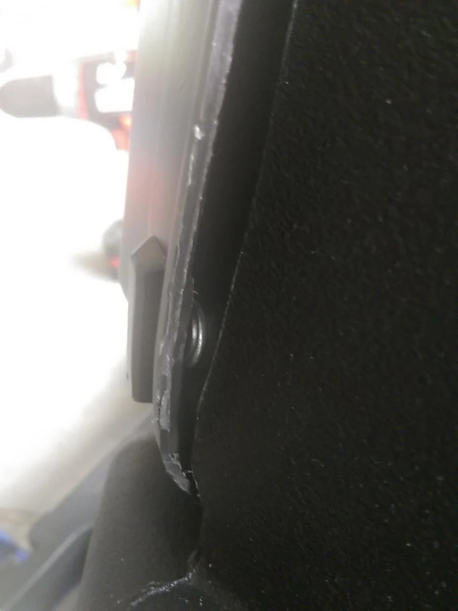

Attempting to install the cai and getting a little frustrated, I'm attempting to get the factory cold air feed duct to "snap" into place and all it does is pop right back off if I even look at it funny, let alone attempt to get the airbox into the car.

Looks like the washer and push pin are too low in the mounting location to make it over the lip on the factory stock air duct
Give us a call tomorrow and one of our techs will be able to assist over the phone. We've installed this CAI in and out of the car hundreds of times without issue: 954-960-0774

I trimmed part of the lip off the factory extension, on the end that hooks up to the new box. I also plugged in the extension first, by itself, back onto the bumper/grille portion. I then droped the box in and plugged it all together, still doesnt line up 100% but is secured where it should be.
I used brute force and a rubber mallet to get it on! :paddle:
Seriously though it was a bit tough to get the factory air duct onto the air box.
