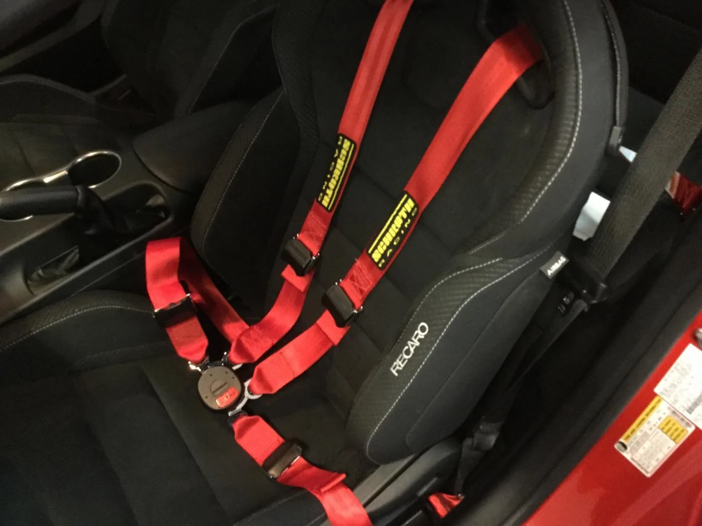

This is what I have. It also is designed to work with their HANS device. Worked great on my last track day.
https://www.hmsmotorsport.com/products/shr-flex
