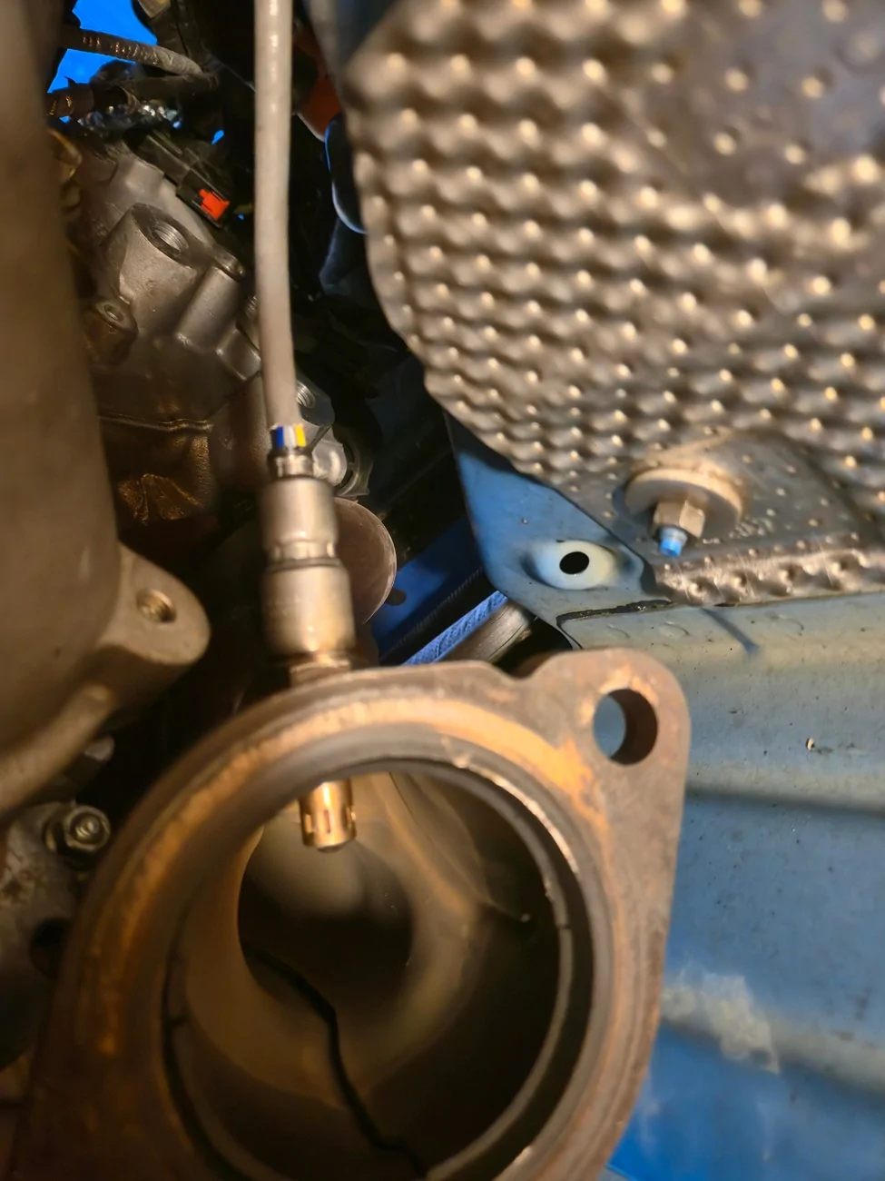

Seemed to be seized in place. What your tricks ?
So far I heated them up and hit em with some deep creep
to soak overnight.
Also, the passenger side looks like a bitch to get too. Can
it be done without removing the factory header ? Thanks !

Try an O2 socket and impact?
Heating up the bung should have have broke it free
Use a touch of antiseize next time!

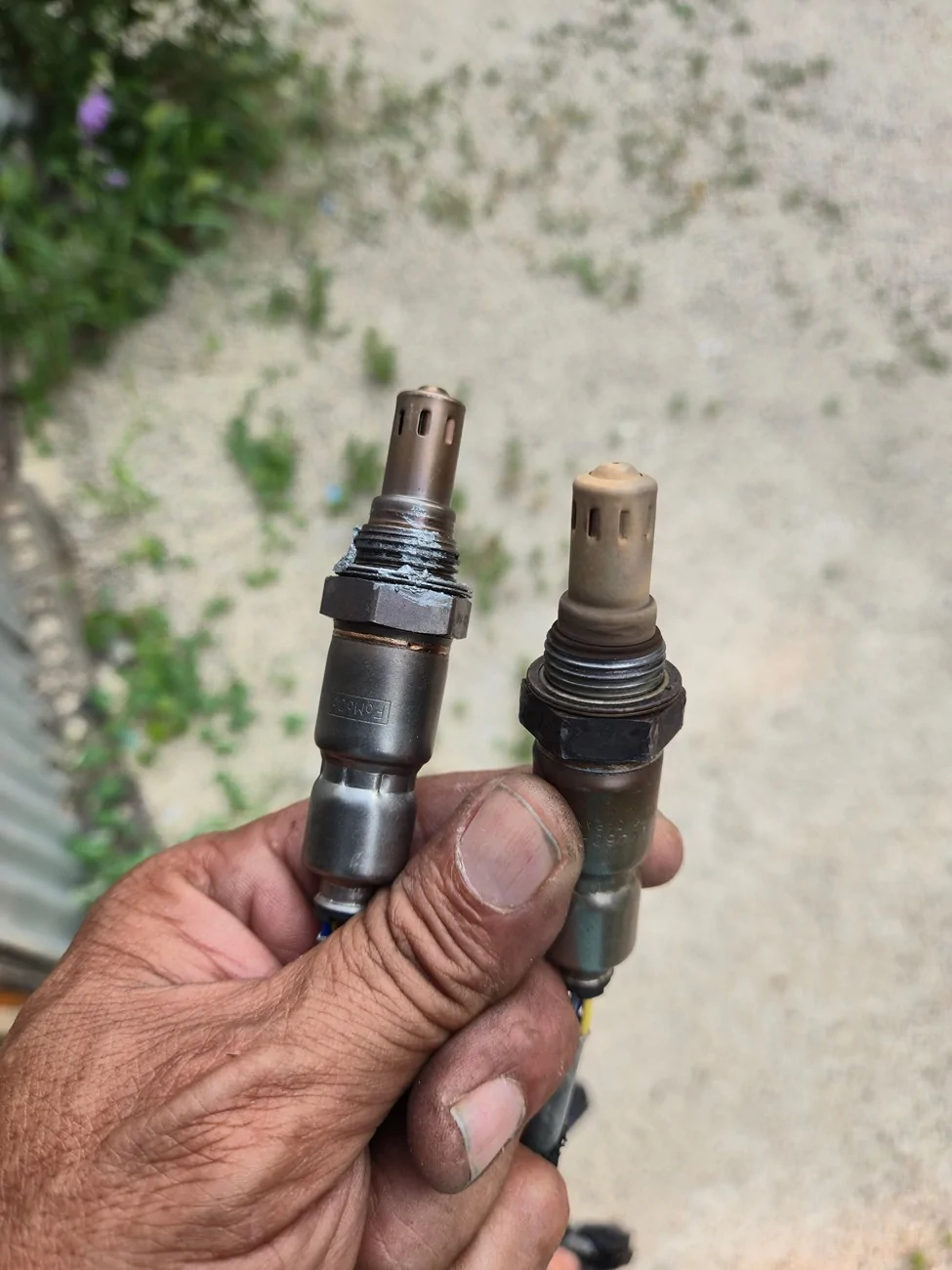

Noway im getting an impact on it lol.
There the originals.

Cut the wires off right at the sensor, then use a deep socket and a long ratchet or breaker bar to work it back and forth while spraying PB Blaster/penetrating oil into the threads as you move it. If you can't get a socket over it, at least this will allow you to get the closed end of a wrench on it.

Balls was that hard to get out ... old one smells like horsepower and regret.
One down, one to go.

They're easier to get out if you cut the cats off first... Lol

Smells like horsepower and bad decisions.
Passenger side was an absolute gunt to do. But all done now.
Now STFT show almost instantly on start-up.
