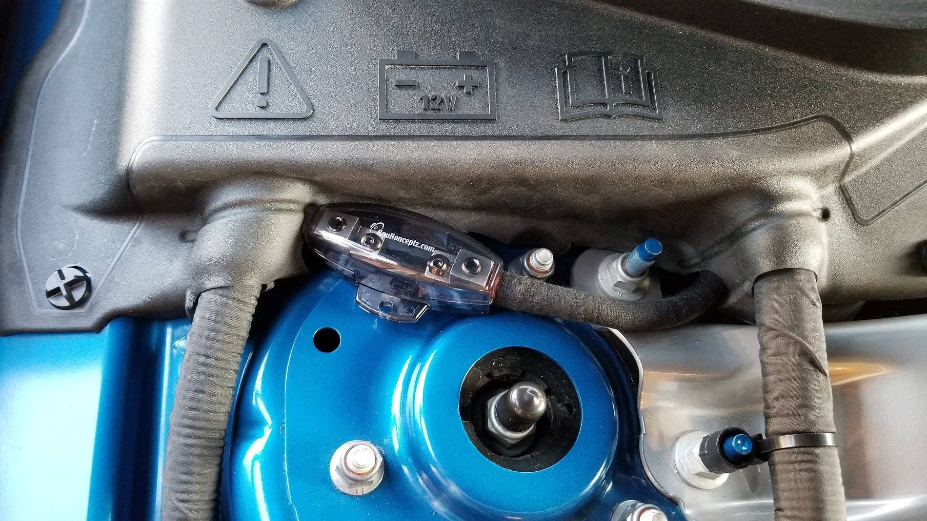

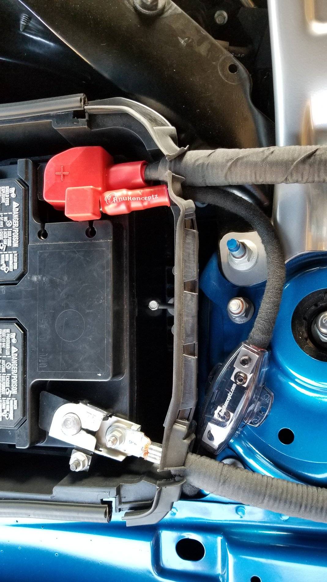

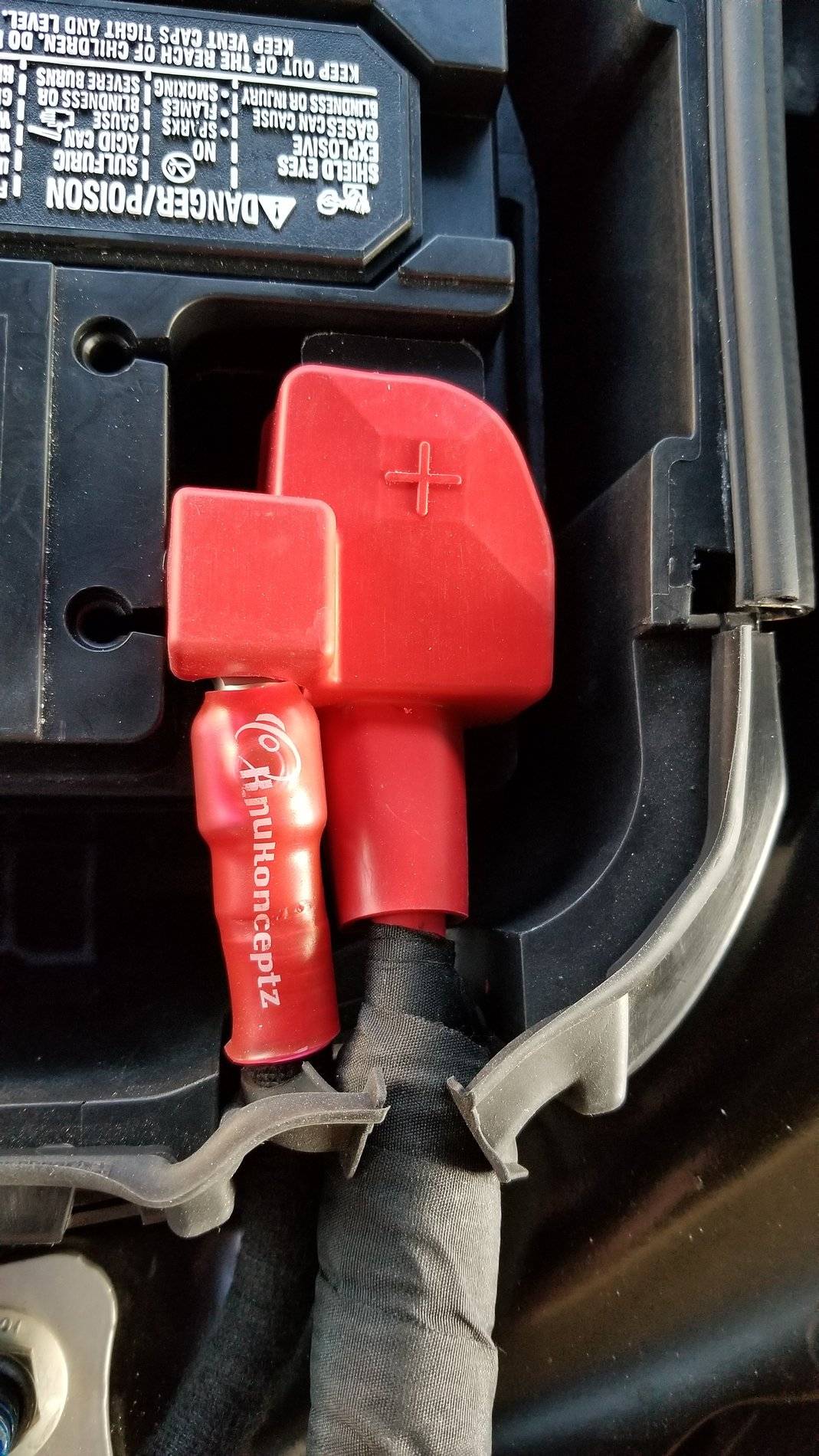

I sanded smooth the clamp parts removing the black coating on the mating surfaces to get good surface contact and bolted the terminal down with the top nut. Turned out ok and I didn't need to throw more money at it. Trimmed the battery cover a bit to clear the new wires and it's ready to install the fuse. Next is to create mounting surface on top of the strut tower to provide a firm attachment point for the fuse holder.
This shows how I ran the power wire going to the trunk around the left side of the battery box.

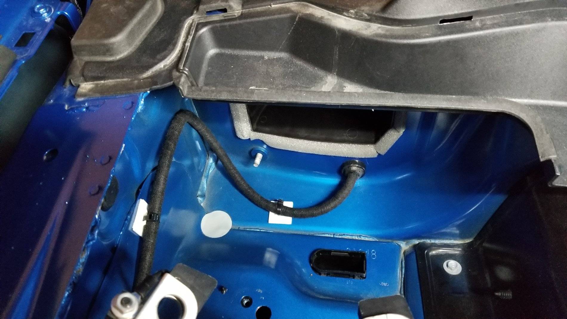

Drilled a hole using a step drill just below the cabin air intake. This is the perfect spot as it puts the wire in a very accessible location just above the passenger carpet. A PCV valve grommet sealed the hole and protects the wire. Some Butyl rubber around the wire to prevent water getting in. Also drooped the wire downward before going through the firewall so any water that gets on it would have to run uphill to get to the grommet.
