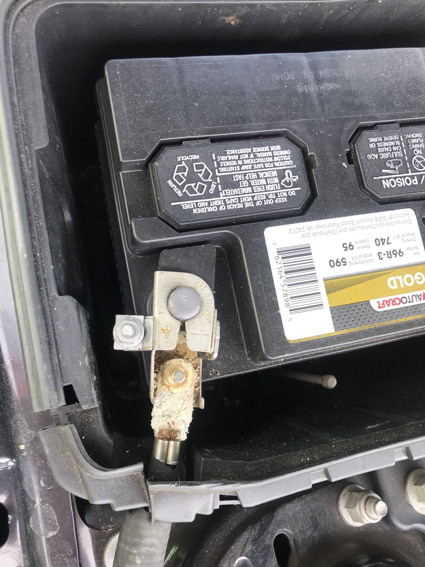

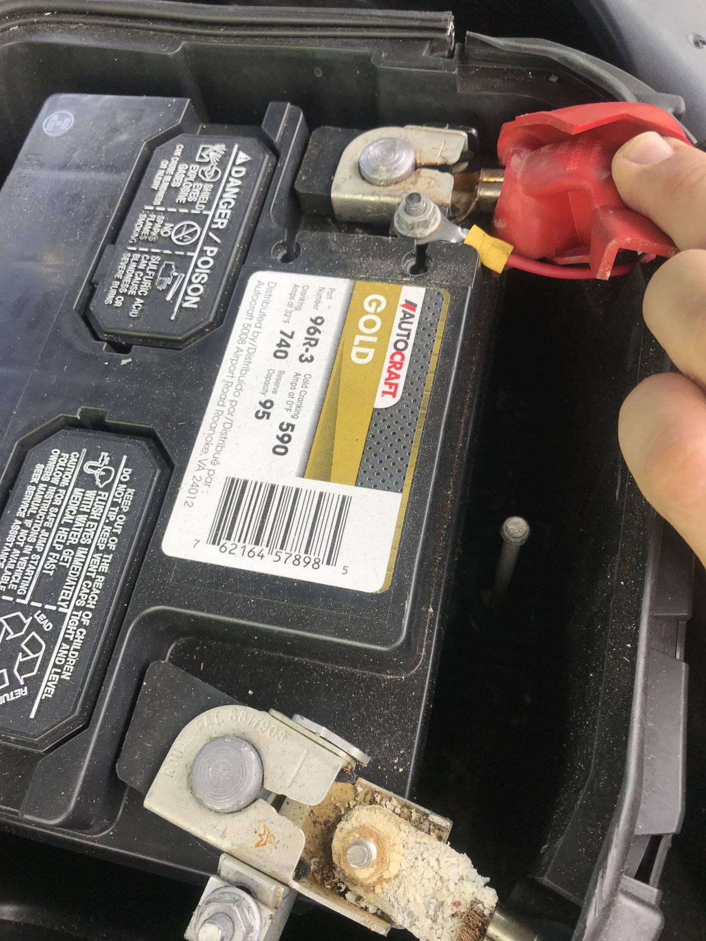

I think it’s just a common problem with Ford Mustang. I bought a 2015 V6 last year and was surprised how corroded the negative terminal was. I bought a new replacement post connector and thought that would solve the issue. To make a long story short. Had to buy a Advance Auto battery when mine went dead and the same thing started happening to the negative terminal on the new battery. Brought my car in to dealer 3 months later because the AC fan stopped working and they said my battery is showing low voltage and they needed to replace it with OEM battery to do a complete diagnostic check. AC fixed and 3 more months later with OEM battery and it’s starting to corrode again. Here is a picture of the Advance Auto battery

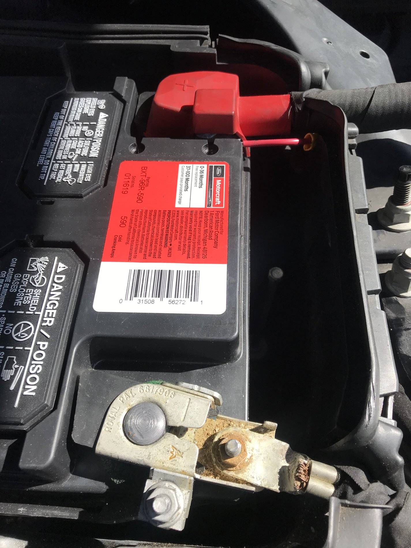

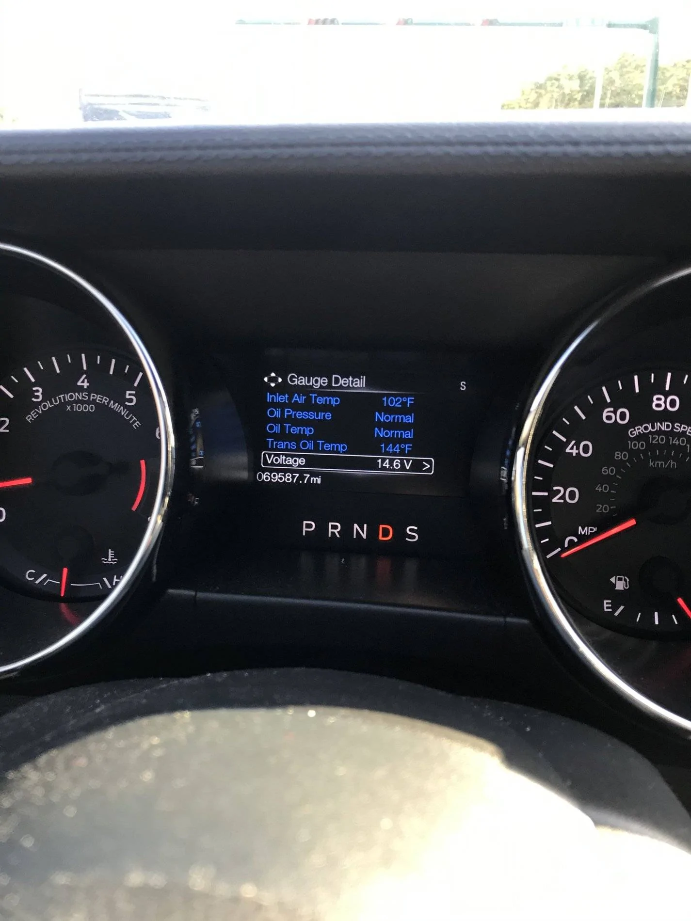

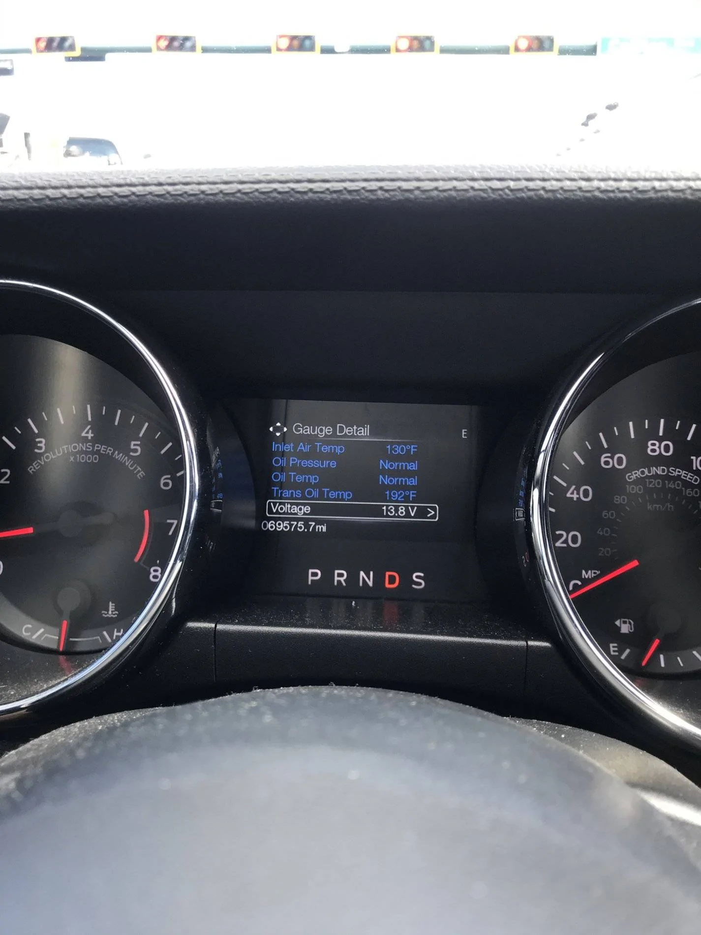

You need to grease your terminals !
So today I took the negative battery connectors and cleaned them. The new Ford battery had begun to corrode like last 2 batteries. I also disconnected the factory grounding points and cleaned it up. I then applied dialectical grease on all the connectors and bolted everything back the way it was. My voltage display went from the highest reading of 13.8 before and now 14.6 after. I guess in 3 months I will have to come back and give an update.
