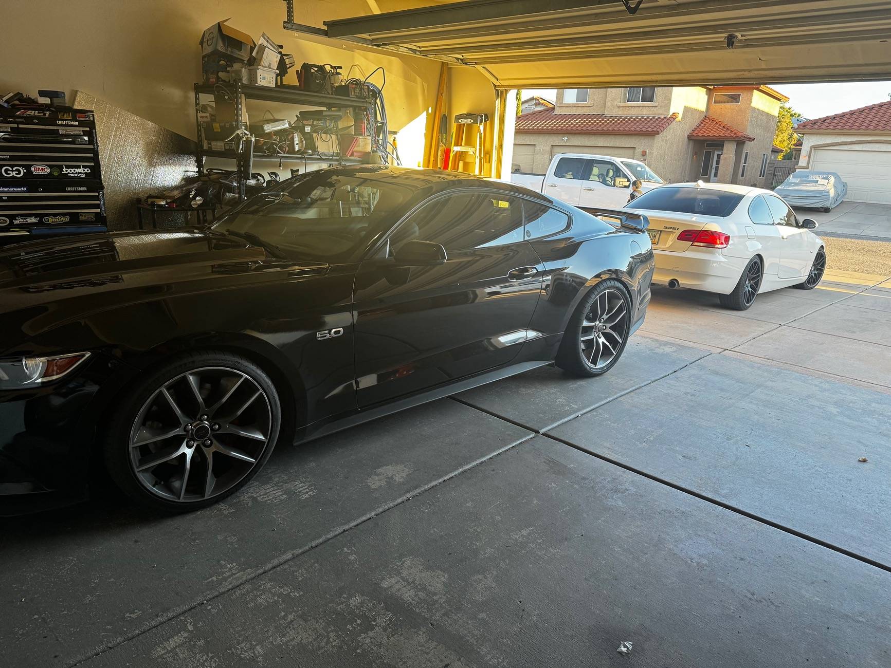

Thinking to do 20mm spacers rear only however

Only doing rear as I live the stance a bit better.
So in the past I have done 25mm spacers and they worked fine. But for it was just a smidge to much. Then tryed switching to 15mm. They didn't fit (studs contacted wheel hub) I should have known that but I brain farted. At that point I said fk it and left it alone.
But now wanna try again with 20mm🤣 what things can I do to ensure the studs won't contact the wheel hub.
Measures stud, minus spacer thickness?
It might be super simple but I rarely mess about with spacers ect.

Which wheels do you have? I had a thread earlier this month about 20mm spacers in the rears which you posted in. It did not fit my PP1 wheels in the rear as it left a 5mm gap 😭. I'm pretty sure 25mm is the smallest bolt-on spacer you can use on the OEM 9.5 inch PP1 wheel.

On my GT I have some aftermarket wheels that I'm actually trying to find the specs on now. This is probably also the reason I felt the 25mm stuck then out just a touch to far as opposed to my previous mustang with PP 25mm made it perfectly flush.🤔

My wheels are 19 8.5 with a 30mm offset with 5.932 Inch, 150.7mm back spacing

Pretty sure 255/40 R19 havent looked in awhile but pretty sure that's it

Fk it. Just gonna put some 10" wheels on the rear and leave the front 8.5 with a 20mm spacer.
