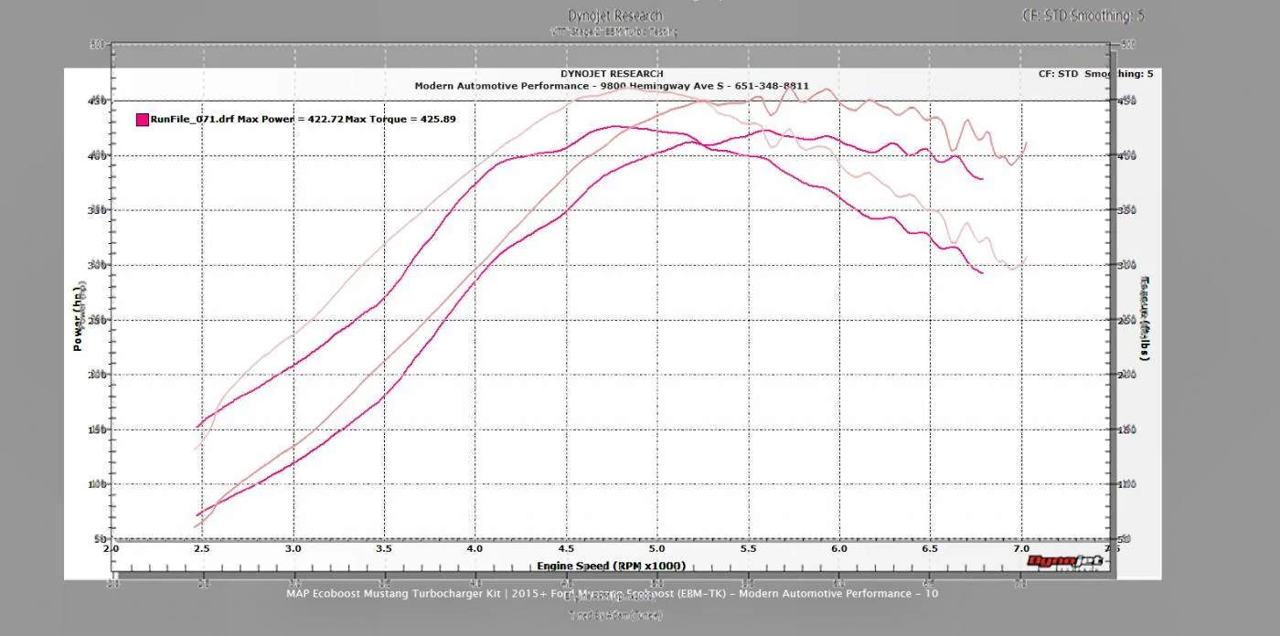

Contrary to popular believe ball bearing turbos usually do not spool much better than JB turbos. Ball Bearing units really shine in improved transient response. If looking for spool, and power data between our stage 2, and the MAP turbo upgrade. This was taken from the graph on the MAP website, our stage 2 is spooling faster, and making more power.
462/460 to 422/425
462/460 to 422/425
Of course it is going to make more power, your stage 2 doesn't flow that much less than the 5862 JB that is being used on that graph. Plus, that graph you used that was on E20 PUSHING it. If it was on 100% E85 MAP's kit with a 5862 will make almost 600whp without a problem, I made 570whp with a 5858 on 93oct+RGA.
From my ball bearing testing you are looking at an average of 300rpm spool difference. On a 6266JB vs 6266BB test I did on an 2.4L EVO it was about 500rpms difference between the two.

Our stage two has a better wheel combo than a 5862. In my opinion, PTE 55 or 58 series turbos are a complete waste of space in terms of flow, and spool. You can get a turbo that flows the same or better, and will out spool them. I never see any reason to run a PTE 55, or 58 series turbo, literally ever.
