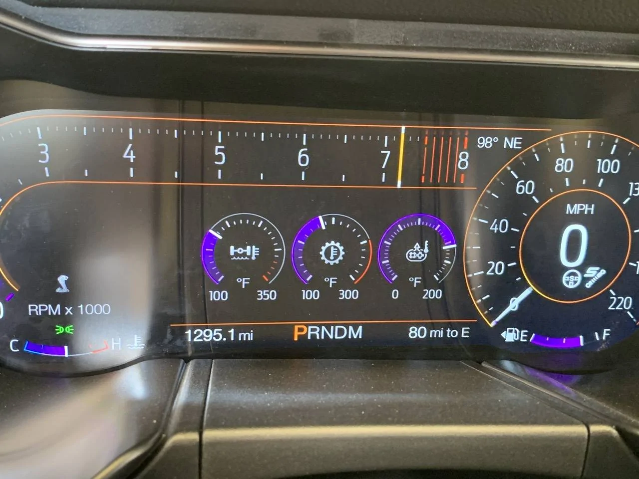

Handles great at COTA. No overheating problems, etc.
Here’s a pix of my temps from last summer when the ambient was 98*:

Awesome - thanks for the response. That is great you haven't had to do anything to the cooling to manage temps. Do not come across many oem setups that can handle much time on the track without some cool down laps. Sounds like the base would be the best choice for me as well with those straight forward add ons being availalble.

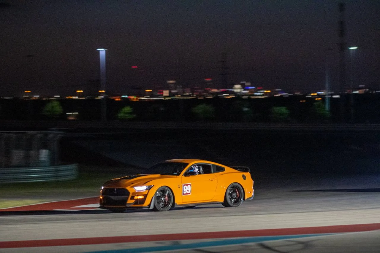

Here’s a little teaser of COTA at night with Austin in the background:

Nice shot - been wanting some good night shots on the track - certainly the standard glowing rotors included.
