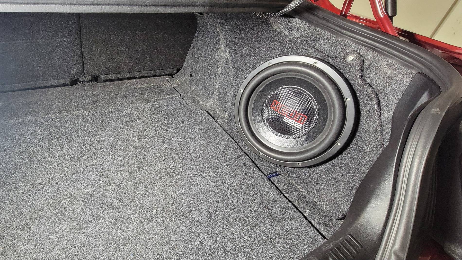

Just picked up the skar 12 unloaded box for my 12 inch SSA xcon subwoofer. I had to make a spacer to increase the mounting depth. I did a small mod by using a 6mm U Nut and a 6mm by 35mm bolt with lock nut and washer to secure it in place better. I have this setup powered by a kicker 1k watt amp. It pounds pretty good I'd say and look at the trunk space! I do have the skar audio speaker grill on order so I'll post a picture when that comes in. Just wanted to share and pass this along

I gave up on waiting for them to be in stock, it looks good!
How sturdy in the mounting system?

They are in stock now. And with my modification using a 6mm bolt and 6mm U Nut it holds the 35 pound subwoofer plus the 15 pound box in place & I've had the car sideways to test this out.
Now without the modification it will probably be okay with a lighter sub but the plastic push pin will probably come out if you drive aggressively at a track.

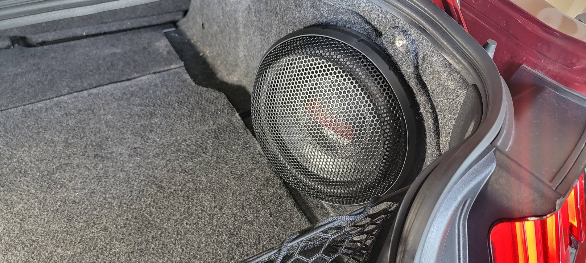

Here's an update with the skar subwoofer grill. It's very sturdy and give alot of room for the subwoofer to move. Now it's protected and I can fully use the trunk. Hope this helps someone
