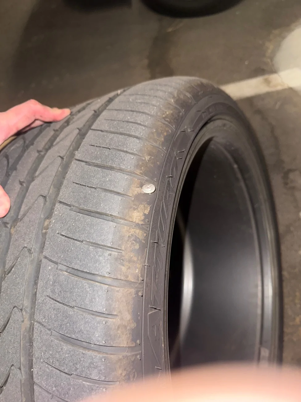

1 thing after another with this car man. I get in and bam, I have a flat. This is a 305/30r19 tire and I have a 17” donut from my brothers Mustang for the time being. Will I be ok driving in a donut for a day or two whilst I wait for this new tire to come? I swear my luck has just been awful lately.

I would Stab a plug in there and drive it for a day or 2 if it doesn't leak........And then probably longer if the cords don't separate.

I did plug it, but I have a spare on it now.

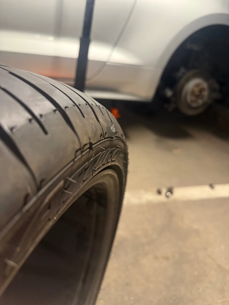

It has a little bulge.

With the nail in-between the tread and sidewall, I consider it toast. I would not use it, not attempt to repair it.
