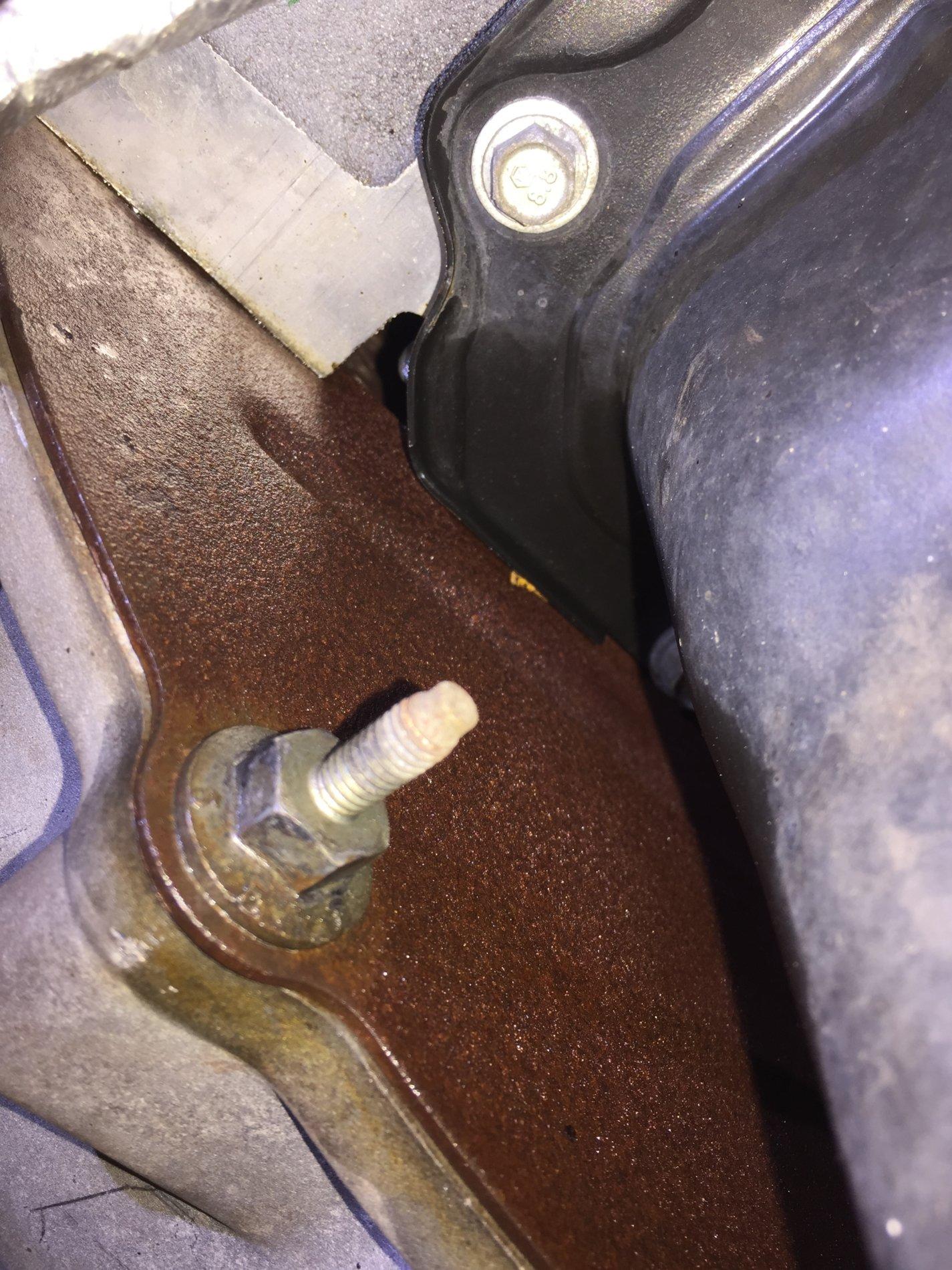

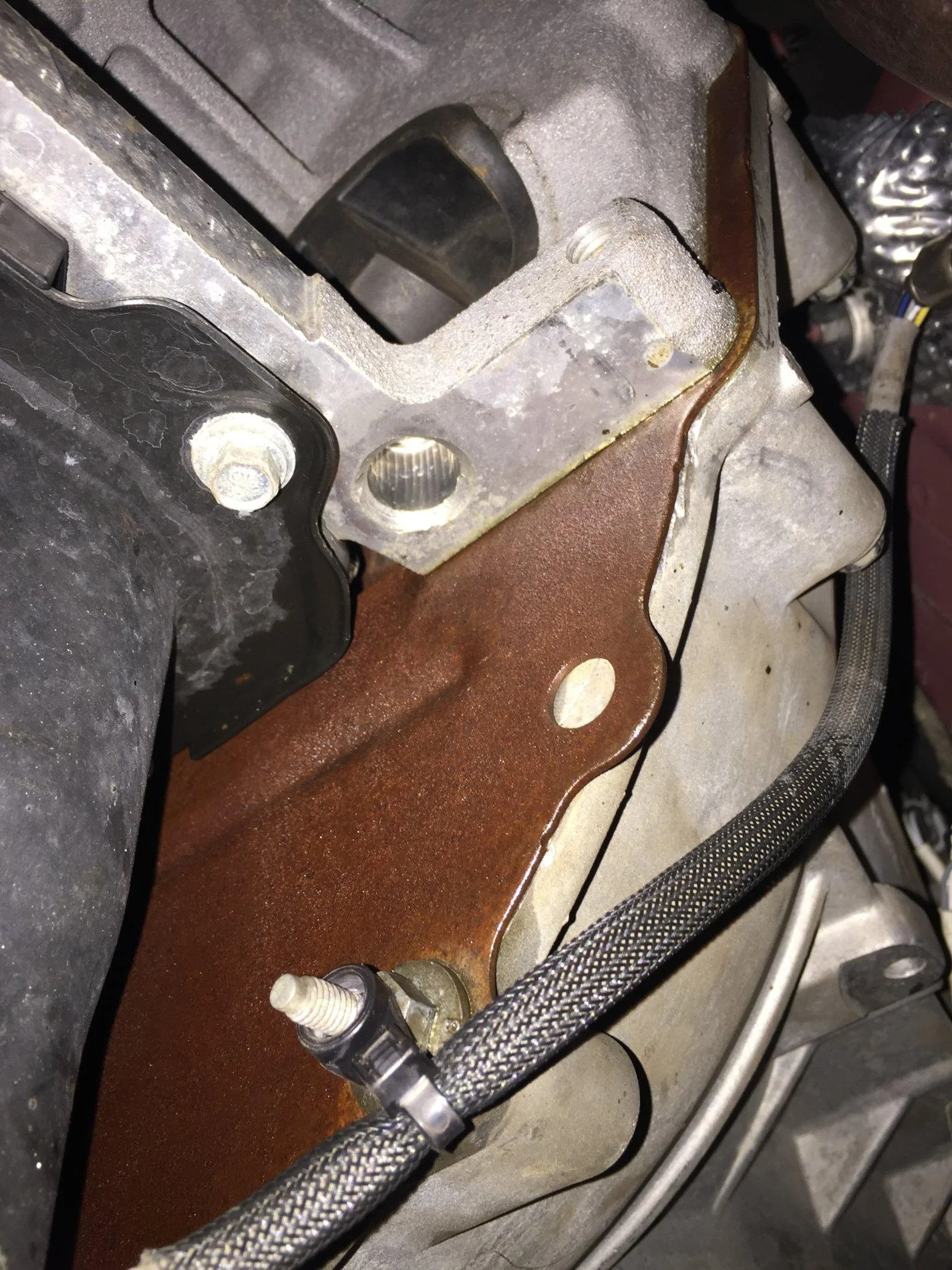

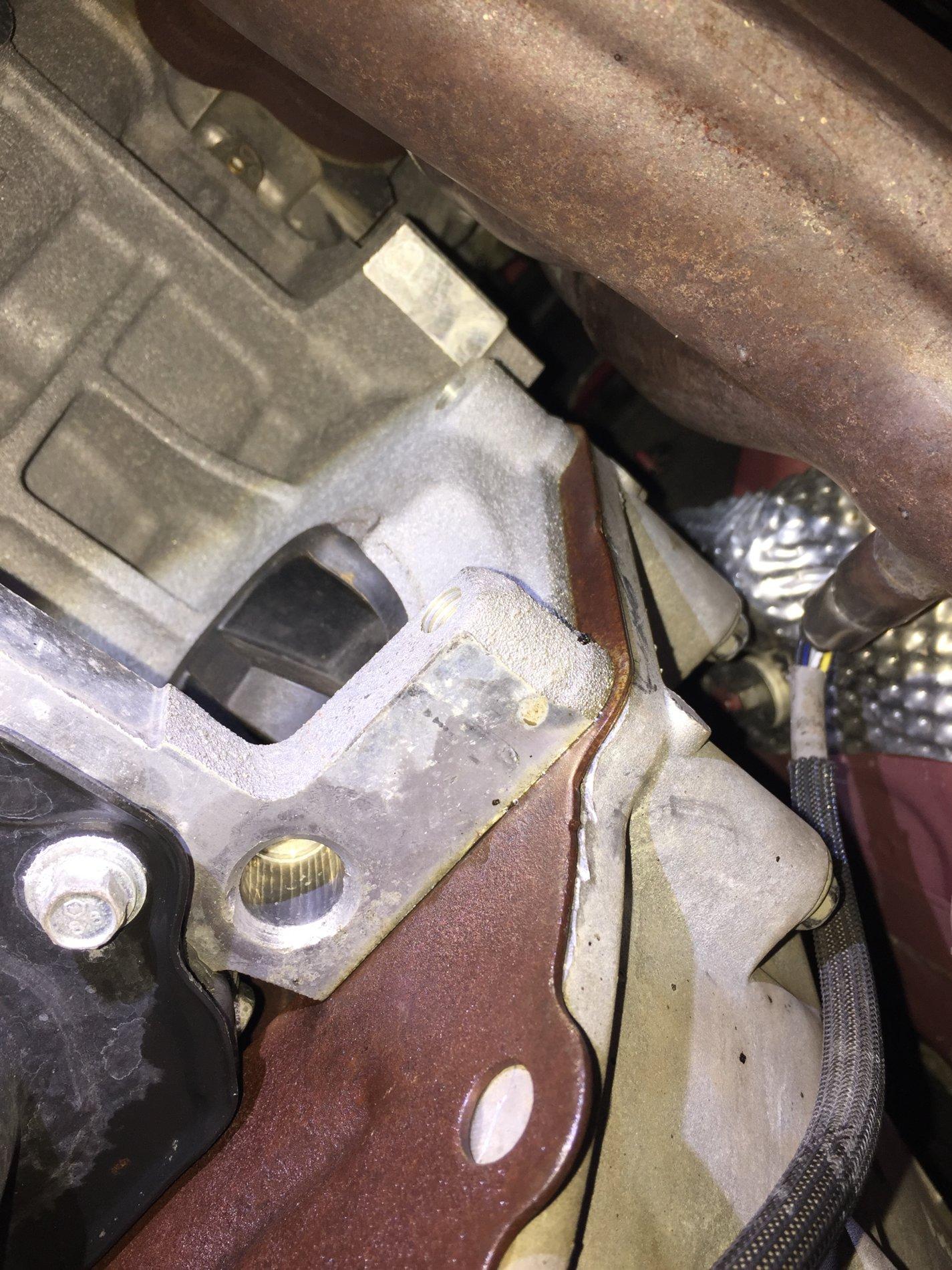

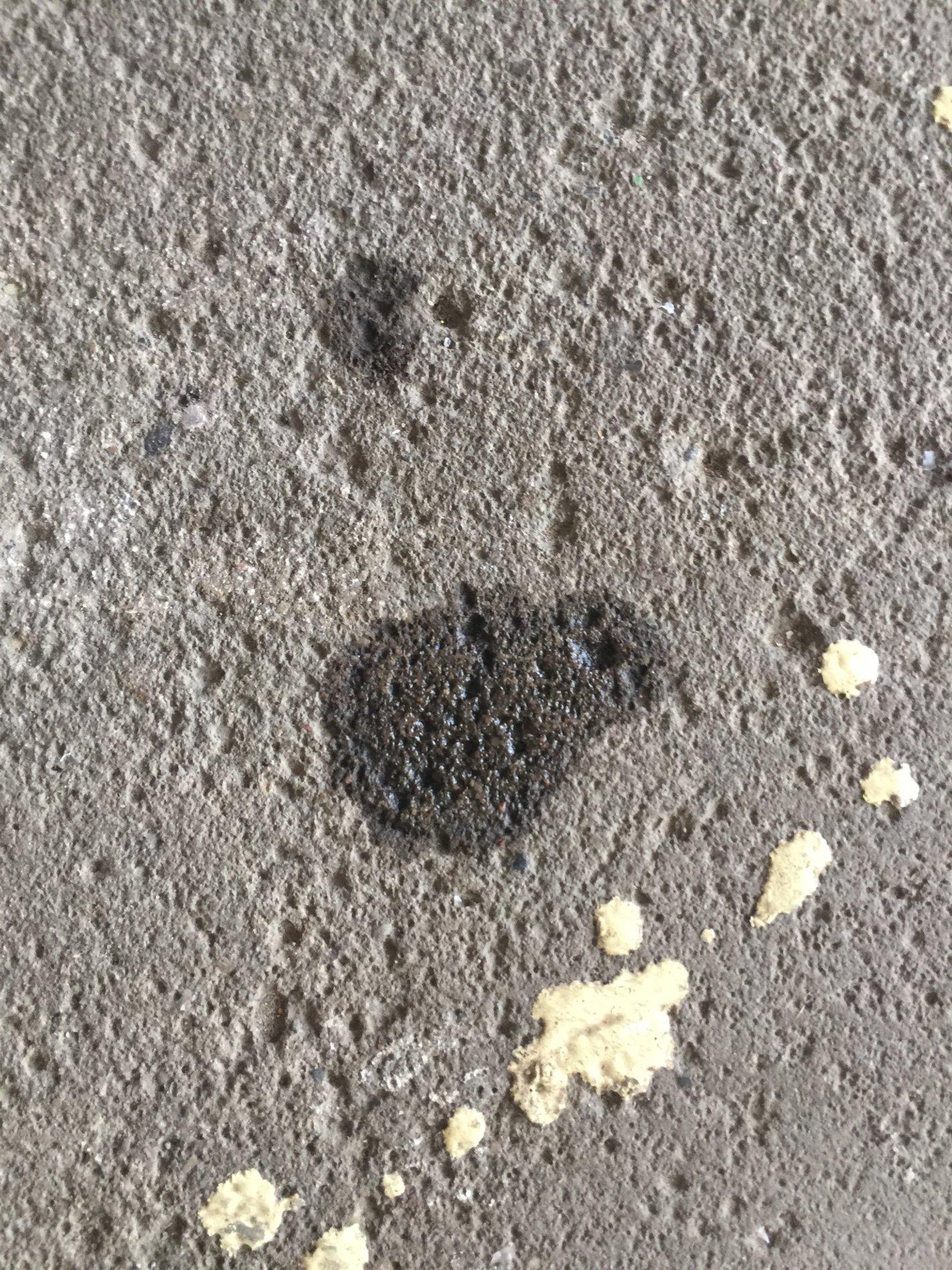

Finally got to 500 miles and started driving the car hard. Just yesterday I noticed a small puddle of oil in my garage...strange because the Mustang is the only car that's parked in there and it has been BONE DRY underneath since day 1. I've never had any oil leaks, at least none that I am aware of or resulted in any visible signs. Oil consumption is nearly non-existent as well (down to 1/4 of a quart ever 5k with lots of high RPM use).
I also noticed that the shifter play seems to have grown and become excessive (although I'm not missing gates and it is shifting smoothly). I can move it nearly 1/2" left or right without getting any resistance from the internal springs. That didn't seem right either. So I put it up on stands and what would you know, the whole spacer plate that goes between the bell housing and block is soaked in oil...there's oil collecting in drops at the bottom of the bell housing.

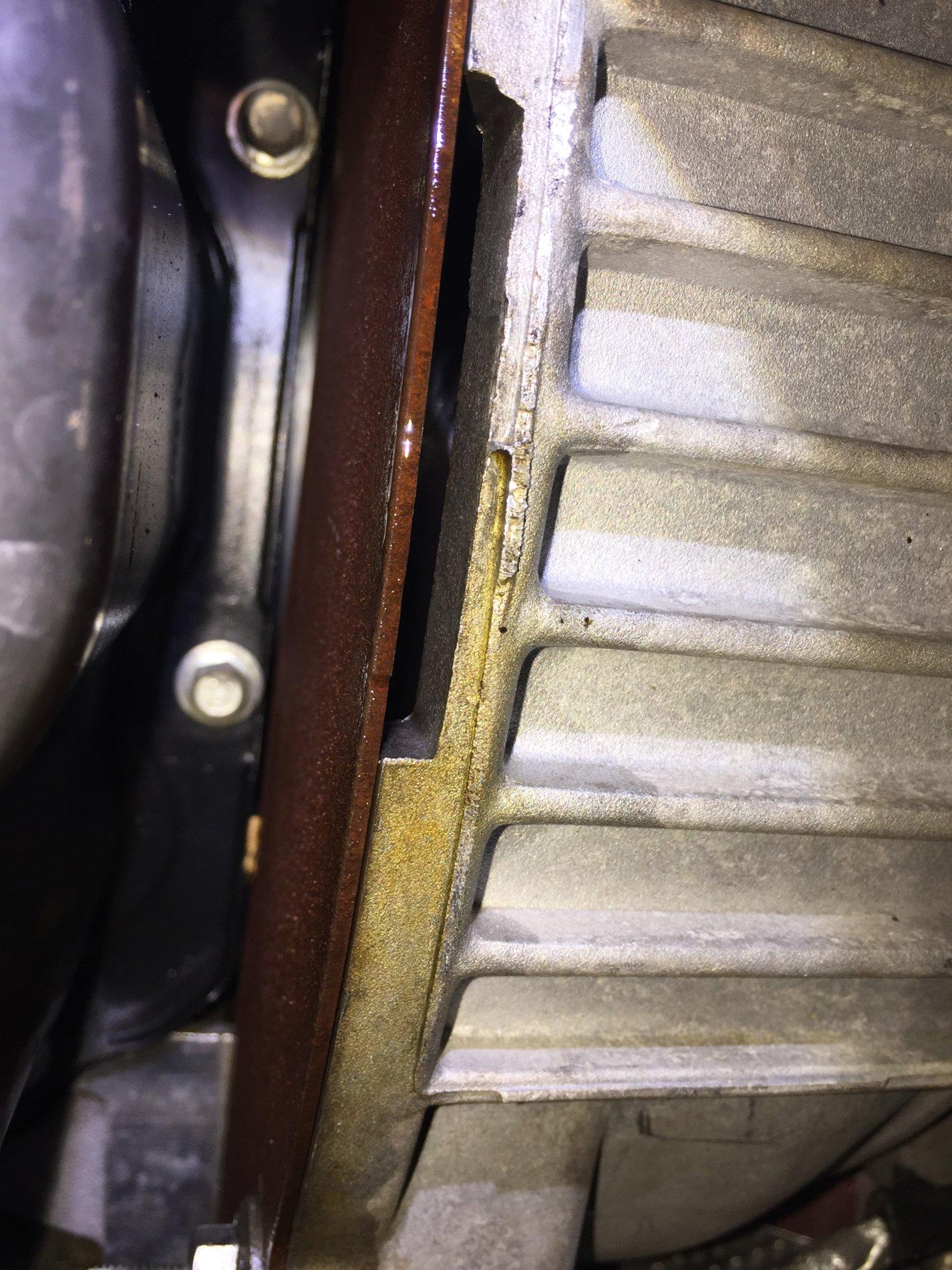

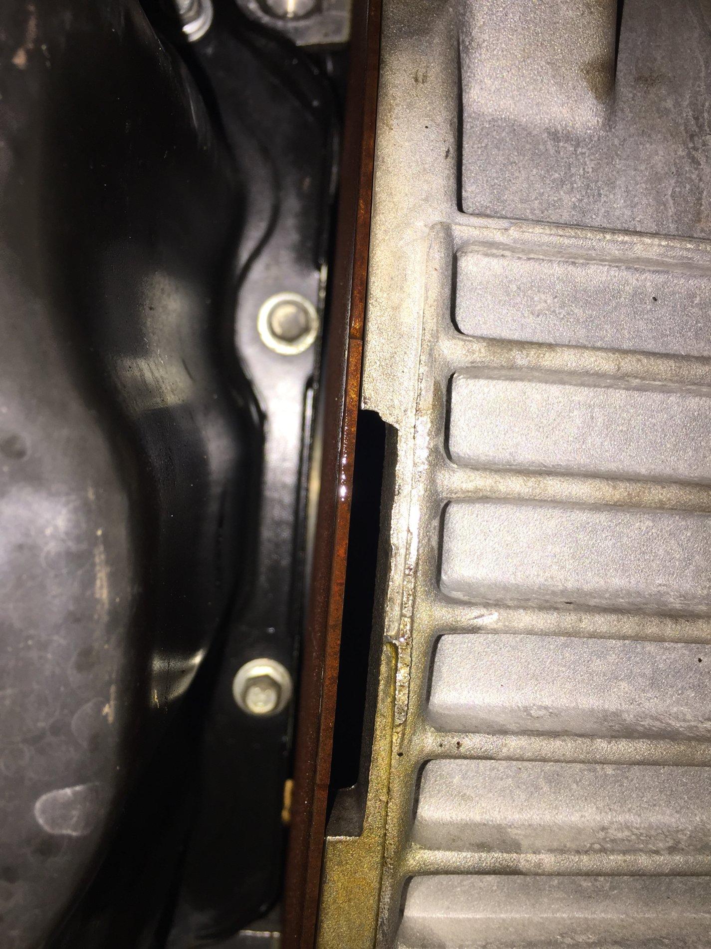

I checked the filter which was completely dry, I checked around the pan an the only part of the pan that has oil residue is the edge right by where the bell housing is, dry everywhere else. But the oil goes all the way up the spacer plate (well above the pan) on both sides, it's not just one side which means it's not the pan leaking.
That means it's either 1. Hydraulic fluid (possibly new slave is leaking or the steeda line) 2. Main bearing seal on the crank or 3. the main shaft seal on the MT-82. So I bore scoped it and the slave looks bone dry. I see no oil residue on the clutch pack side. Then I stuck the bore scope up behind the flywheel and what would you know...there's oil residue.
That means it's highly likely that my main seal is now failing on the 5.0...1 week after I get it back from the dealer. So I've suffered a failed Mantic 9000 install, dealer sloppiness that broke multiple parts that were not broken before and now a failing main bearing seal...oh and they also broke twice the shifter boot assembly, the chrome trim piece around the shifter. 1st time they admitted it and replaced it. But they must have broke it again when the had to drop the trans a 3rd time to install a new OE clutch but tried to hide it by gluing it back together...yes they actually super glued that thing back together and it came apart while I was driving (all the tabs are broken).
Yah it's cosmetic piece that doesn't affect operation, but seriously? Gluing it back together instead of admitting it broke again and replacing it :headbang:. Ironically the car is still under it's 100k extended power train warranty...yet none of the clutch issues are covered of course because it's a "wear item".
So now my GT is back at the dealer waiting for a diagnosis on the leaking fluids (most likely main seal), still working with Mantic on a refund of 1550 for their 9000 who also is saying they "cant find anything wrong with it and is pointing fingers at the dealer which I'm half tempted to believe", I'm screwed out of $850 of labor for the attempt to install the 900 and I just paid $1,250 for labor for the 3rd install and the new OE clutch.
